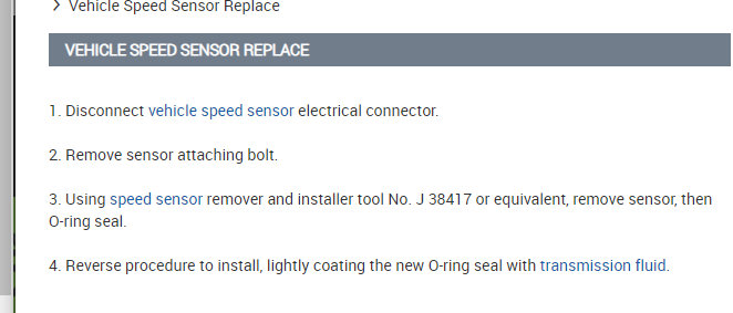

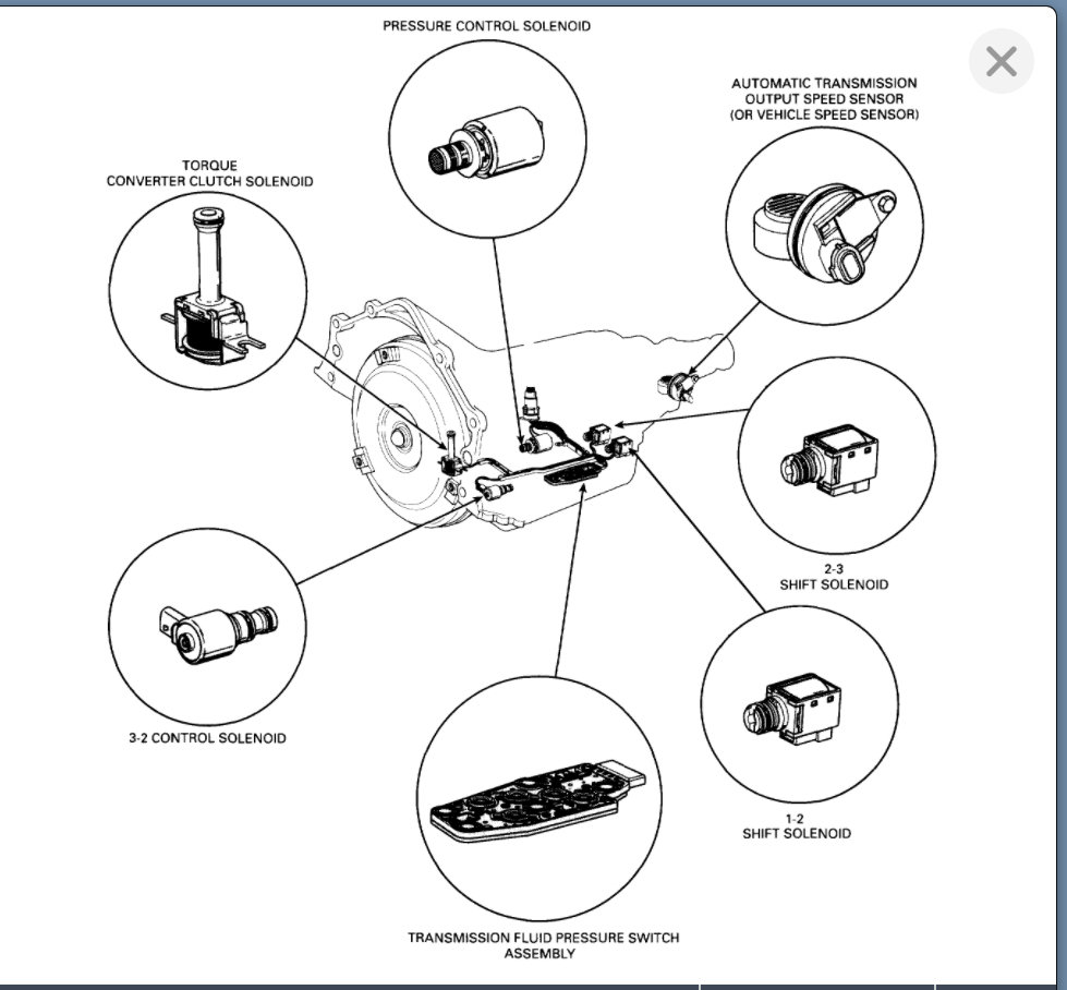

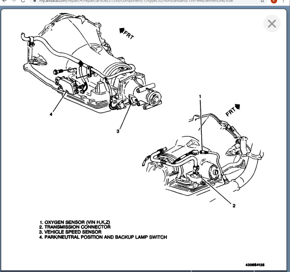

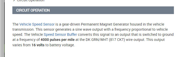

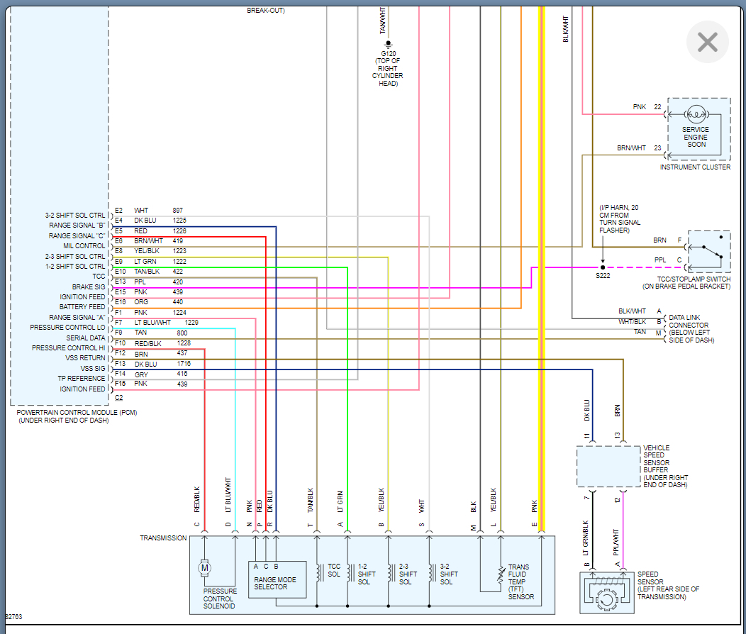

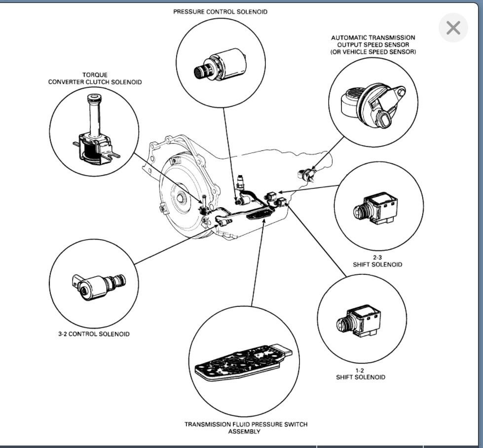

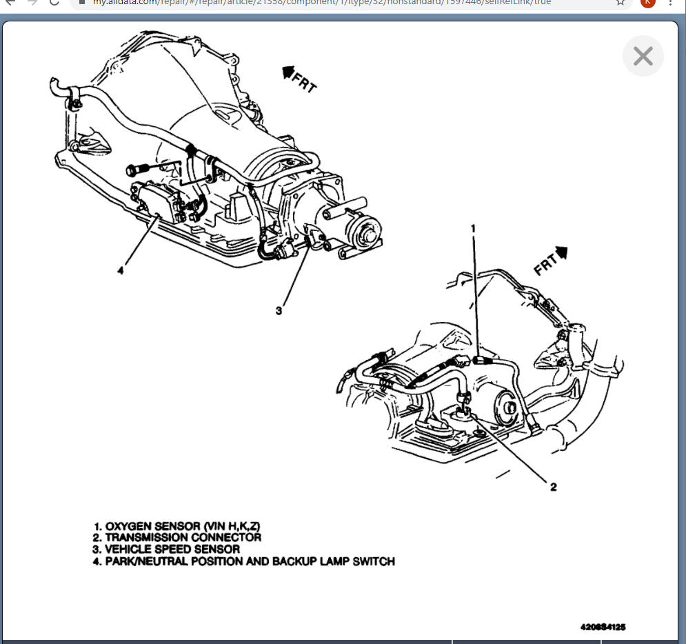

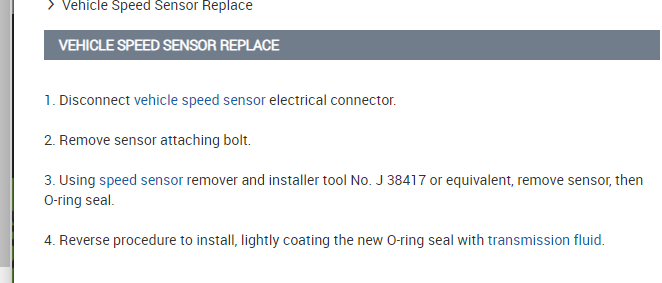

You are correct that this is normally a vehicle speed sensor so I went ahead and attached that info below as others in the future may have this issue and they need to start with that just like you did.
However, if you changed it and it still is acting up then we need to do a couple things.

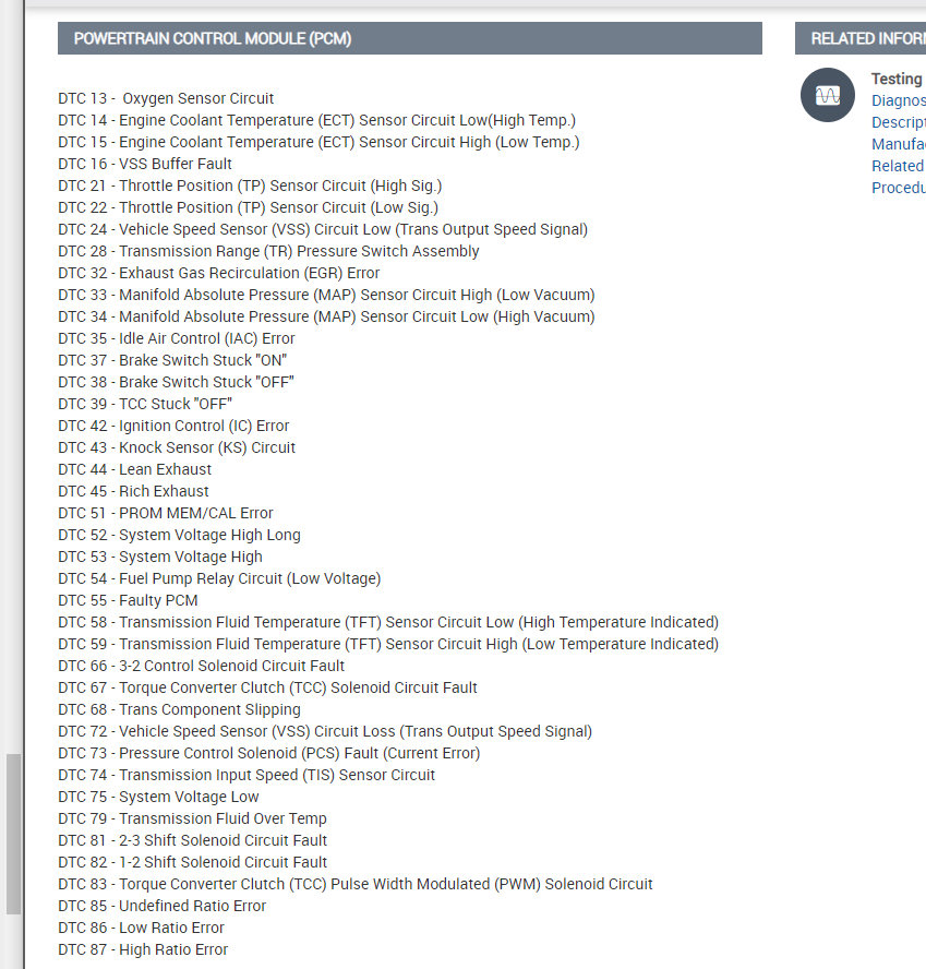

First and foremost, we need to check for codes. While I don't expect any we may be pleasantly surprised.
https://www.2carpros.com/articles/buick-cadillac-chevy-gmc-oldsmobile-pontiac-gm-1983-1995-obd1-code-definitions-and-retrieval-method

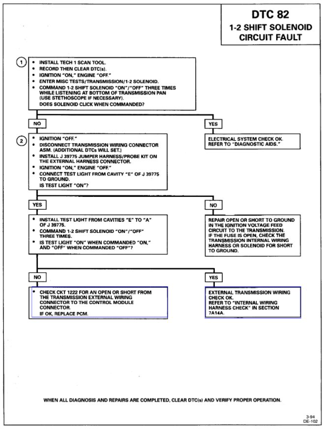

If there are no codes then we need to investigate this fuse further.

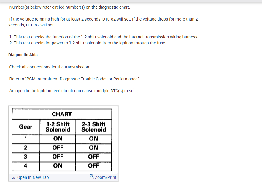

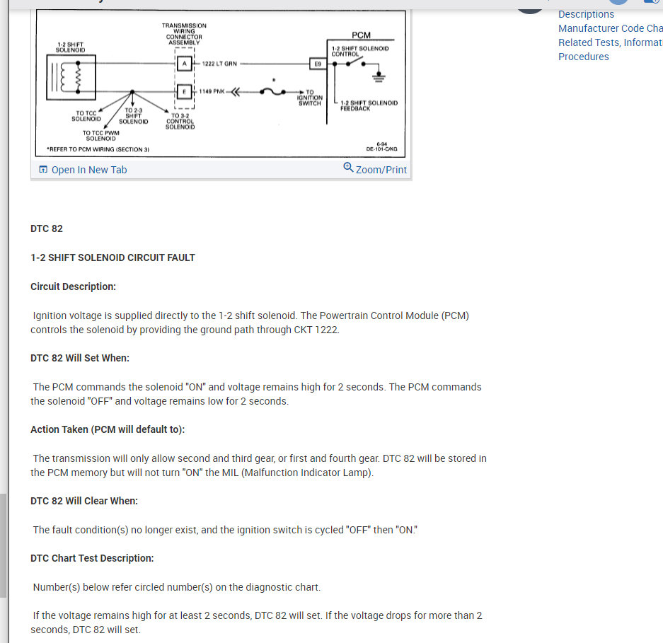

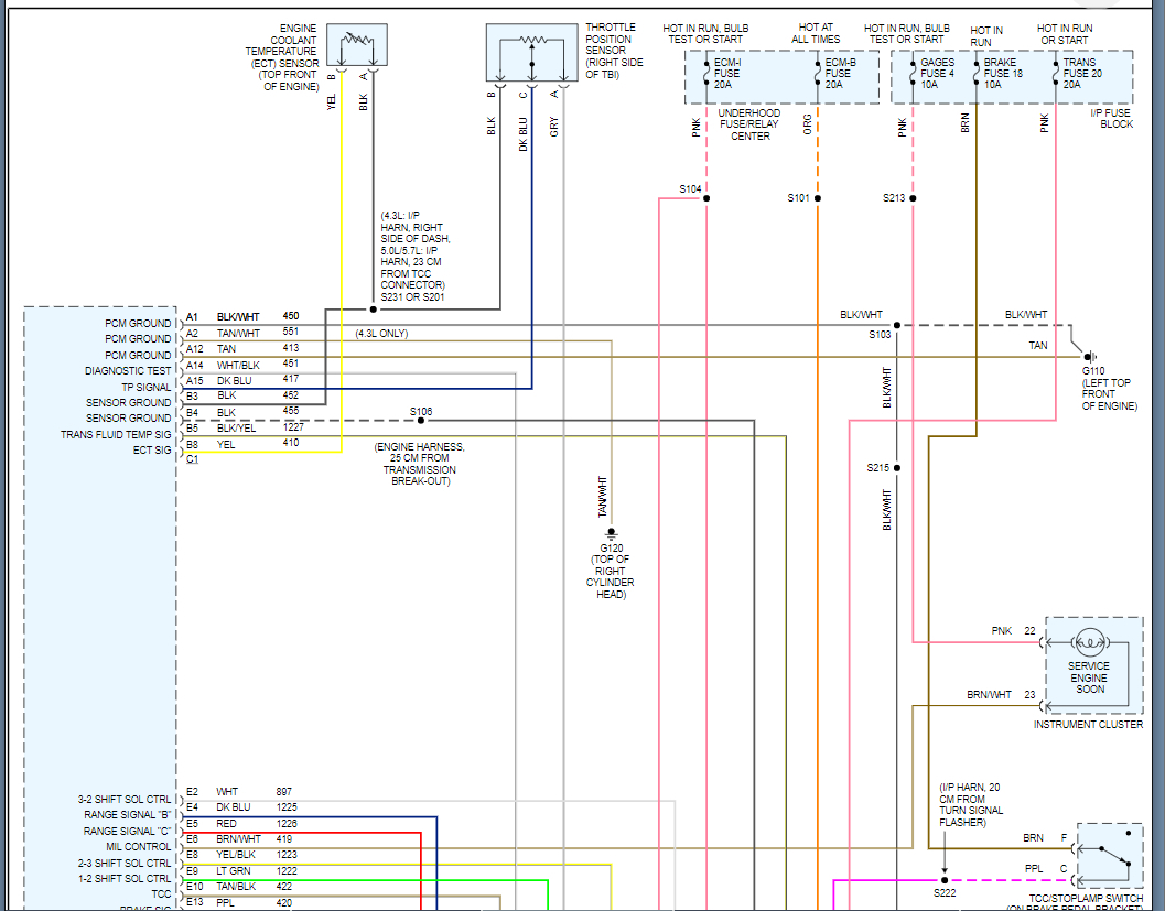

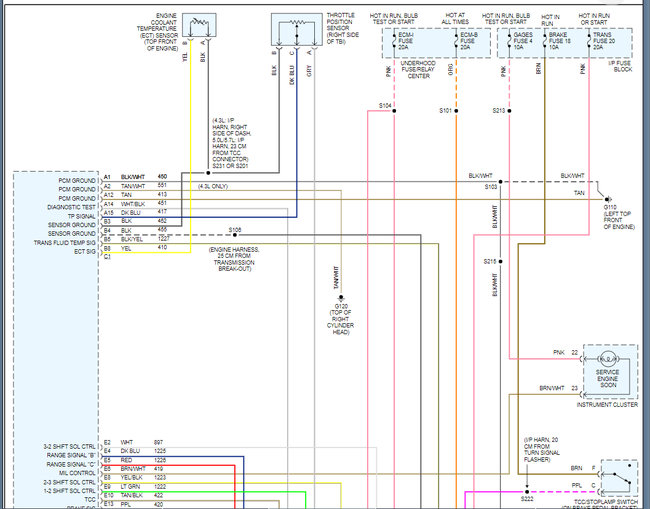

I attached the wiring diagrams below as well and they show that this fuse is a 20A fuse. So when you say you have no power, do you have power on the front side of it and not on the other or no power on either side?
If you have it on one side then the fuse is blown. If you don't have it on either side then we have an issue on the fuse panel circuit board. However, that will cause a shifting issue as this fuse powers the shift solenoids.
Please run through this material and let us know if this is in fact the case. If it is then maybe we jump 12 volts to this circuit and see if all issues are resolved. Then we can just figure out why you don't have voltage there as we know that will solve the issues.
