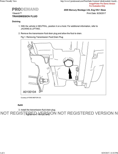

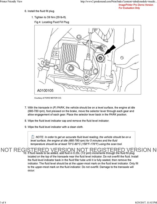

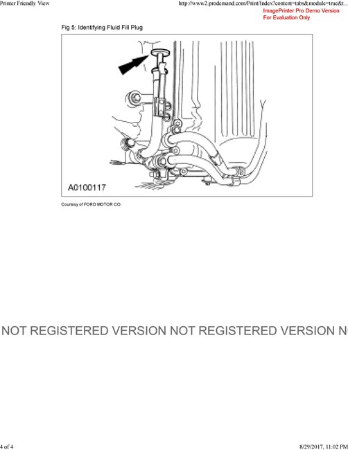

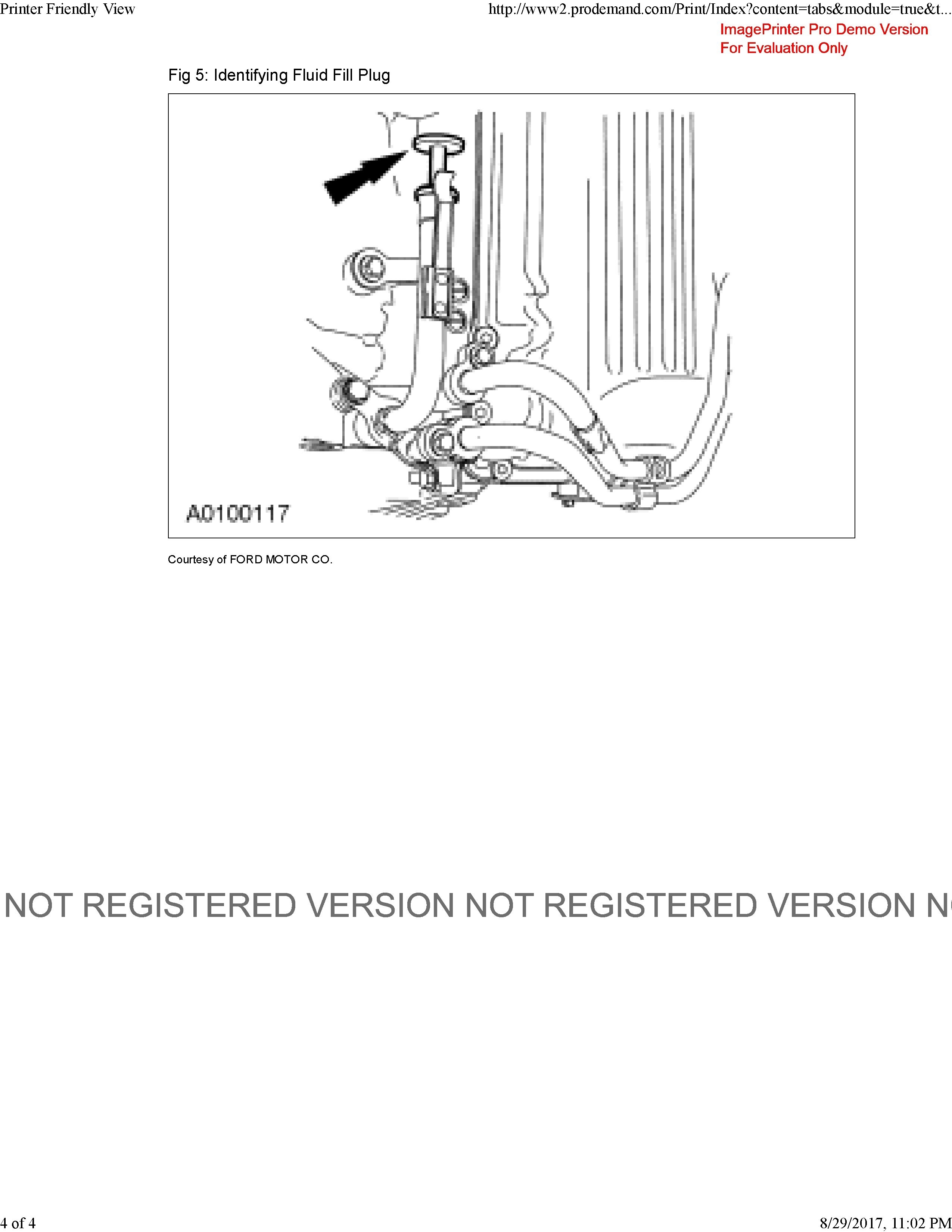

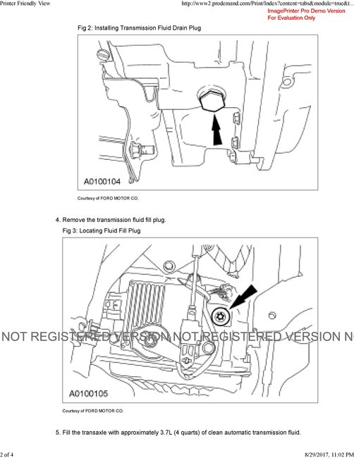

It is a traditional automatic transmission. Attached are instructions on how to service it. The filter is inside the transmission, and not accessible.
