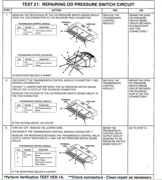

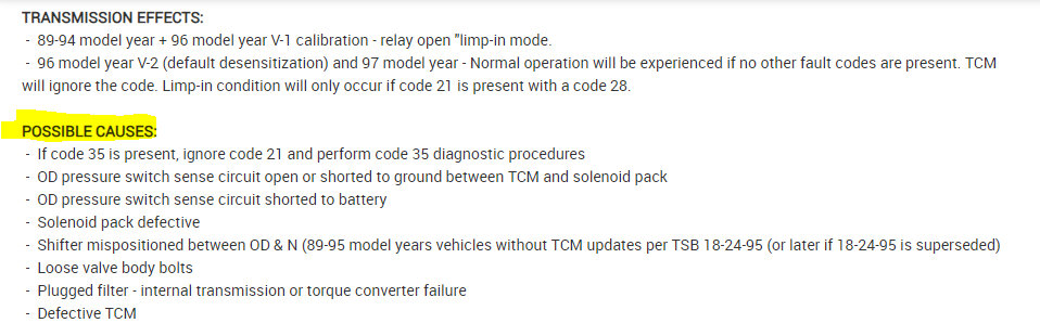

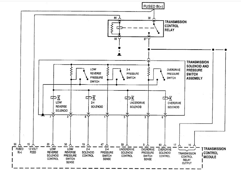

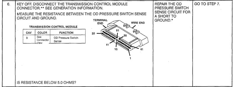

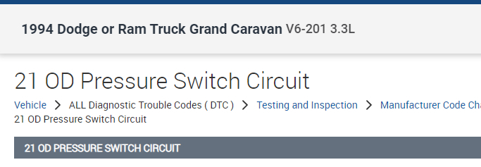

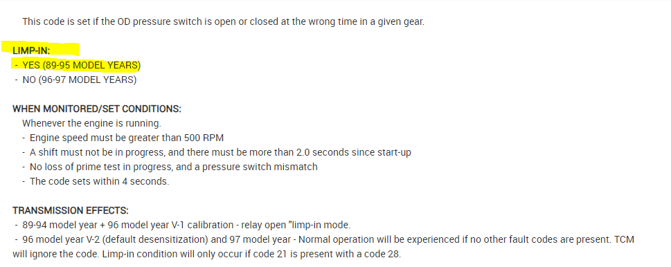

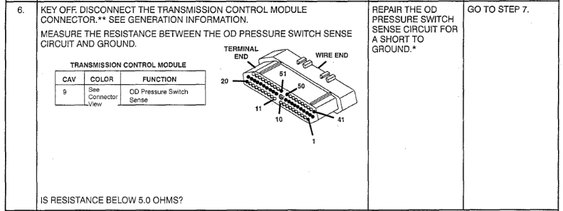

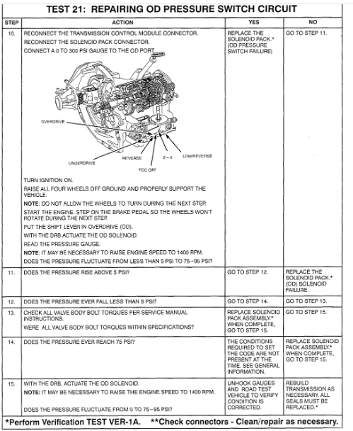

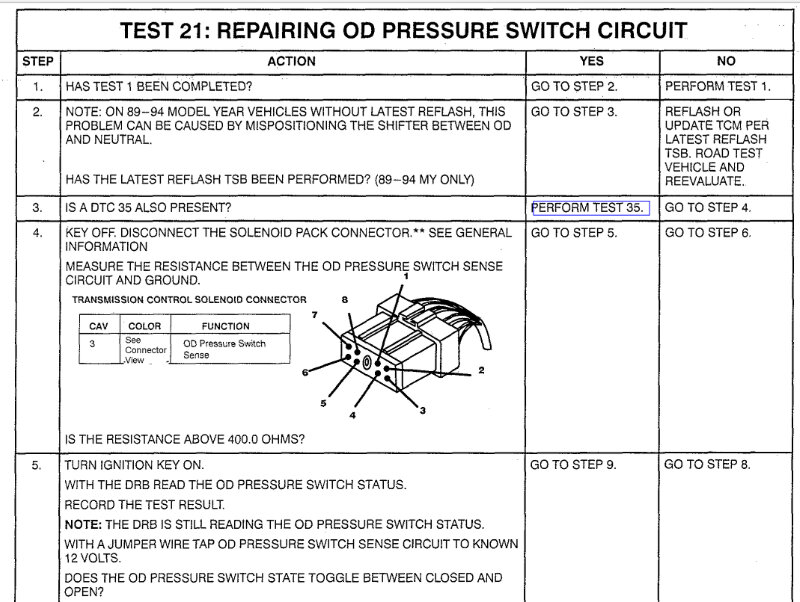

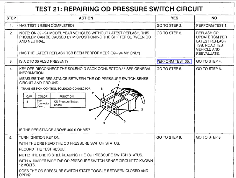

Code 21 is related to the OD pressure switch circuit. I attached the diagnostics below specific to that code. The code indicates the OD switch is either closed or open when it shouldn't be.
Take a look through the diagnostics and let me know if you are comfortable performing them. Also, let me know what you find.
See pic below.
May 7, 2024 at 6:58 PM

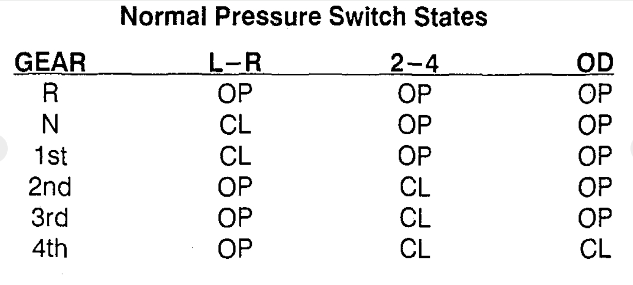

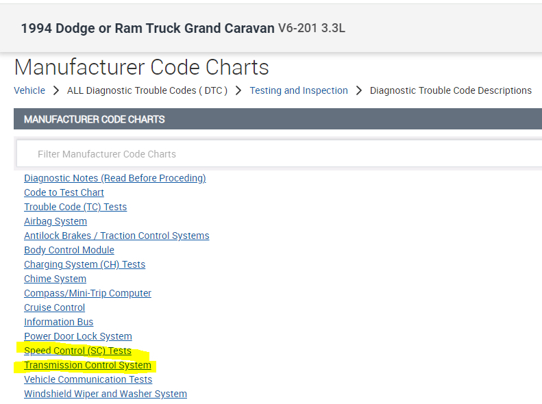

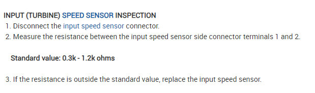

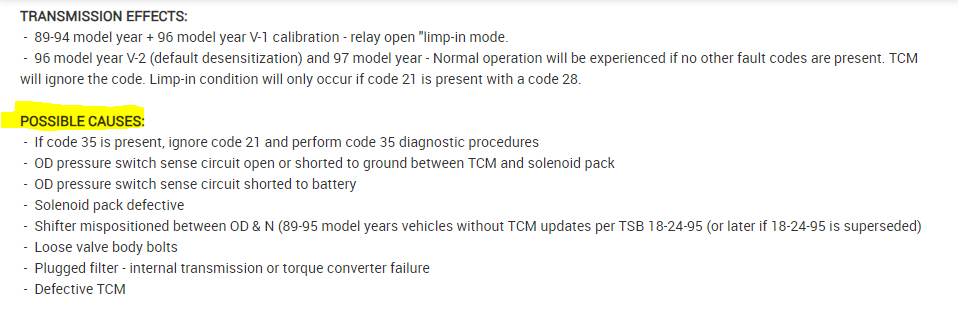

When I look for the code in my manual, the engine doesn't show up. Other things do including the transmission and the cruise control. (see pic 1)

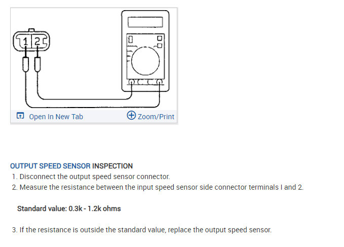

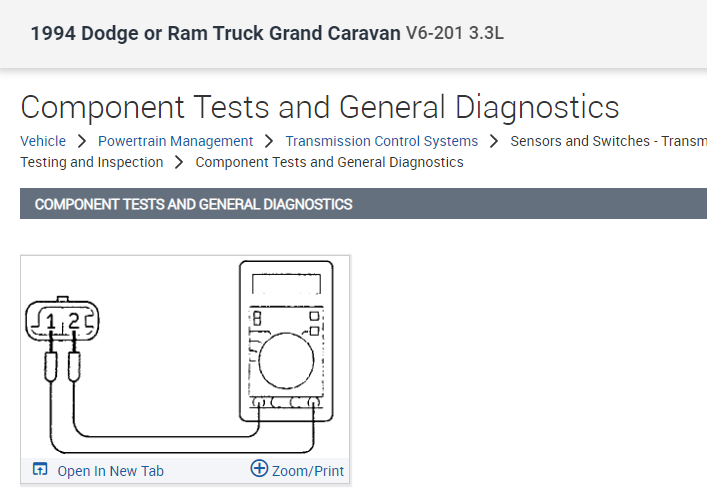

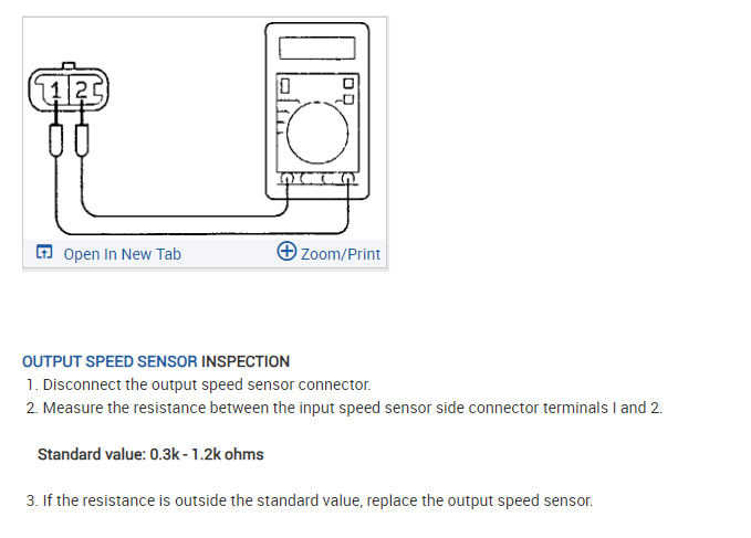

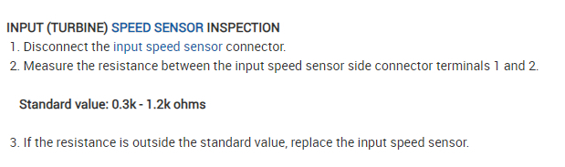

Also, I attached the diagnostics for testing both the input and output speed sensors. Take a look and let me know if it helps.
See pics below.
May 8, 2024 at 6:39 PM

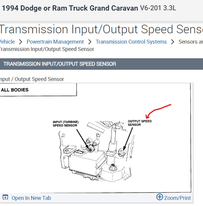

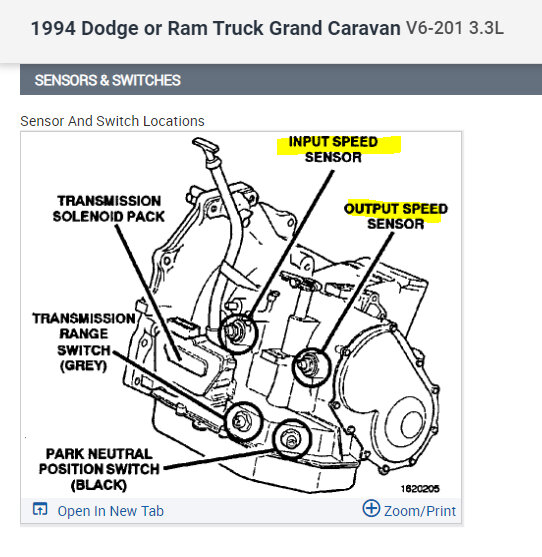

well, joe, i encountered something strange. i see 3 sensors on my transmission 1is over the shift solenoid then there is 1 to the right of the shift solenoid then there is another to the right of that some more i pulled the harness off the one to the right of the shift solenoid and there's 3 pins in the sensor so i don't know which pins I'm supposed to use when i test for resistance ? hence I'm puzzled.
May 9, 2024 at 2:45 PM
I attached a picture below showing the input and output speed sensor locations. Are these the ones you are referring to?
See pic below.
May 9, 2024 at 7:47 PM

That is very possible. As far as the speedometer, the Transaxle Control Module (TCM) calculates vehicle speed based on the input received from both the Input and Output speed sensor mounted on the transaxle. The output sensor is the most likely suspect.
I hope this helps.
May 10, 2024 at 7:42 PM

i tried to test the output speed sensor and the area is just too tight i couldn't really hold the test probes together to try to get a reading. and i didn't have the right size socket to remove it. I'm going to try to test the resistance at the TCM and see if i get a reading? Do you know if the sensors are the same for the 41te and the 41ae transmission? thanks
May 11, 2024 at 2:06 PM
If I was to check resistance, I would do it right at the sensor. The wiring itself will add to your reading.
Also, based on my manual, it is the same sensor.
Let me know what you find.
May 11, 2024 at 7:43 PM
