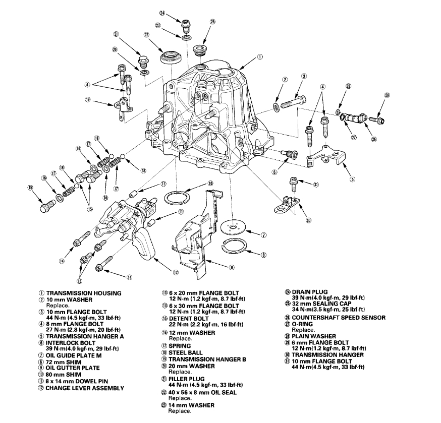

Ran transmission dry briefly, still works but fifth gear is now singing?
2004 HONDA ELEMENT
150,000 MILES • 2.4L • 4 CYL • 2WD • MANUAL
VINCENNES44
Ran transmission dry briefly. still works but 5th gear is now singing... want to replace damaged internal parts. What do you believe is damaged in there? People speculate I burned the synchro- I am confident (mostly) to open the transmission and replace anything ruined but can't find where to buy such stuff. As I am here, I believe I have a parasitic battery drain. At the same time, the driver's side window switch went from one tap automatic roll down to a need to hold the button down to get it down. Thank you for being here, I heard good things about this site. Thank you, Matt

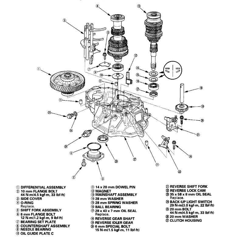

Yep, we are glad to help but we only handle one problem per thread. so, please start a new question for the battery drain and window problem. here is how the transmission comes apart so you can do the repair of the damage's parts. Check out the images (below). Let us know what happens and please upload pictures or videos of the problem so we can see what's going on.
