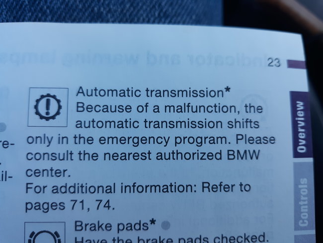

About 5 weeks I had a voltage regulator fail on my car, wouldn't recharge my battery out of nowhere at all, had to get jump started 3 times to get home, and every time the battery got low the car went into emergency mode.well I replaced the alternator and I've got great voltage, yet the transmission is still in emergency mode . The previous owner told me same thing happened to her like 5 years ago, and a mechanic reset something? I need to know the fix !

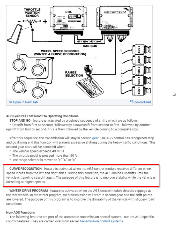

Sounds like we either have an internal transmission issue or control issue.

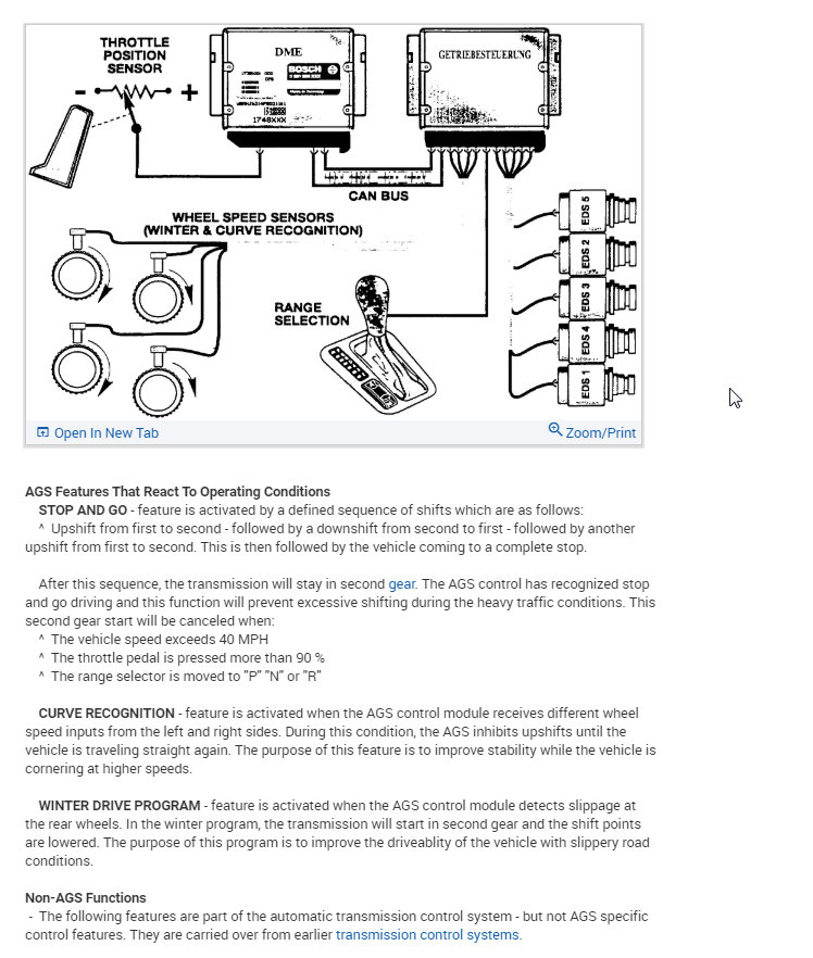

Is there any chance that you have replaced one or two tires recently? The reason is, your transmission control looks at wheel speed to determine the curve recognition shifting. If one of these is off, it could cause the trans to shift and put itself into emergency mode. Basically it is seeing something wrong which is why it is doing that. The shifting erratically may be a symptom of this.
Take a look at all this info that goes through the control system.
Feb 16, 2020 at 6:08 PM

So you had no shifting issues before you changed two of the tires to a different size? I understand it didn't do anything for a couple weeks but this doesn't mean it is not the tires. The transmission looks at each individual wheel speed and adjusts shifting.
We need to monitor wheel speeds with a scan tool to verify this. However, I would look to getting all the tires the same circumference.
Feb 20, 2020 at 6:20 PM
