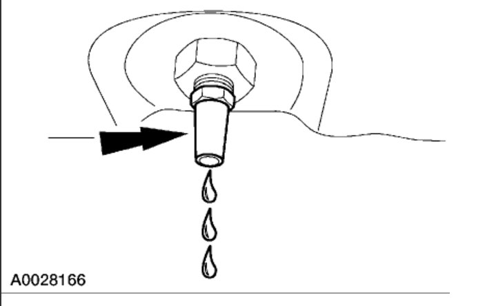

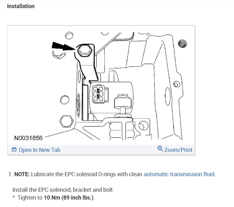

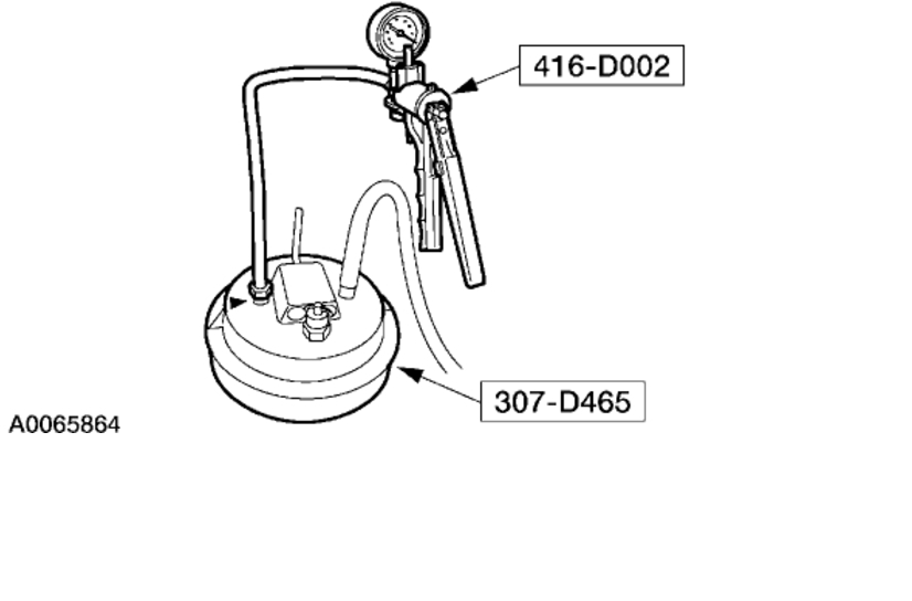

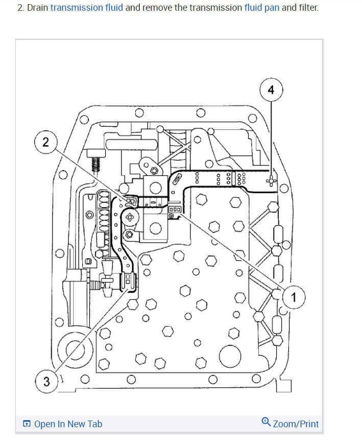

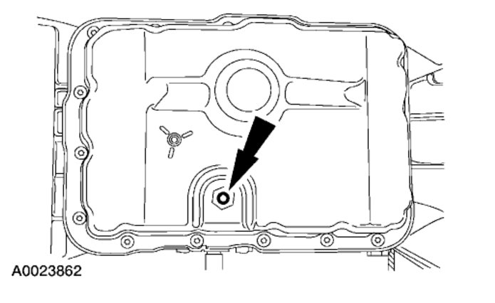

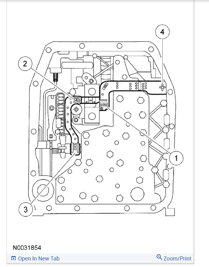

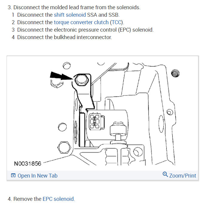

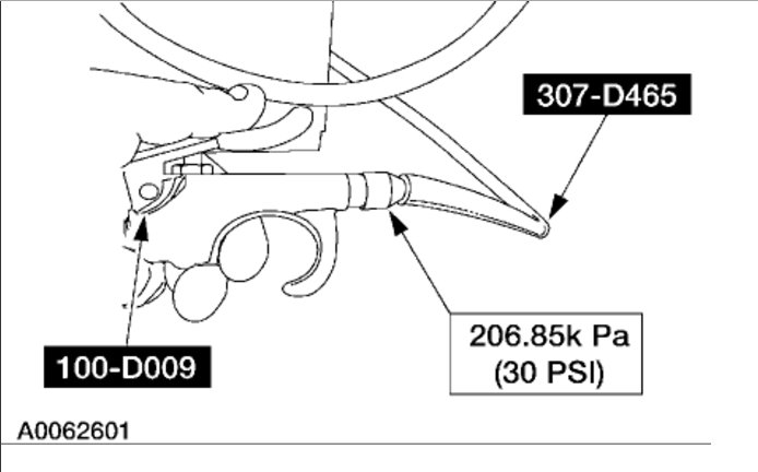

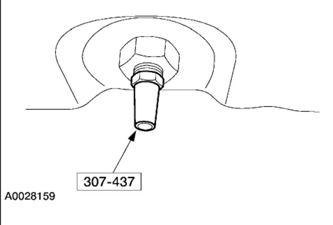

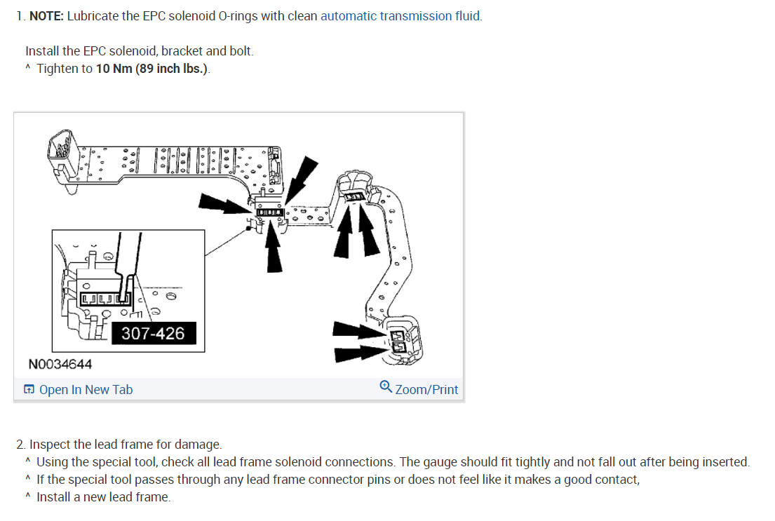

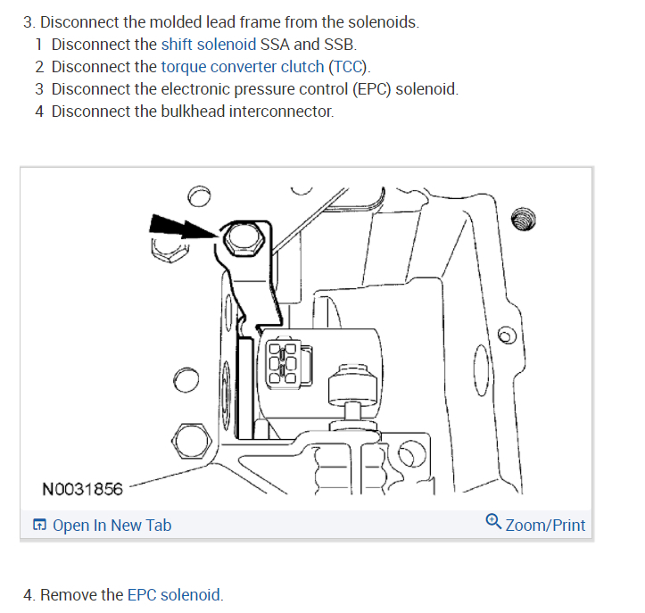

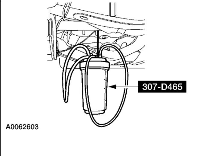

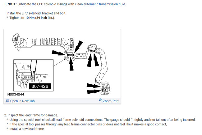

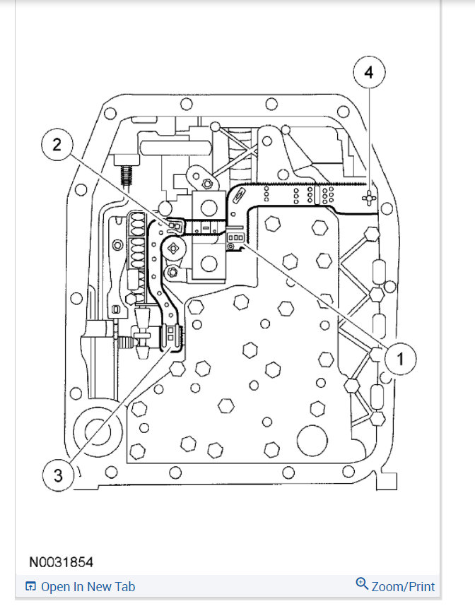

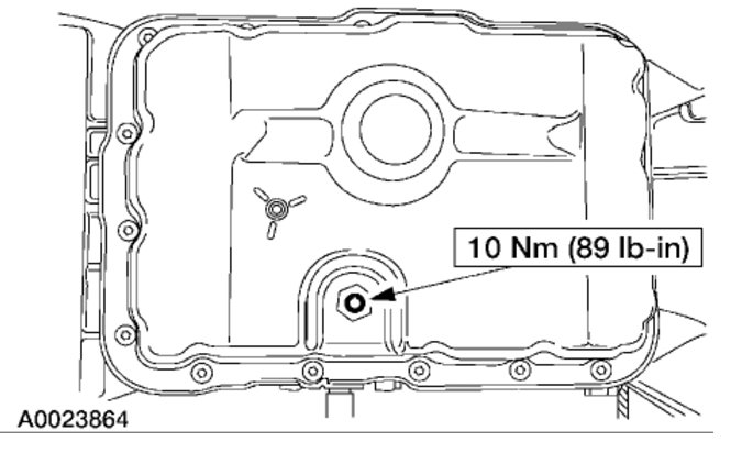

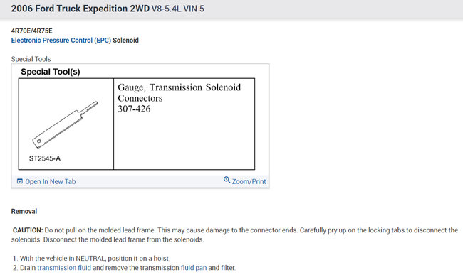

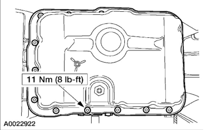

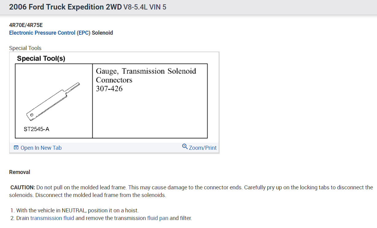

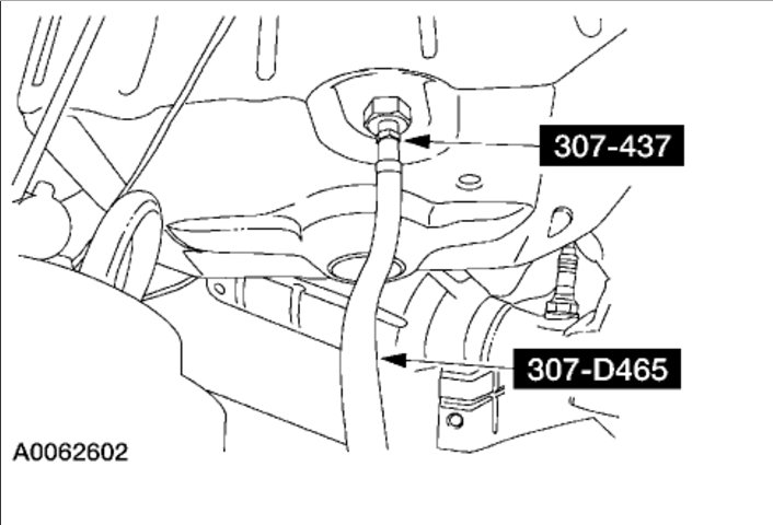

This happens when the fluid pressure sensor goes out you should change the fluid as well. here are guides and diagrams below to show you how to make the repair:
and
https://www.2carpros.com/articles/automatic-transmission-problems
