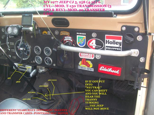

Was absolutely thrilled to read that one of you there is a Jeep CJ guy - hope you can help me out. Firstly, the year and model of my jeep as stated may not be correct. But it's definitely either CJ5, 6 or 7. The jeep was running fine when all of a sudden with no prior warning of any kind, it would not shift or engage into any gear and remains in Free. Even with the engine OFF i still couldn't engage any gear. For ex. With engine off, i push lever into 1st gear. It does feel like its engaged. Then i start the jeep (without clutching) and it should jerk forward right? In my case - no, it just remain in Free gear. So what's up doc?
Thank you in advance for time n trouble. - Michael
