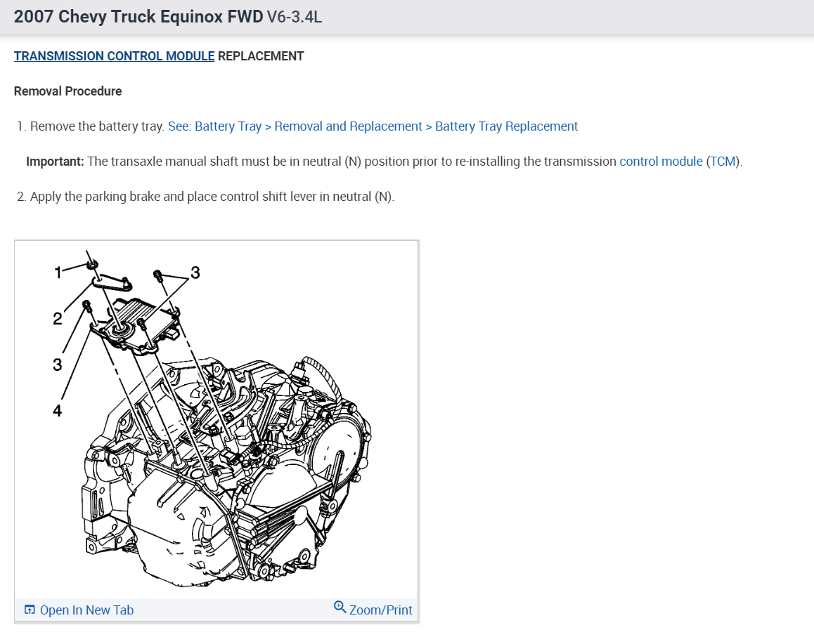

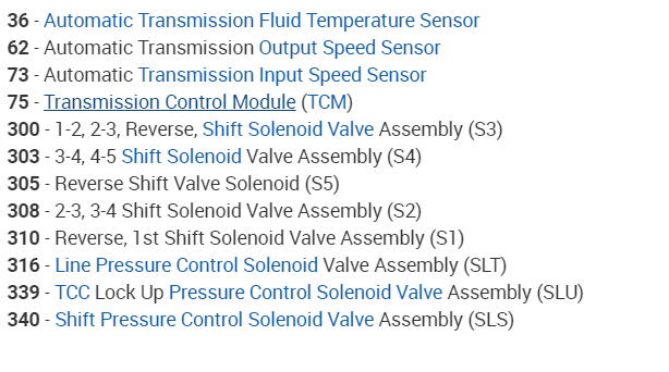

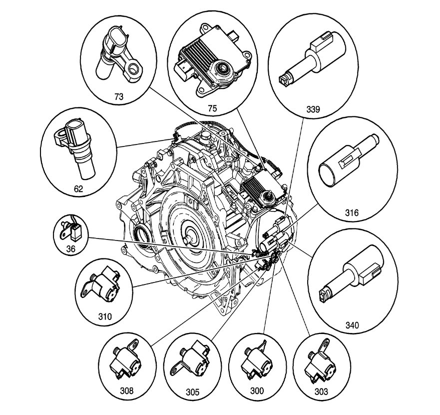

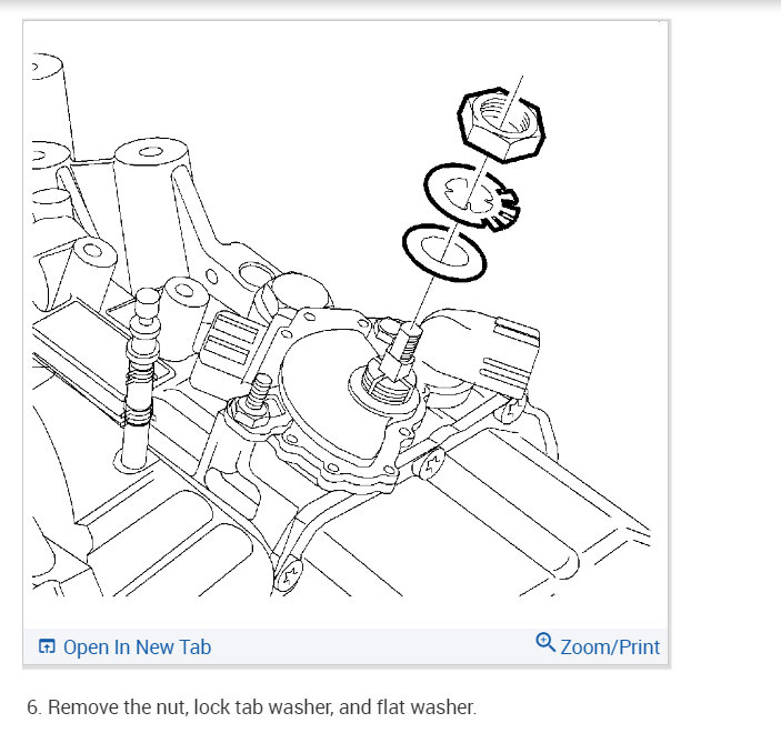

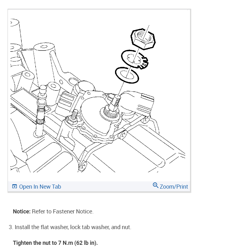

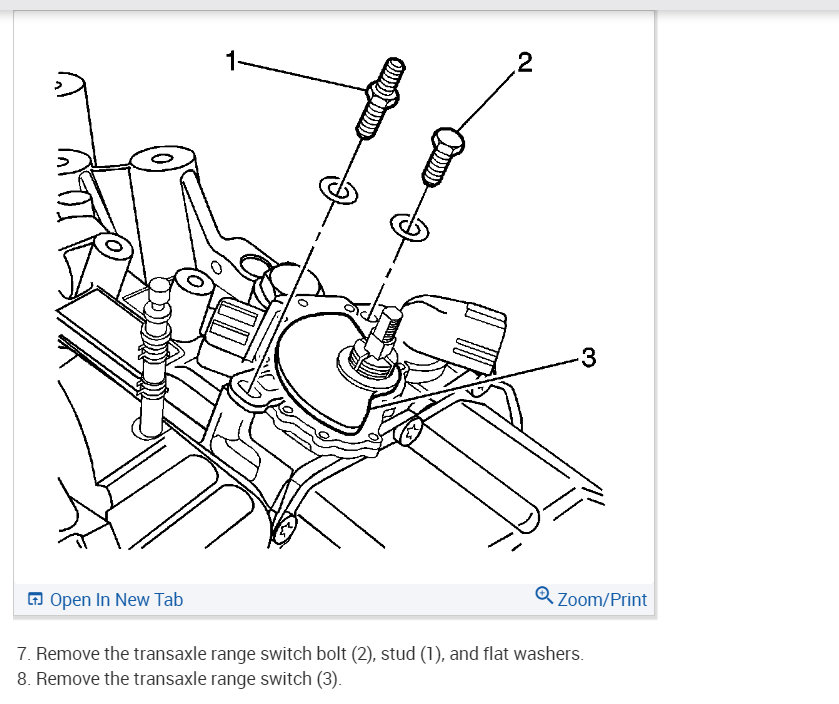

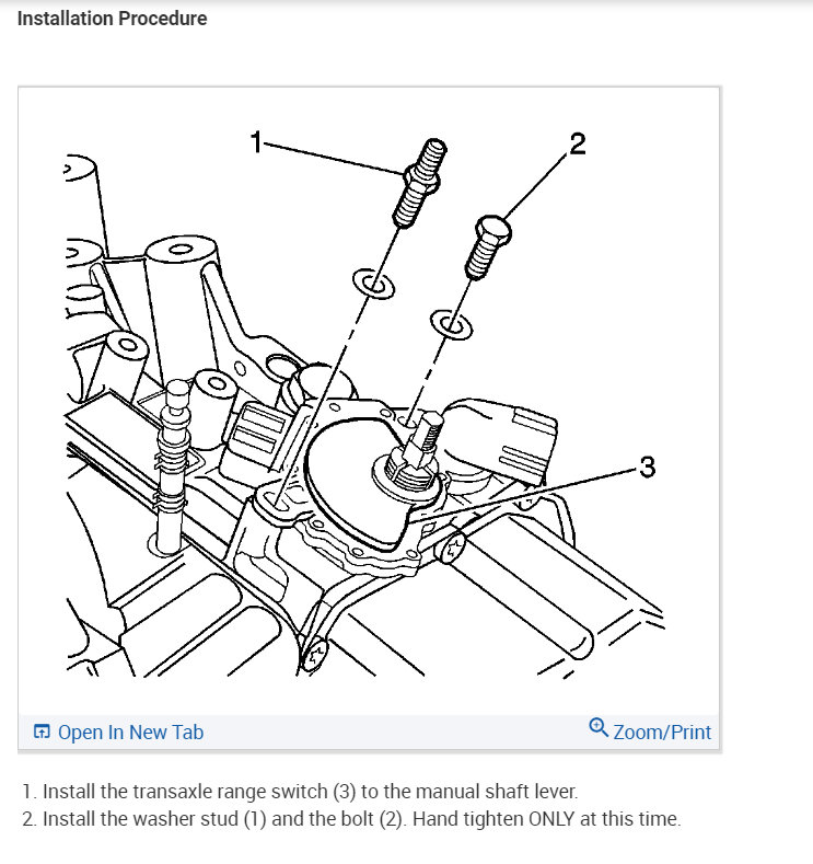

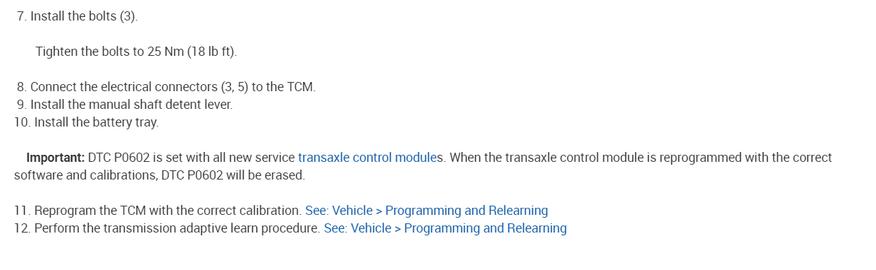

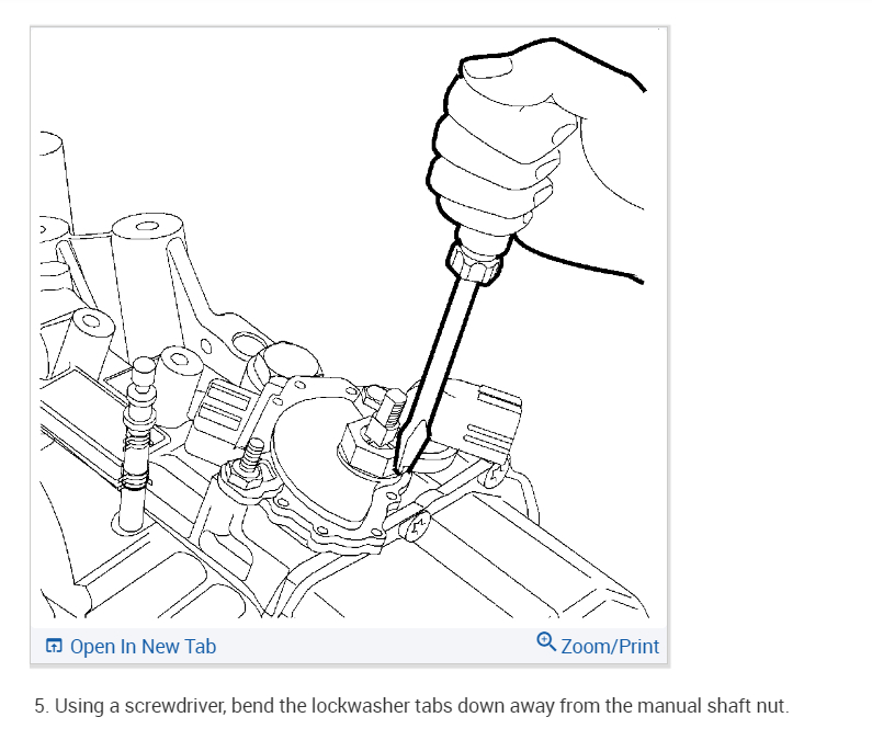

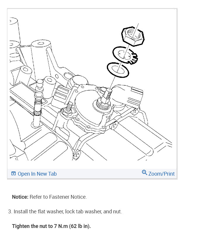

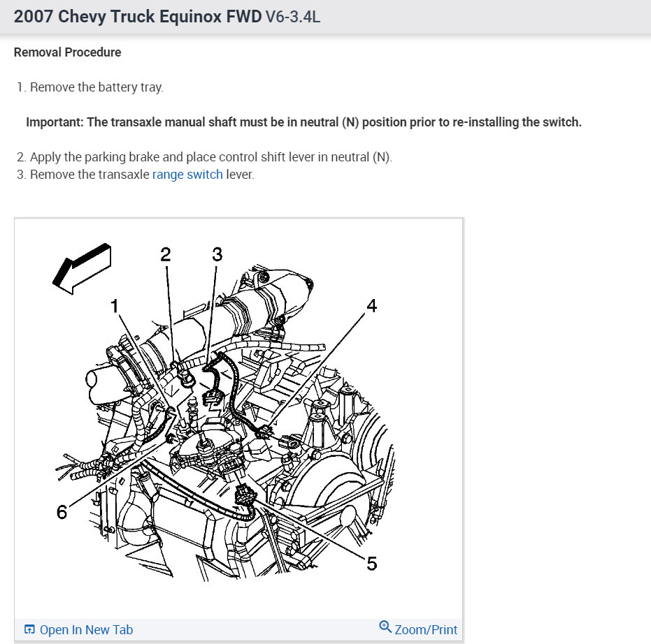

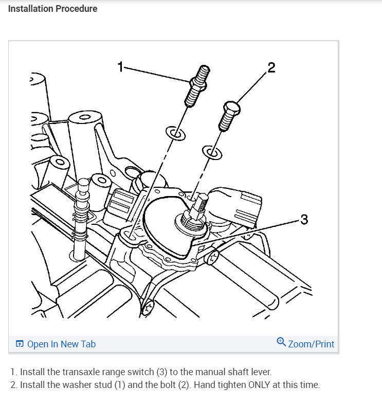

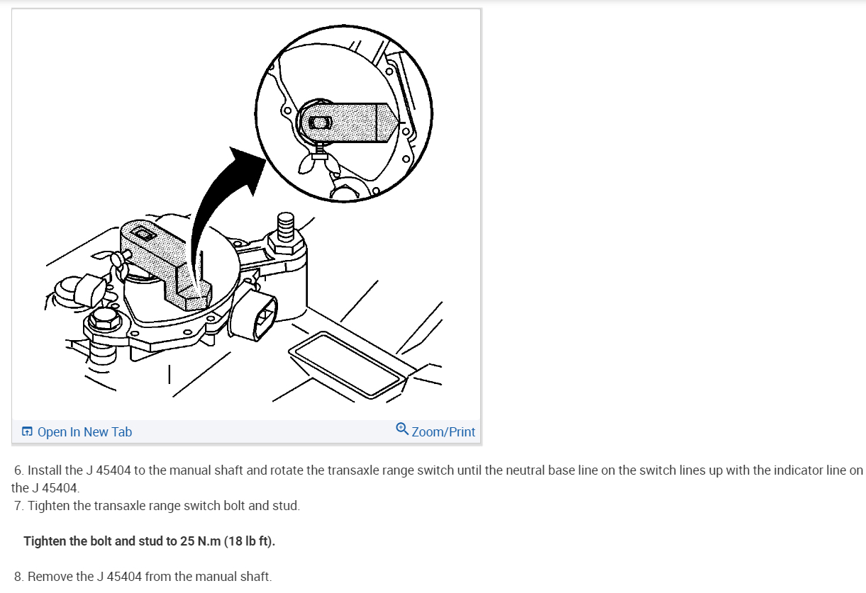

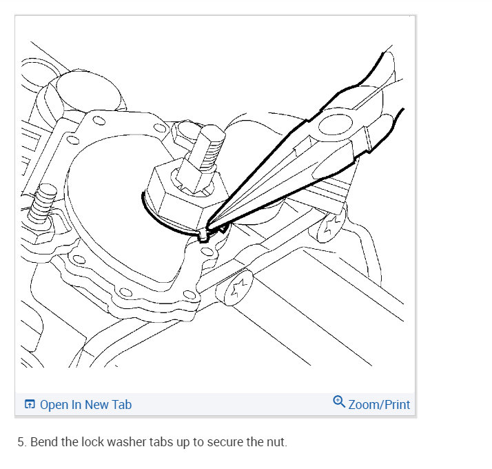

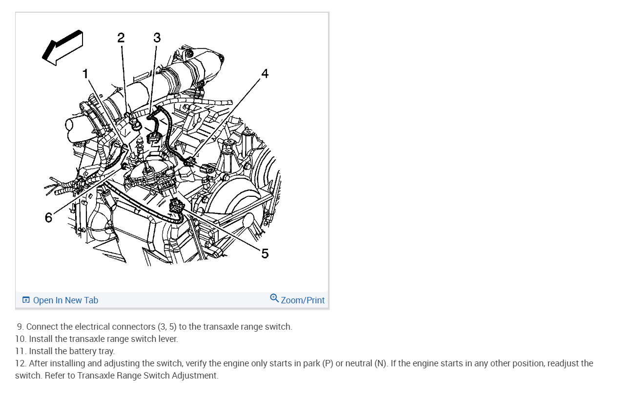

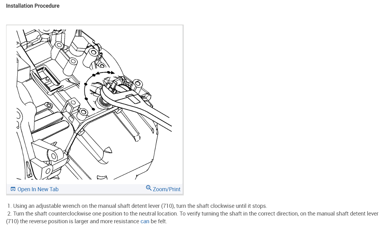

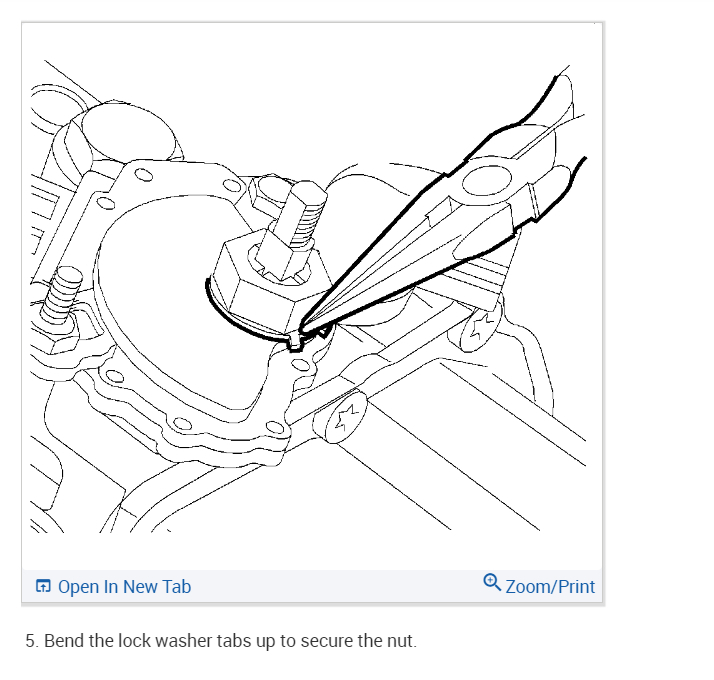

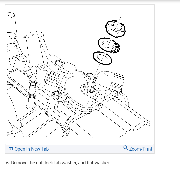

It sounds like the gear range sensor is not working correctly, but we should run the codes to see what comes up. This guide can help, and I have included how to change the sensor out in the images below.

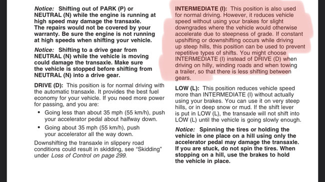

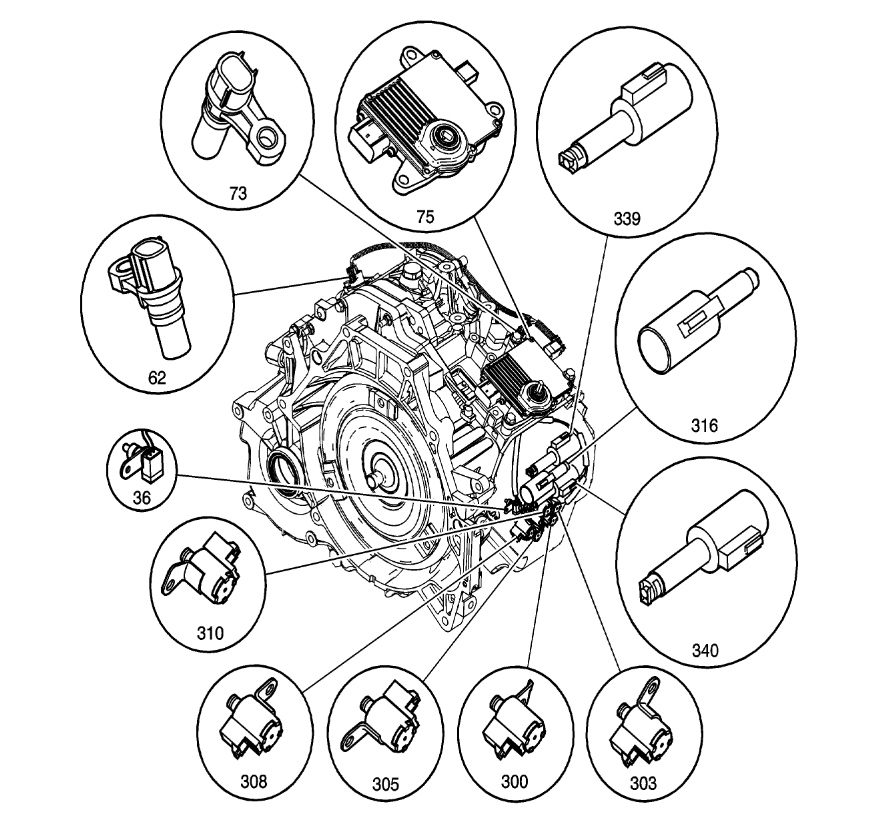

I’ll get a picture/short video when I go to do some body work on the car later. For now I have this from the manual.

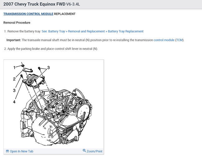

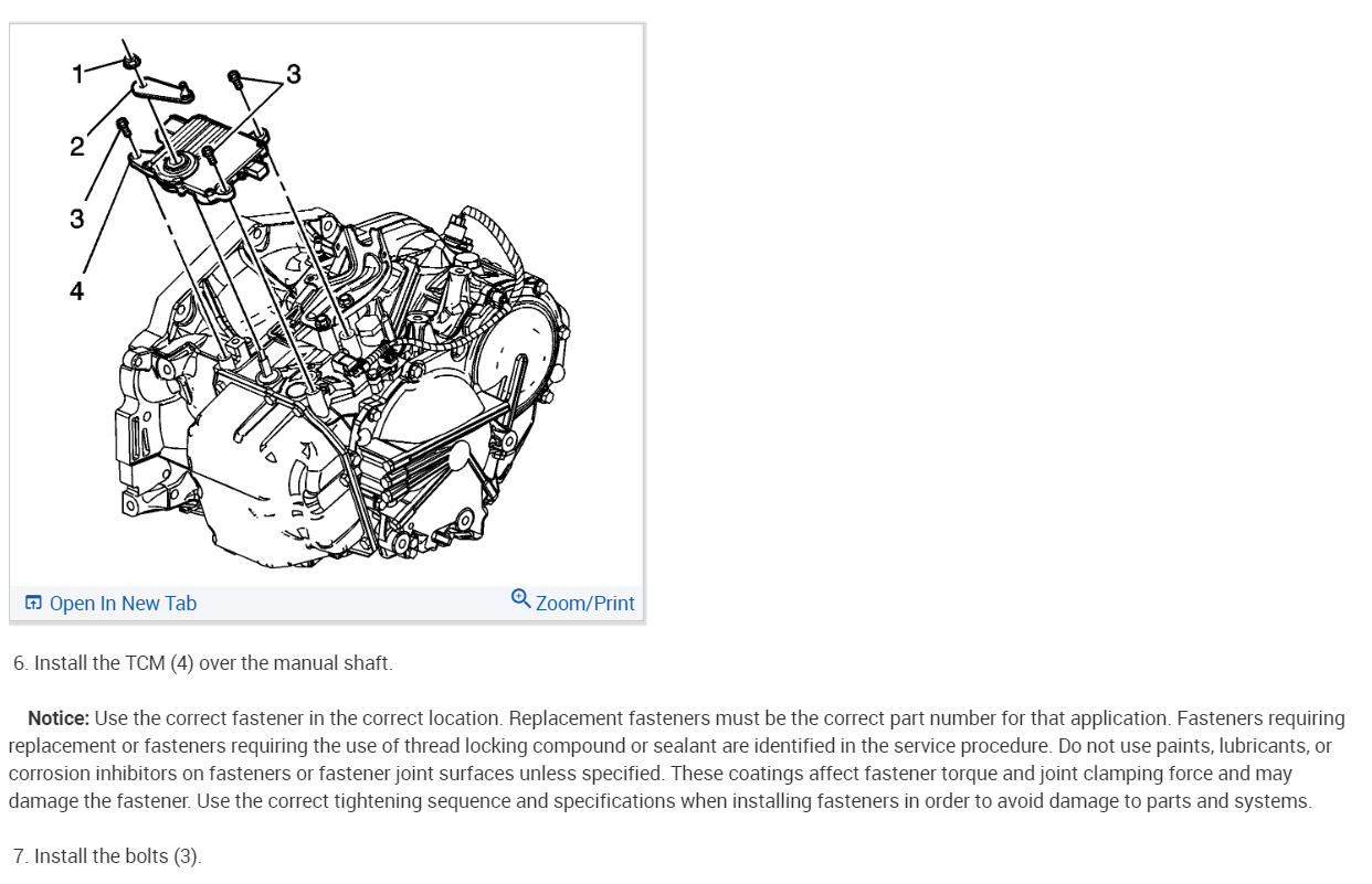

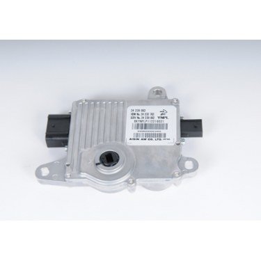

Also, I do not have a gear range sensor like the one pictured in the diagrams you posted. Where that would be, I have this.. Which I believe to be the TCM.
Aug 21, 2022 at 6:31 AM

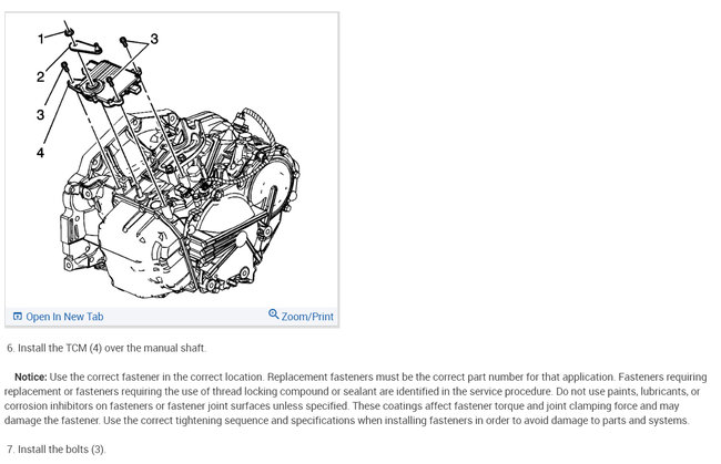

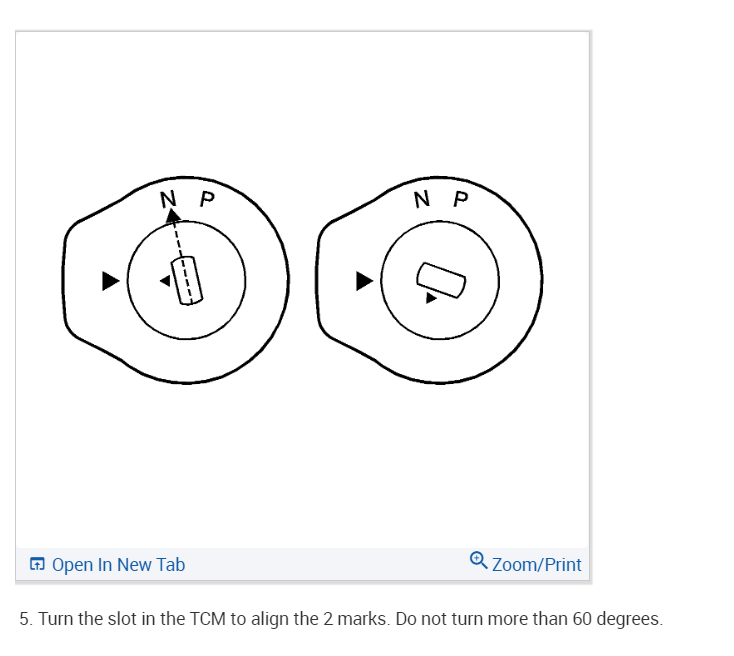

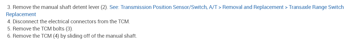

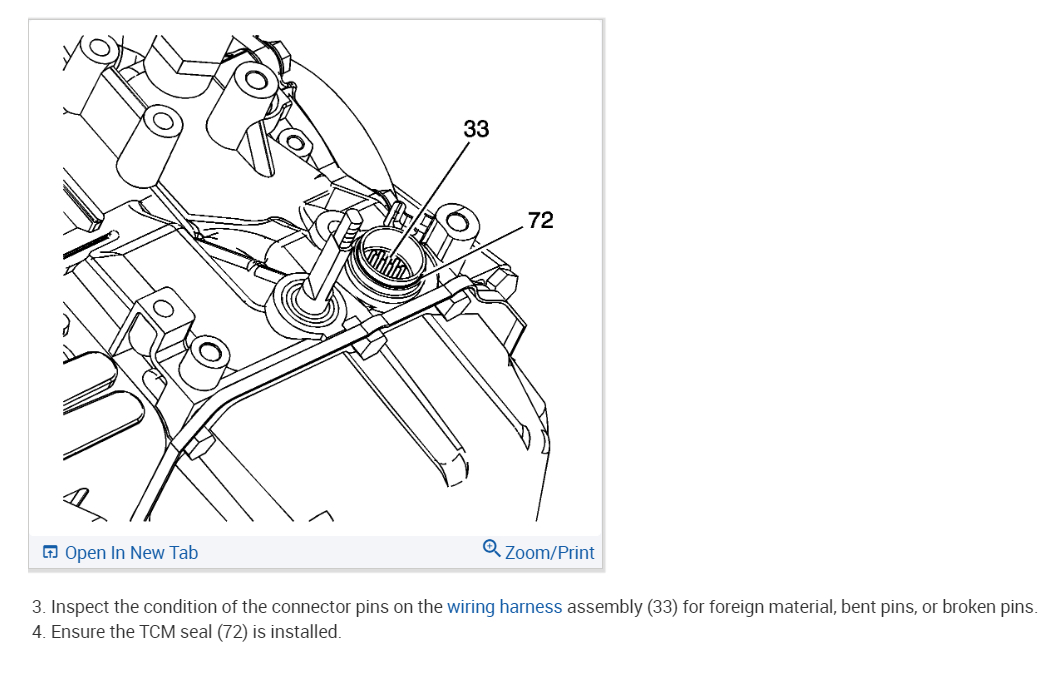

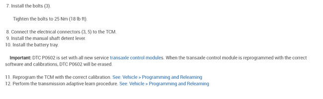

Nice, thanks for the info, yes that is the TCM here is how you replace it in the images below. Let me know what happens please.
