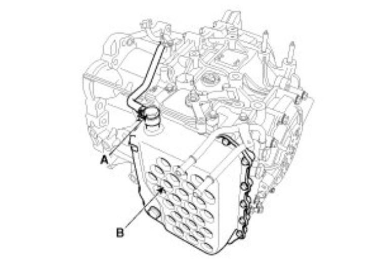

3. Replace new gasket and the plug after draining the automatic transaxle fluid by removing the drain plug.
4. Remove the valve body cover (B) and eyebolt (A).
Tightening torque:
(A) 34.3 - 44.1 N.m (3.5 - 4.5 kgf.m, 25.3 - 32.6 lb-ft)
(B) 13.8 - 14.7 N.m (1.3 - 1.5 kgf.m, 9.4 - 10.8 lb-ft)
Caution:
Always replace the gasket of the eyebolt use new one whenever loosening eyebolt.

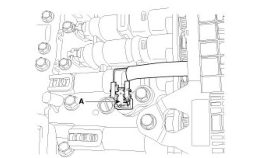

5. Disconnect the oil temperature sensor connector (A).

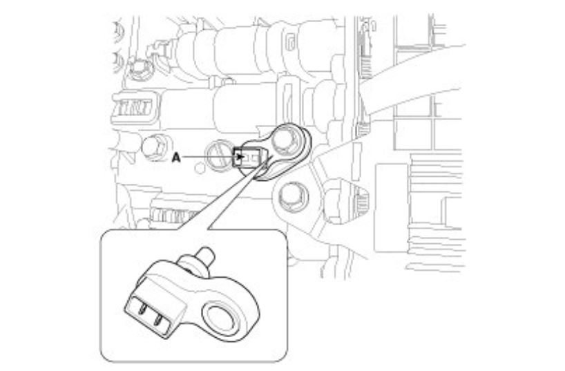

6. Remove the oil temperature sensor (A) after removing a bolt.
Tightening torque:
9.8 - 11.8 N.m (1.0 - 1.2 kgf.m, 7.2 - 8.7 lb-ft)
