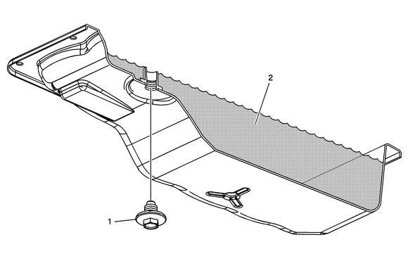

For some reason, I am unable to upload the directions. However, I will try to explain what is done.
1) The transmission fluid temp needs to be between 86 and 122°F. You will need a scan tool to read the temperature.
2) When you remove the fill plug, the fluid should drip. Note, the engine must be running. when this is checked.
If the fluid runs out, allow it to do so and wait until it drips. If nothing comes out, add fluid until it drips.
I attached a pic below of which plug needs removed for this test.
Let me know if this helps.

Hi Ken. I can't find the second reply. First, I checked the fluid with 1.5" planks in front, bringing the frame level. At 110*f truck running in park, no fluid came out. I hand pumped 4 3/4 quarts. Out truck not running. Fluid looked good at first glance, but it was real dark red, slight metallic floating.
Pumped 6 quarts in, started truck and drained till it was a drip, drip. All done took 25 minute run, shifts great. No wonder GM is having problems, first how to level truck. I changed at 31,000 miles, not 45,000 as required, it needed it. Second. Truck bought new never towed, or worked hard. And the fluid looked real bad. I will do it again with new filter, this time I didn't want to unbolt the exhaust.
Thanks. Joe
