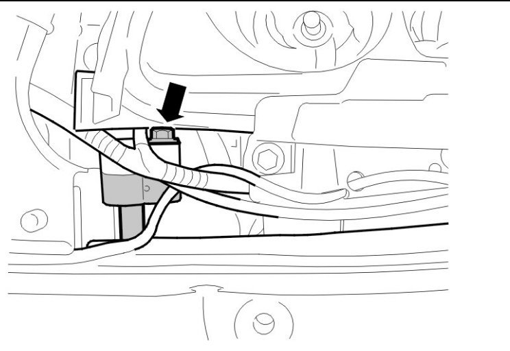

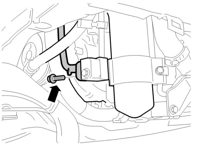

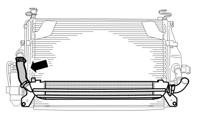

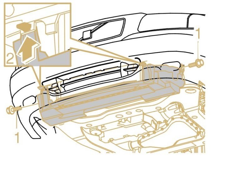

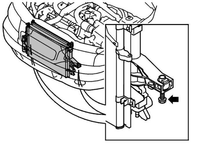

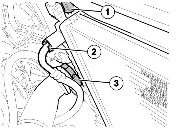

Hey TABLETALK,

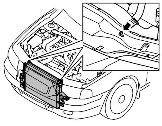

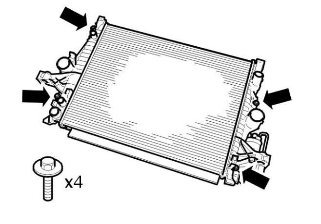

Nice work on the JB weld I hope it will work for you but if not here are some guides and instructions on how to replace the radiator, you will need to discharge the air conditioner.
and
https://www.2carpros.com/articles/how-to-replace-a-car-radiator
Please let us know happens.
