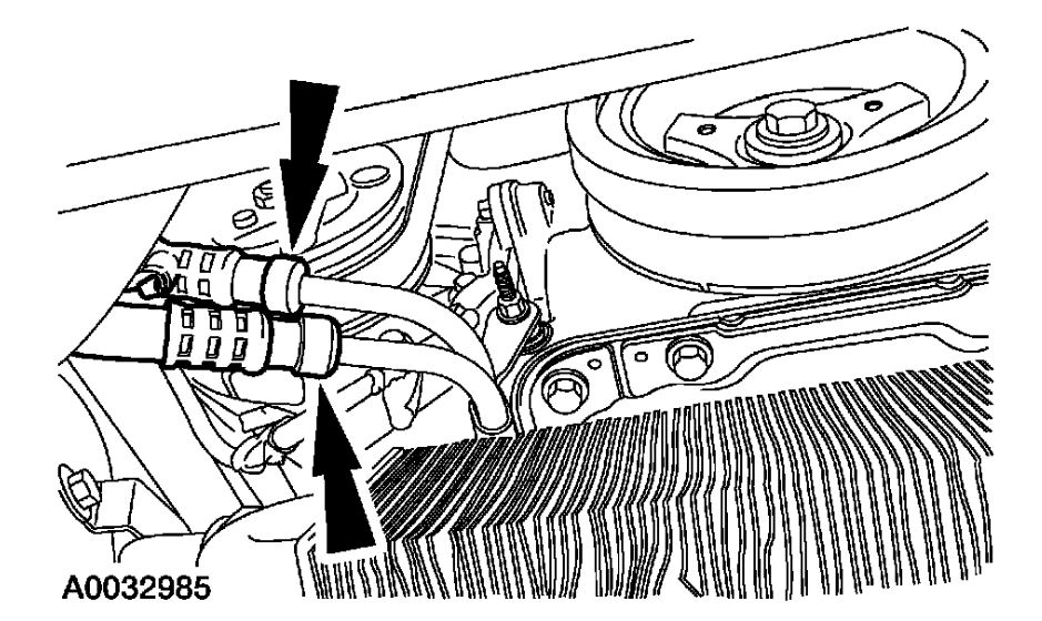

Okay, first, go to a parts store and have the code checked. If you cannot drive it, then get a cheap one from a parts store and read the code. That will give us a direction of the failure.
If it is leaking that quickly, look under the hood at the lines that go the radiator. The cooler lines have a lot of pressure.
