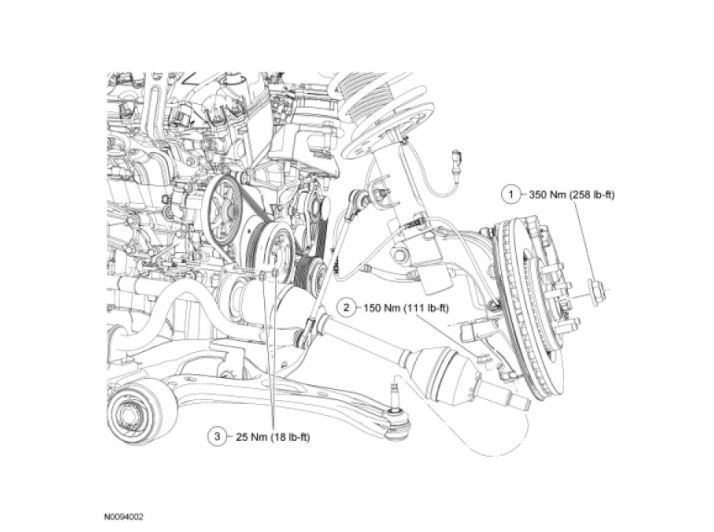

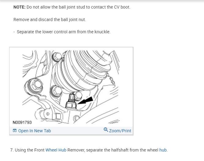

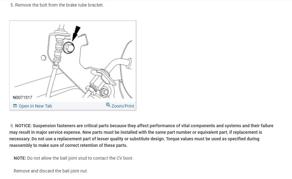

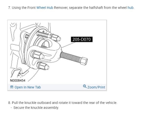

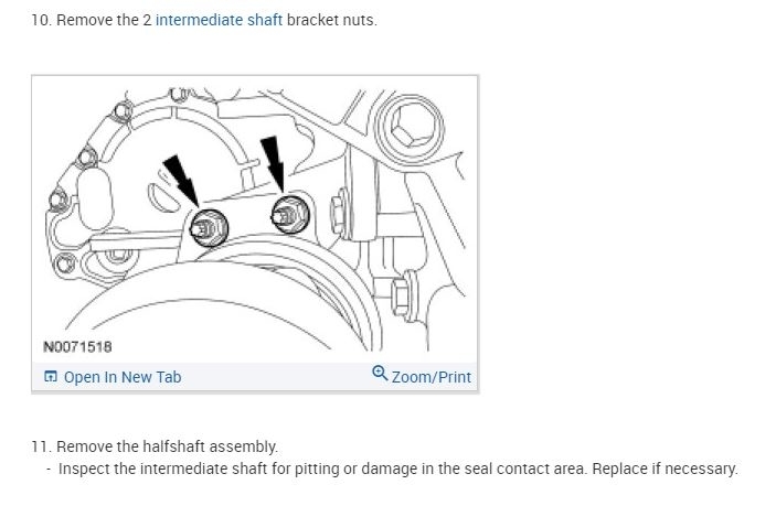

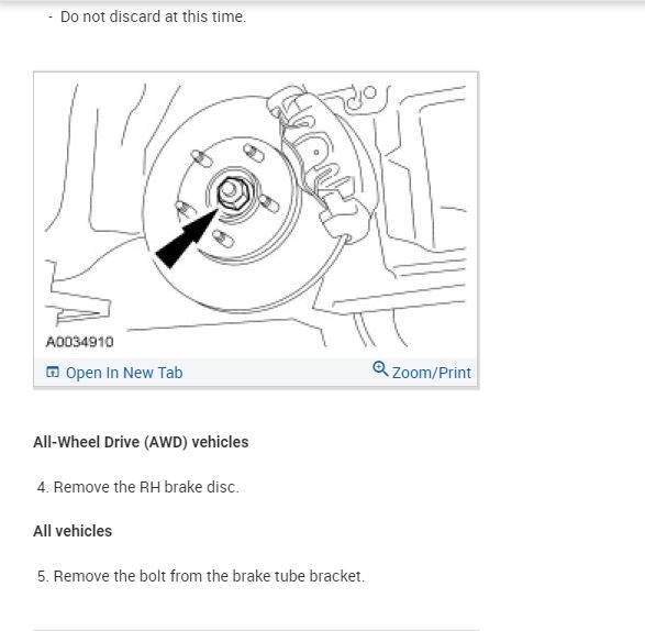

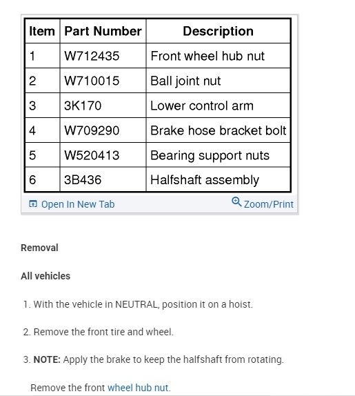

There is a seal in the transmission where the axle is mounted.
It sounds like that seal may be the issue.

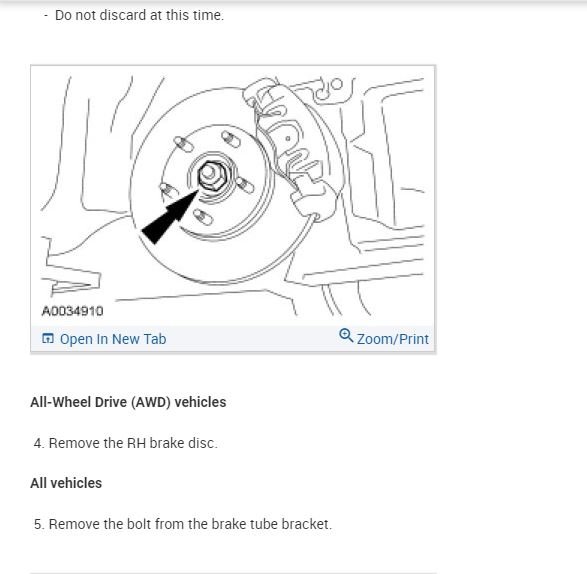

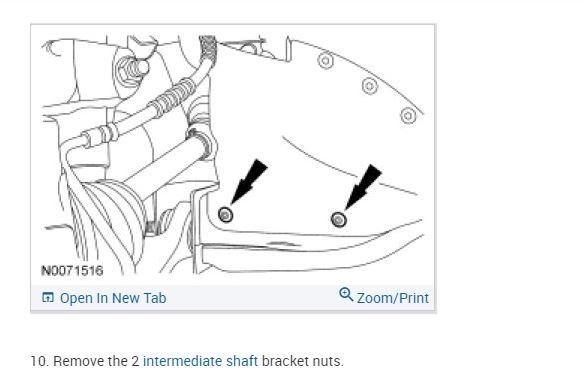

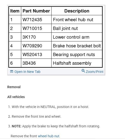

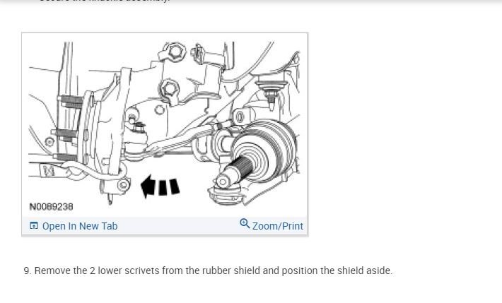

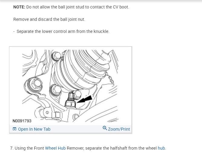

I attached the procedure for you for the repair. Once the axle has been removed, the seal can be removed and a new one installed.
https://www.2carpros.com/articles/replace-cv-axle
Let me know if you have any other questions.
