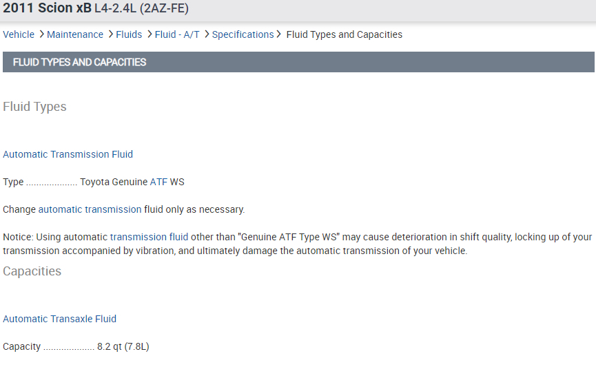

In an ideal world using just the gasket should be sufficient to prevent leaks. However, it is best to use a sealant with the gasket to ensure no leaks.

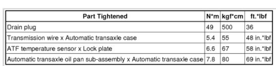

Scion does not provide torque specs for the filter bolts. I have usually firsthand tighten those bolts all the way then do half a turn. That typically takes care of it. Typically, on bolts of that nature I like to use a smaller ratchet like a 1/4" one to prevent over torquing.
I know there should be an O-ring for the filter.
