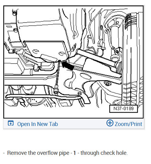

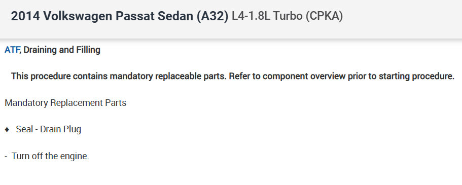

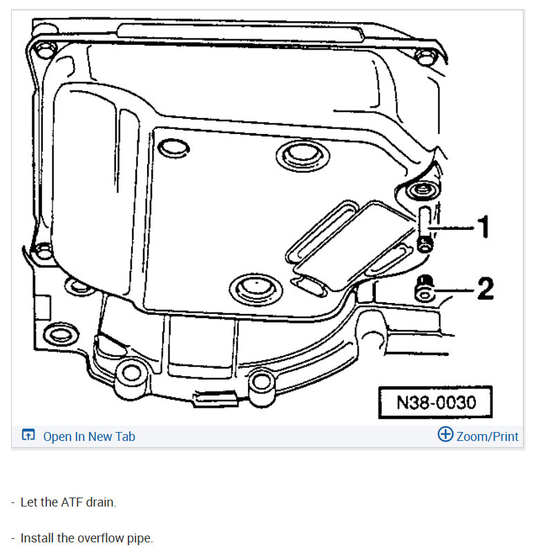

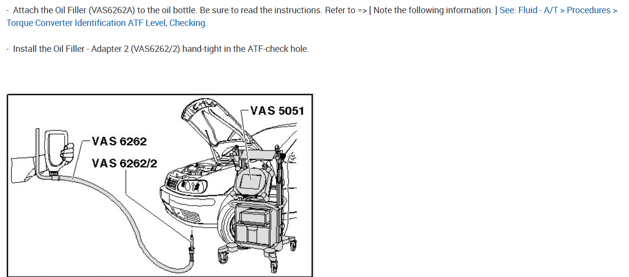

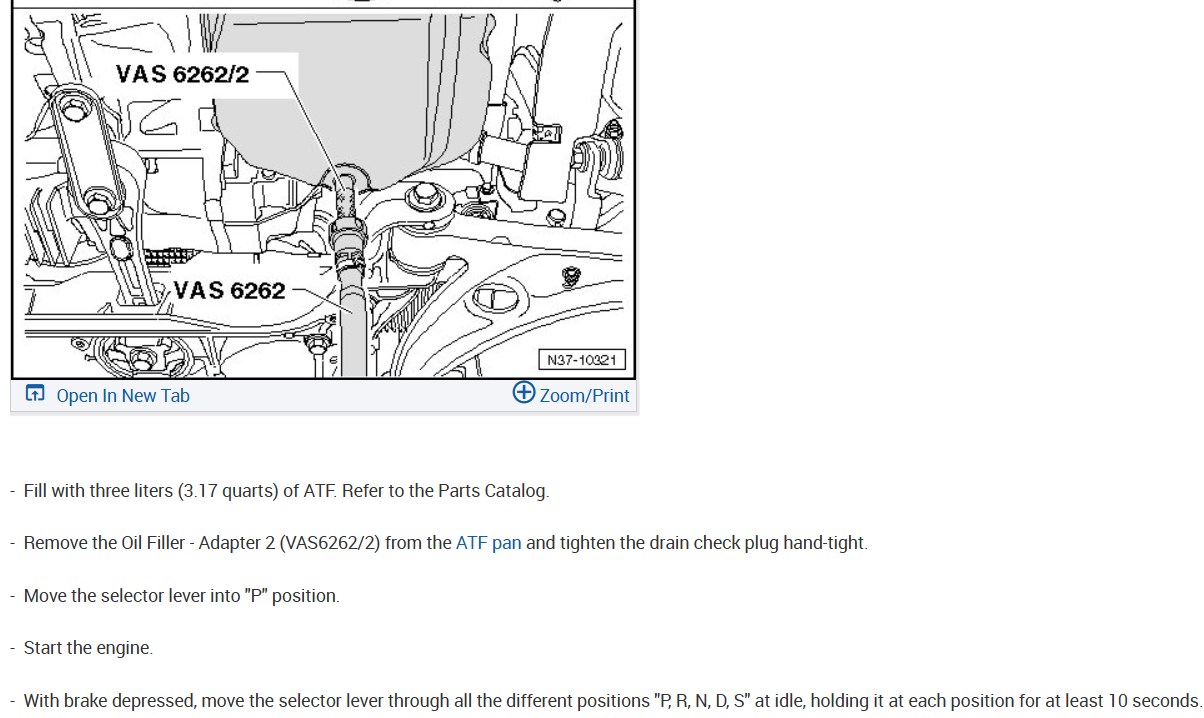

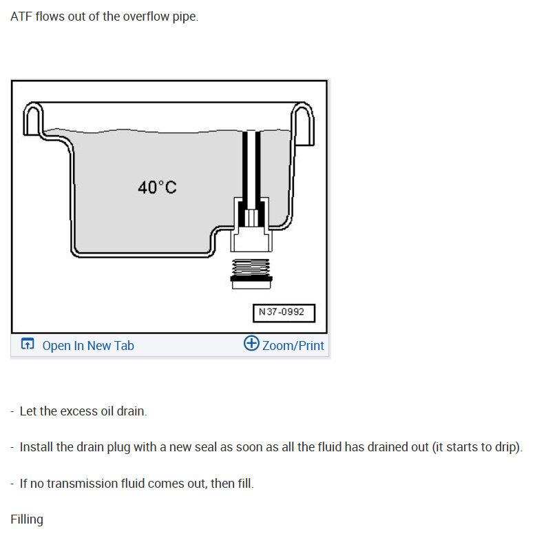

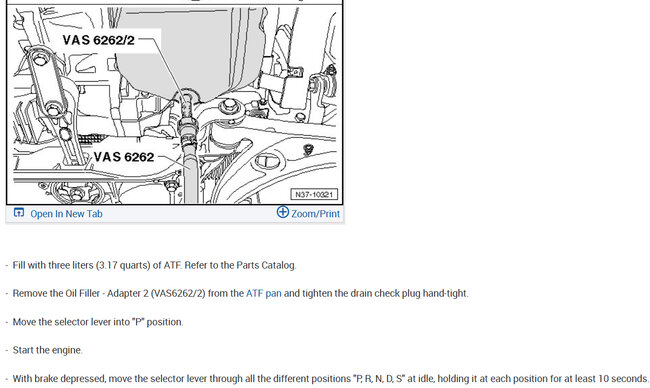

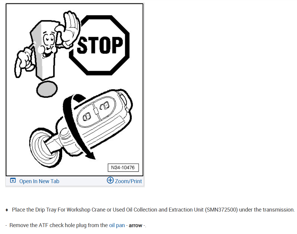

To service this transmission, it takes a special tool which goes into the drain plug to help set the new fluid level. Check out the images (below). Let us know if you need anything else.
