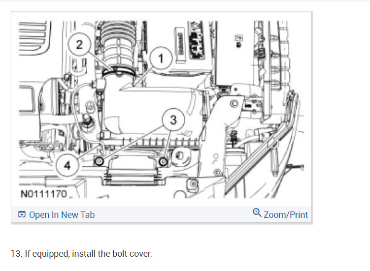

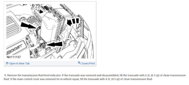

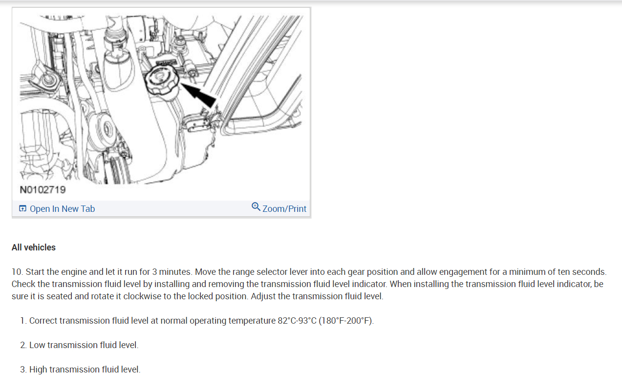

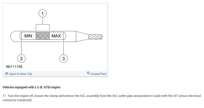

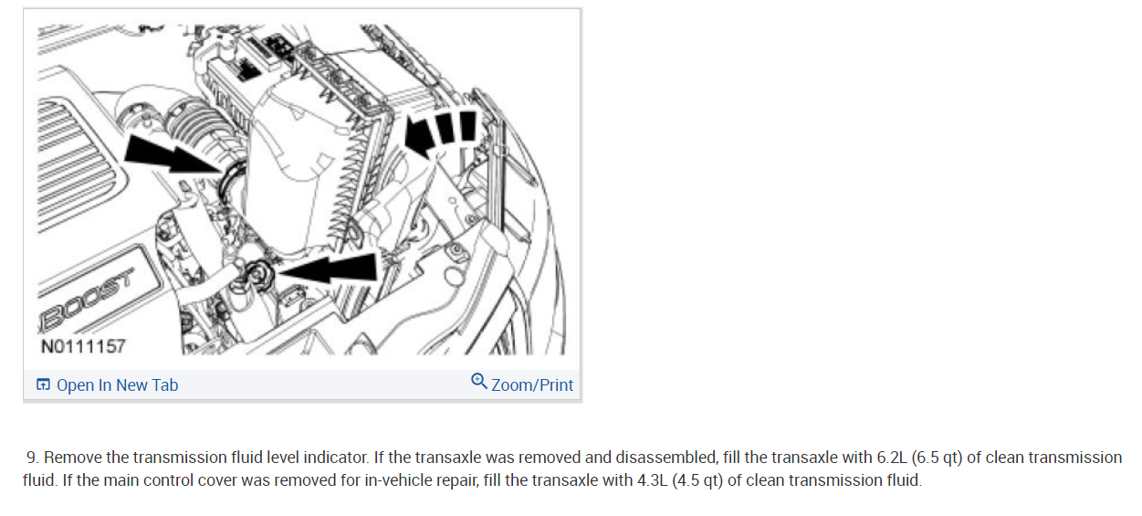

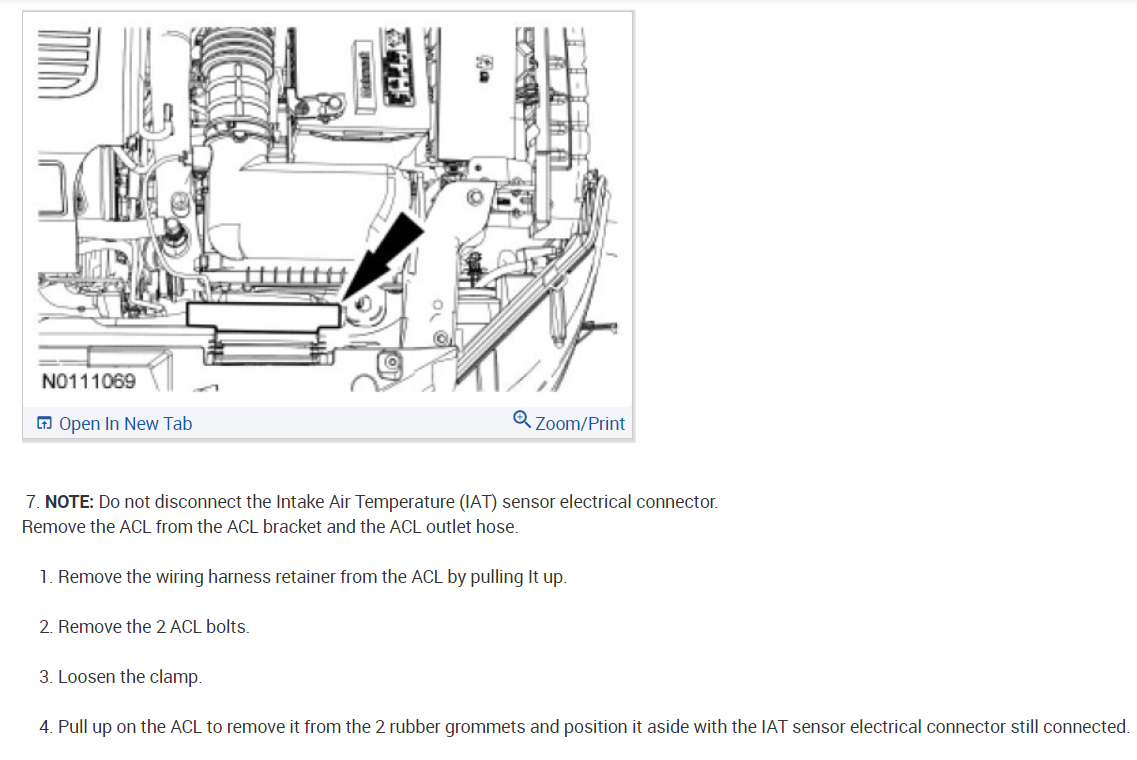

I'd like to know how to change the transmission fluid. Wat kind of fluid does it take as well?
Feb 1, 2016 at 2:21 AM
JOHNNYT73
CERTIFIED EXPERT
924 POSTS

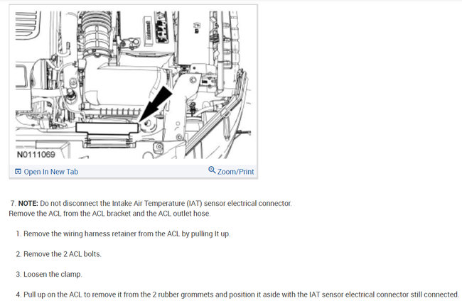

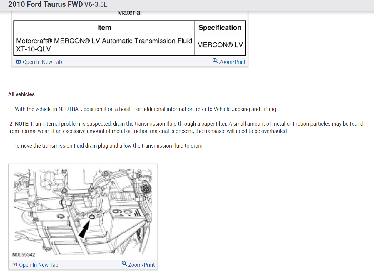

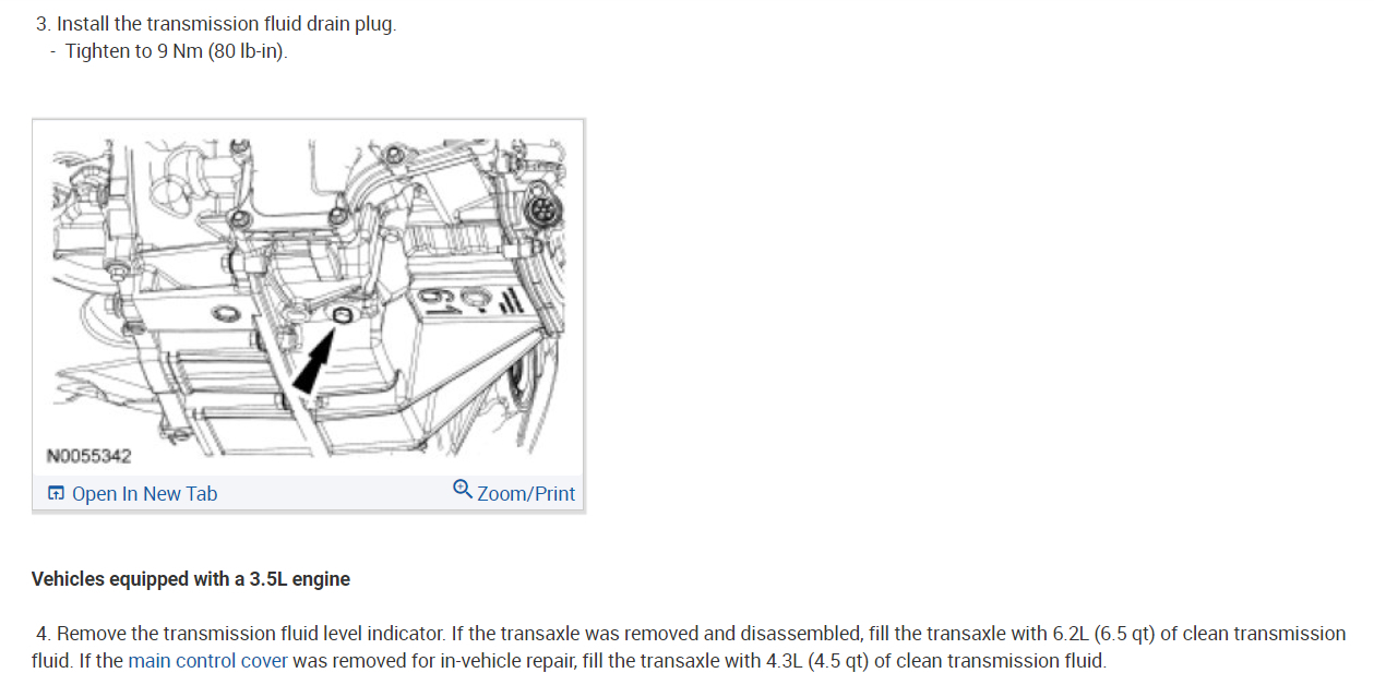

This video shows the job being done on a similar car but the process is the same with diagrams below for your car.
https://youtu.be/NUOBl4bqtss
Here is a guide to help you step by step with instructions in the diagrams below to show you how on your car.
