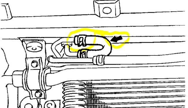

There is a procedure for that transmission that involves more than just draining the fluid and refilling. Fluid used is DIAMOND ATF SP II M or SP III
1. Disconnect the hose shown in the illustration (first image) which connects the transmission and the oil cooler. Place a container under the hose to collect the discharge.
2. start the engine with the transmission in neutral and let the fluid drain out.
Caution: The engine should be stopped within one minute after it is started. If the fluid has all drained out before then, the engine should be stopped at that point.

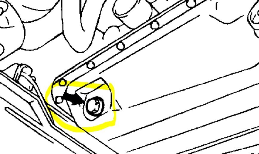

3. Remove the drain plug from the bottom of the transmission case to drain the fluid. (second image)
As you are planning on changing the filter step 4 gets modified a bit, just reinstall the plug so it doesn't leak. You will replace the filter and gasket after you remove the pan after step 6
4. Install the drain plug with a new gasket, and tighten it to the specified torque.
Tightening torque 24 ft-lb
