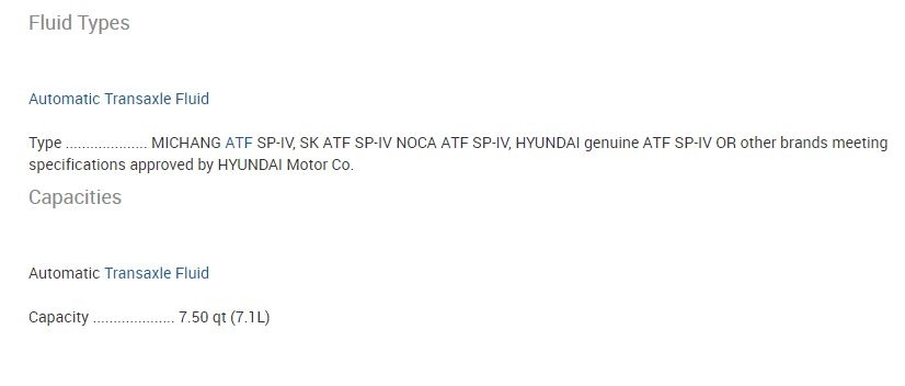

What is the transmission fluid capacity for a flush and fill?
Jan 13, 2021 at 5:08 PM
Good evening,
I attached the fluid type and capacity below for you.
