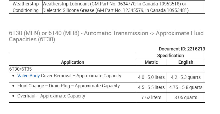

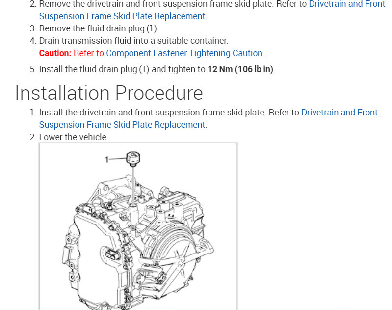

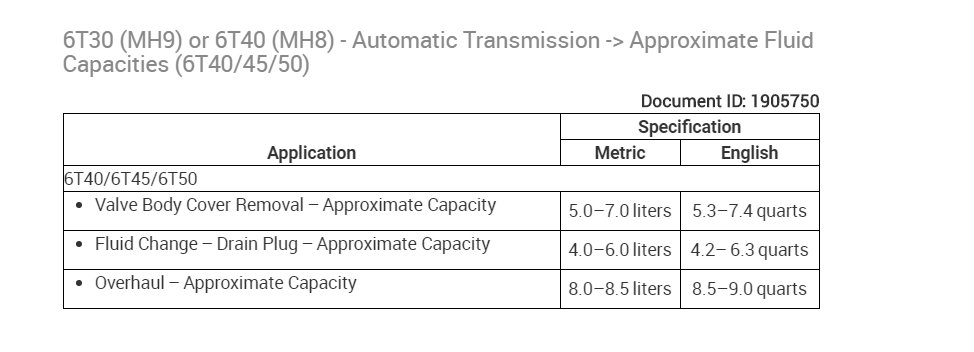

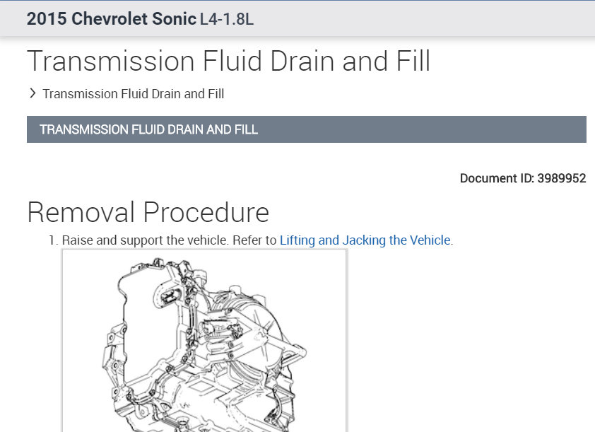

I need to know the capacity of the transmission. I want to change the transmission fluid.
Nov 15, 2019 at 8:04 AM
SCGRANTURISMO
  • 4,897 POSTS

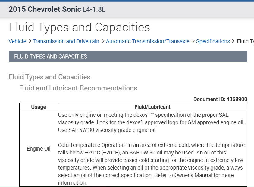

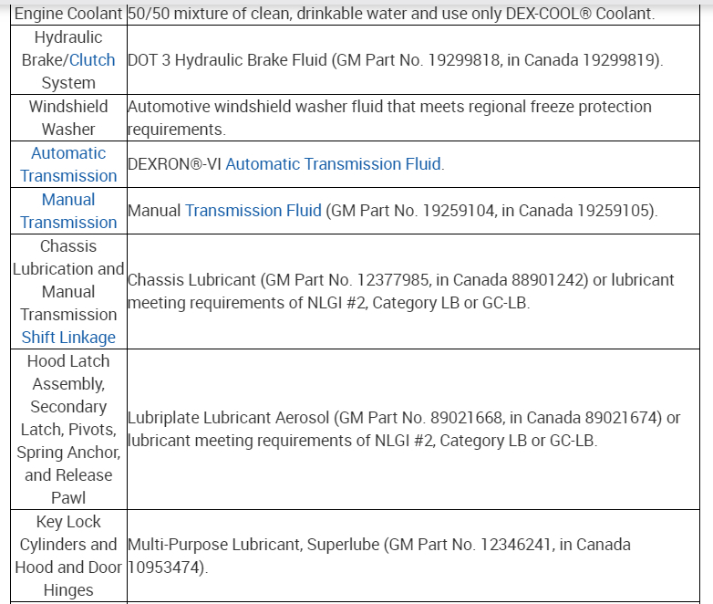

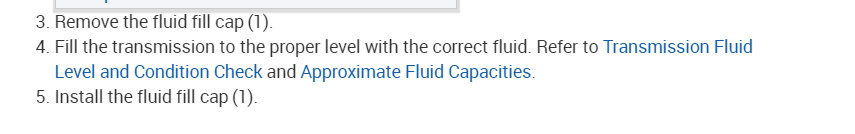

I have included the fluid type and capacities for all the fluids in your vehicle, as well as instructions on how to do a transmission fluid change for your vehicle. Please get back to us with how everything turns out. I hope this helps.
