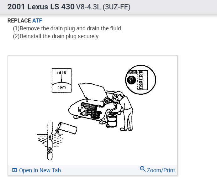

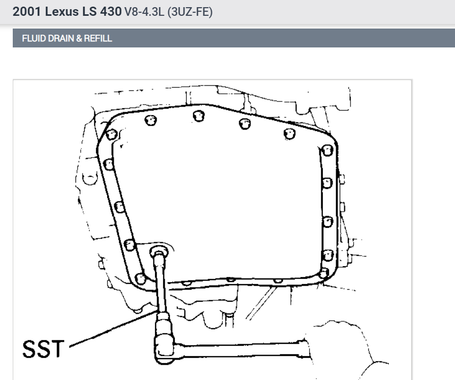

Nice work, this will help the transmission last for many miles. here is a generic guide to help you see what you are in for with the instructions for your car in the diagrams below. Also, I have included the fluid type as well.

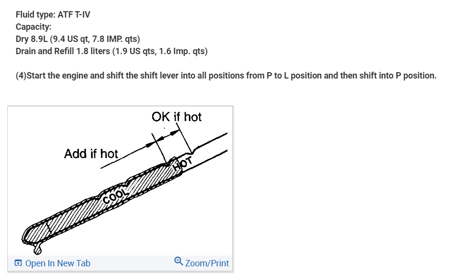

Fluid type: ATF T-IV
Capacity:
Dry 8.9L (9.4 US qt, 7.8 IMP. qts)
Drain and Refill 1.8 liters (1.9 US qts, 1.6 Imp. qts)
