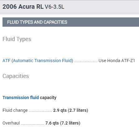

My transmission fluid registered very low on
the dipstick. How much fluid should I put in?
I've read so much about not overfilling it that
I don't think I've put enough in. I keep adding
fluid. There doesn't appear to be a leak, and
there isn't a visible puddle where I park. I am
worried I will overfill it, if I continue to add it.
What do you suggest?
Jul 1, 2019 at 3:50 AM
DANNY L
  • 5,648 POSTS
Hello, I'm Danny.
Here is a tutorial showing how to change/service automatic transmission fluid:

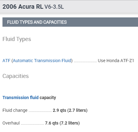

As far as the capacity, I've attached a picture below.Hope this helps and thanks for using 2CarPros.
