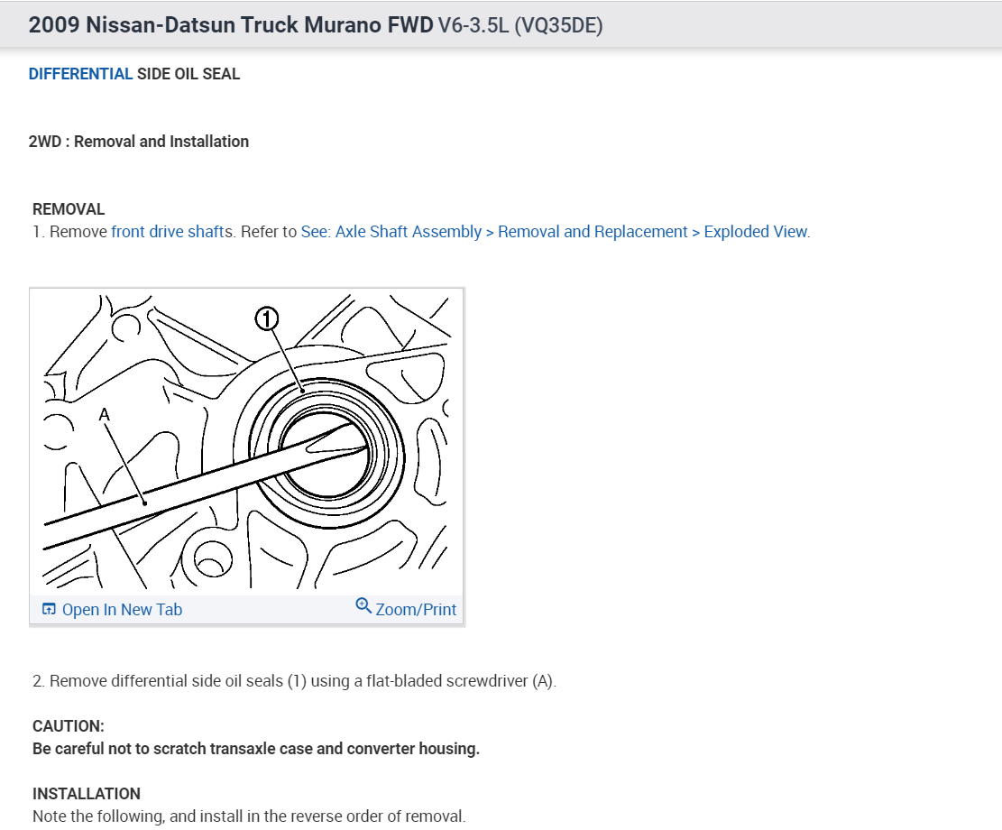

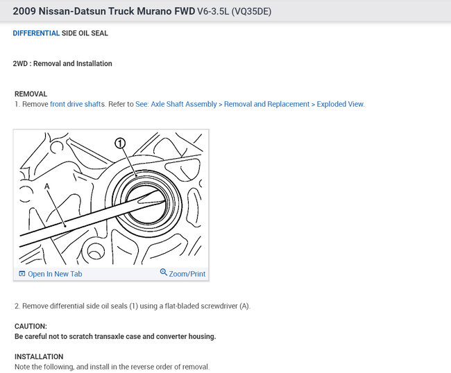

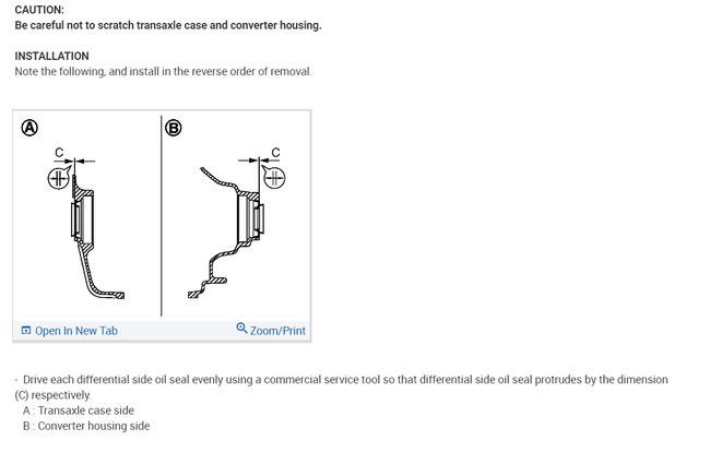

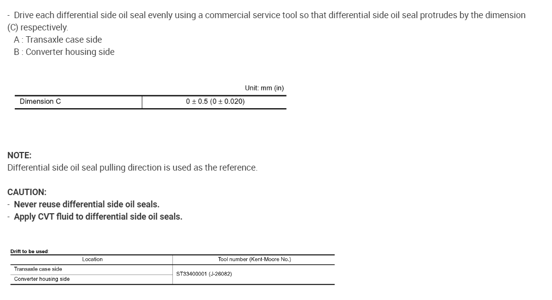

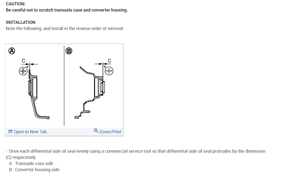

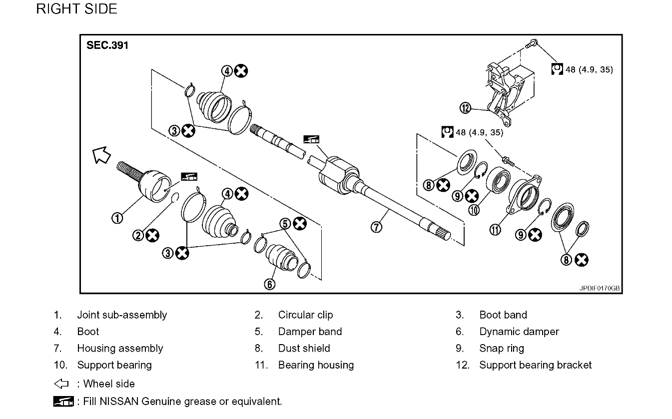

It sounds like the seal is not in correctly or the CV axle is not all the way installed into the transaxle. If you can upload a video or picture of the leak, I can tell for sure. Here are the instructions for replacing the CV axle and seal. Make sure you don't damage the seal upon installation. Check out the diagrams (below). Please let us know what happens.

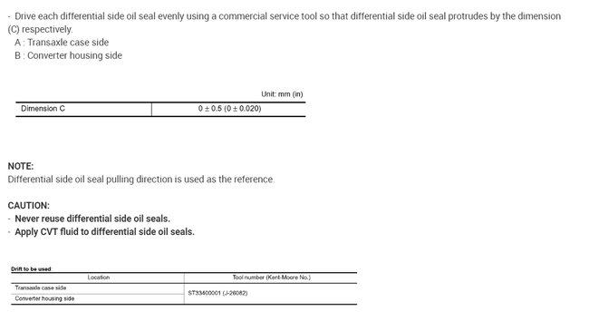

This seal is a beast, but it came out easier than going back in and I've had to get a new seal 3 times because when putting it back in the outer rubber part rips. Is there a tool i can get to keep it from ripping when i put it back in? As for it not being in all the way would i be able to put it all back together wheel and all. If it's not I will do a video shortly to show you, but i think you have been helping me with a lot of the issues i have had with this truck.

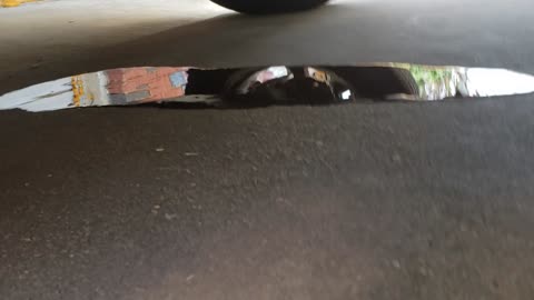

Here's the best video i can get with this phone. It is worse if it's jacked up though.
Jul 28, 2022 at 1:08 PM

Thanks for the video. Yep, do not run the car anymore. Can you tell if the CV axle is installed completely because with a leak that size it seems like it is not all the way in?

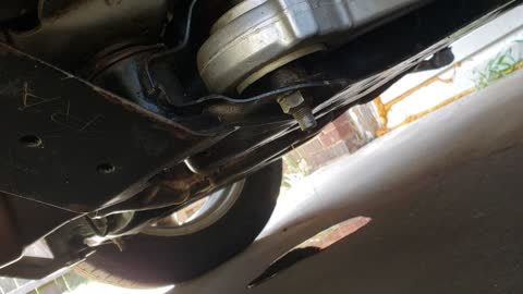

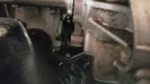

Here's a couple videos:
Jul 31, 2022 at 1:37 PM
Sorry, the video does not show the axle but for a split seconds but from what I could see it is not installed completely. I would remove the axle and adjust the "C" clip so it is not so tight, also you can use grease to help center the clip when you installing the axle. This clip is what holds the axle out from being installed completely.

Sorry, your car does not have a C clip so no worries there. You could have the wrong axle though (too short) I would match it to the old unit once you have it out. There is no tool that can help you install the axle into the seal, use motor oil to lubricate it and gently install it.
