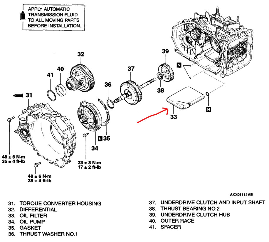

The filter is inside the transmission which cannot be changed unless you take the transmission part. Please check out the images below to see what I am talking about.
