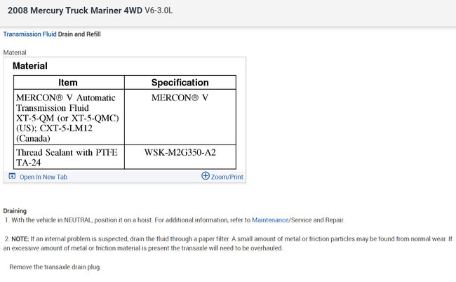

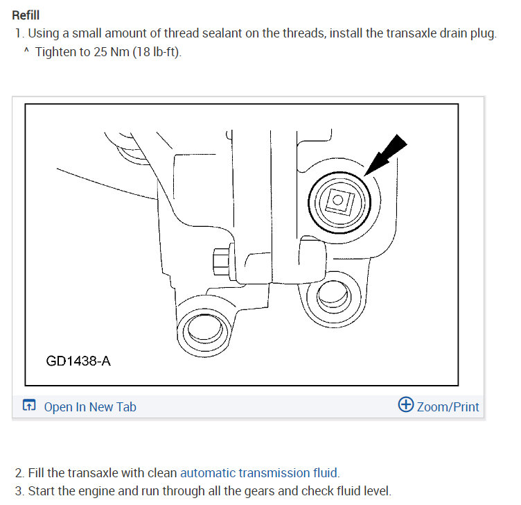

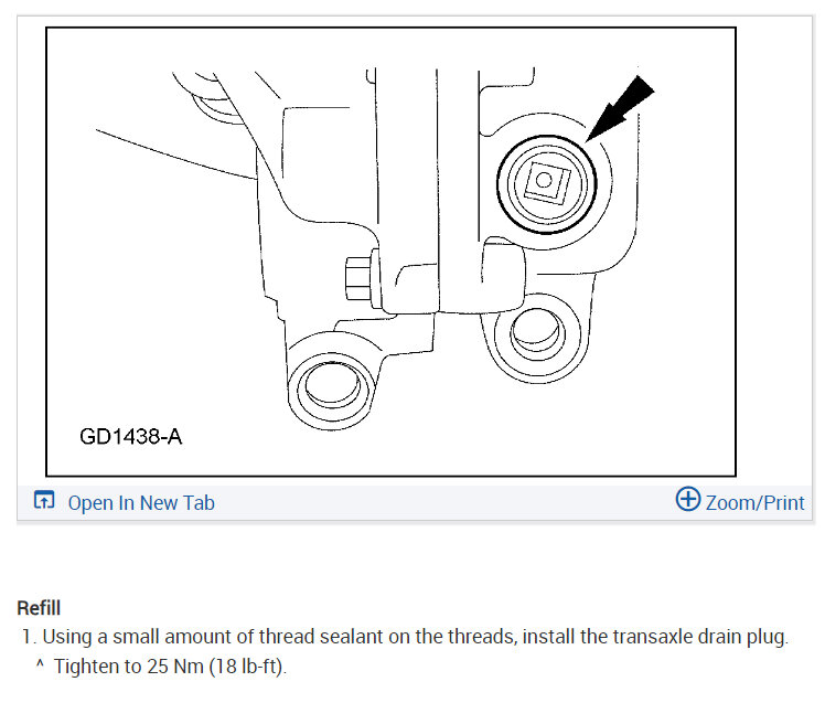

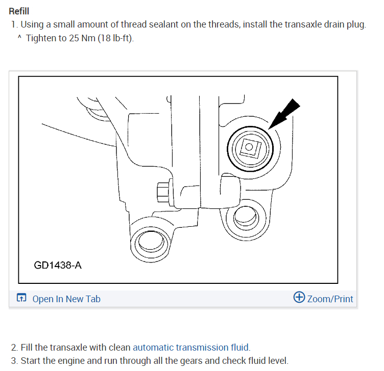

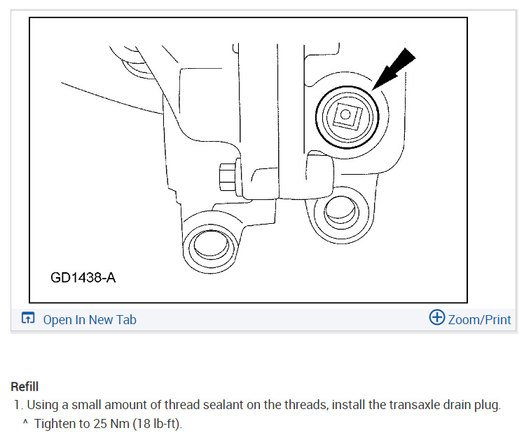

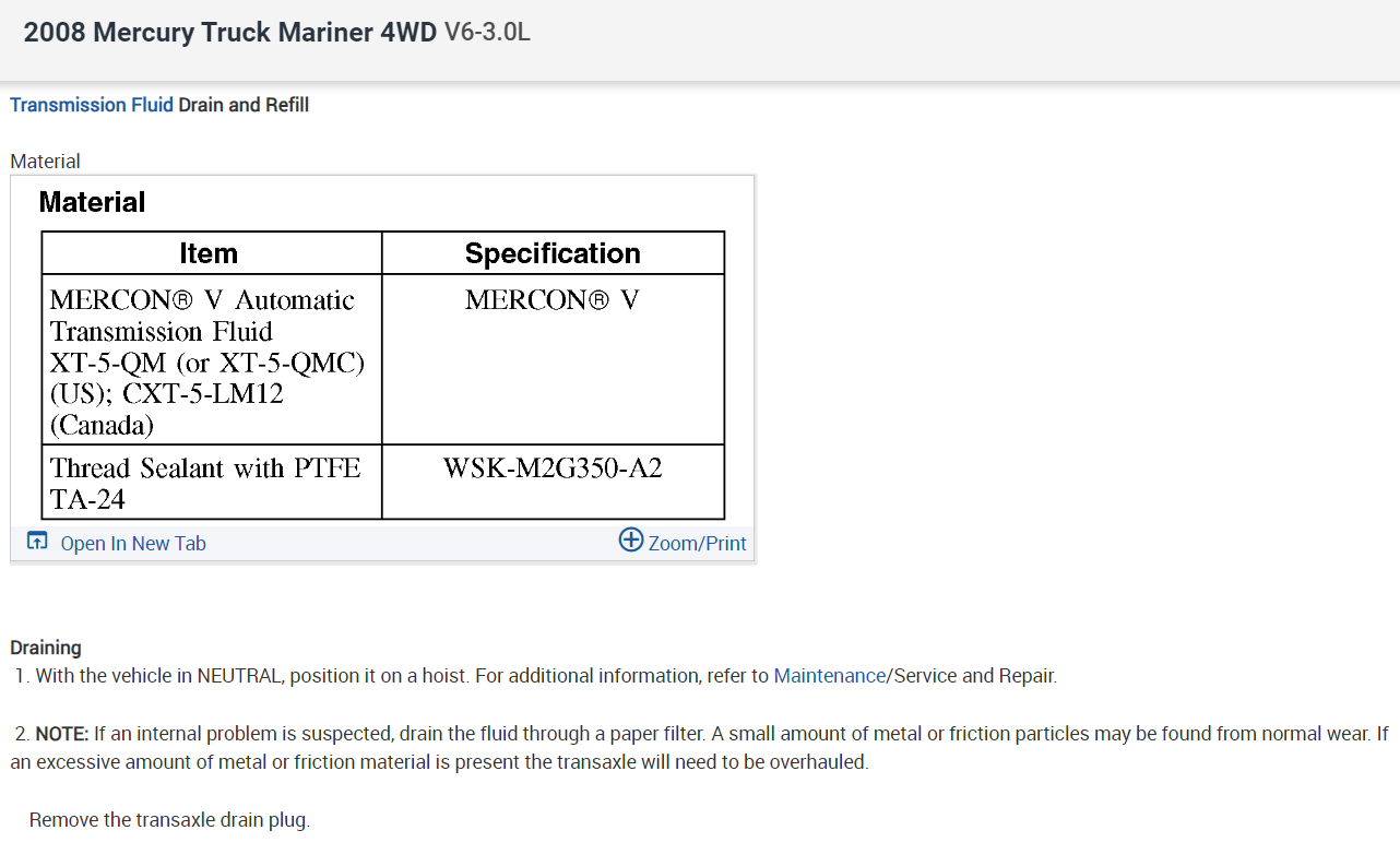

This transmission has a fluid screen not a filter which is non serviceable, so it is known as a dump and fill. Here is a guide to help you step by step with instructions in the images below for your car:
Ford Part Name
- Mercon V Automatic Transmission Fluid
Ford Part Number
- XT-5-QM
- XT-5-QMC (US)
- CXT-5-LM12 (Canada)
Ford Specification
- MERCON V
Note: Using any transmission fluid other than those that meet the recommended specification may cause internal transmission damage. Check out the images (below). Let us know what you find.
