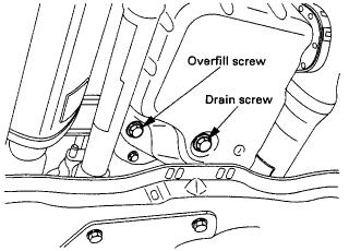

The issue is that your vehicle uses a "sealed for life" transmission. Real stupid idea but they thought it was great.
To do a fluid change, no filter in the transmission just a screen.
Place a large drain pan under the transmission pan.
Remove the transmission oil drain screw and drain fluid.
Tighten drain screw to 38 Nm (28 ft. lbs.)
Accurately measure the amount of fluid you removed from the transmission.
Remove the transmission overfill screw and fill transmission through overfill screw opening, using DEXRON III ATF.
Add transmission fluid until you have added in the amount that you removed.
Tighten overfill screw to 38 Nm (28 ft. lbs.)
IF you have a scan tool that can read the transmission temperature :
Let engine idle until a fluid temperature between 32°C (90°F) and 57°C (135°F) is reached.
Add transmission fluid until it flows out over the overfill screw opening.
Tighten the overfill screw to 38 Nm (28 ft. lbs.)
