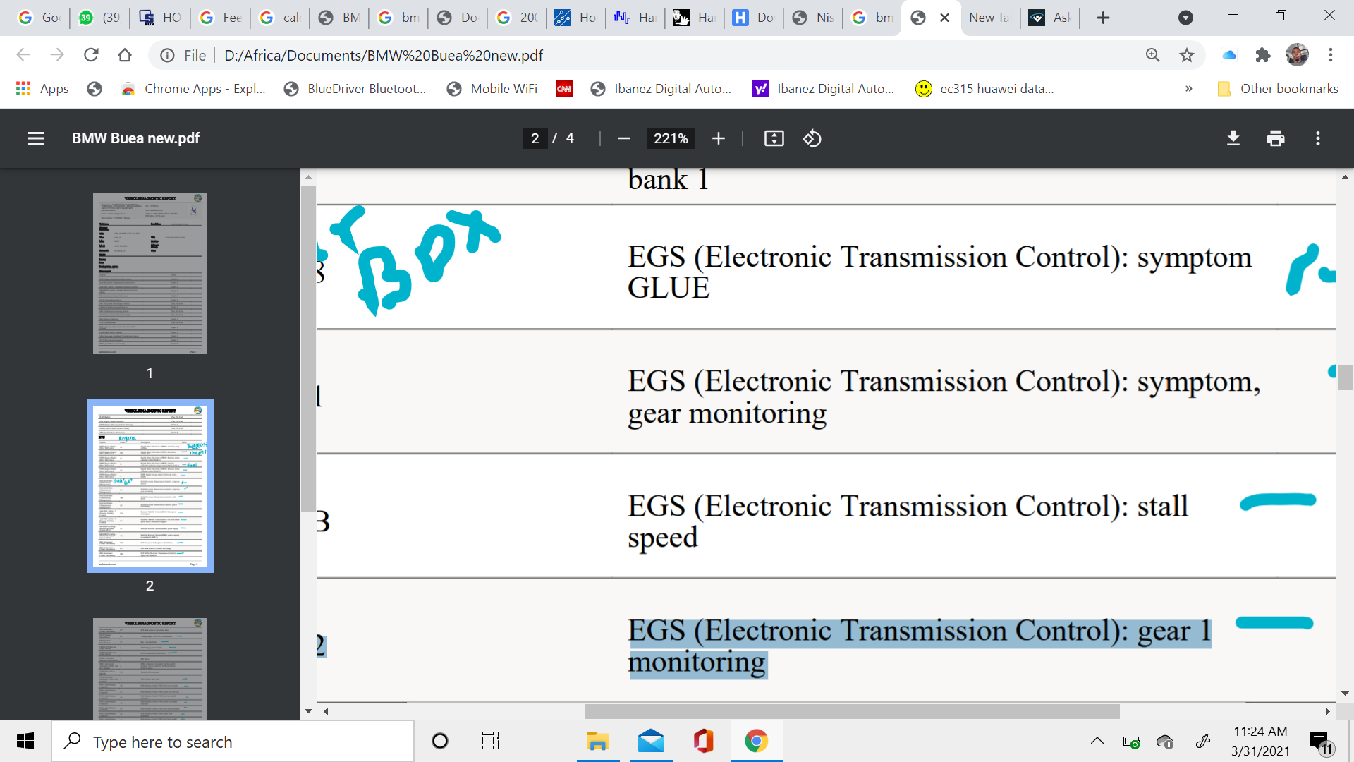

32 EGS (Electronic Transmission Control): gear 1
monitoring

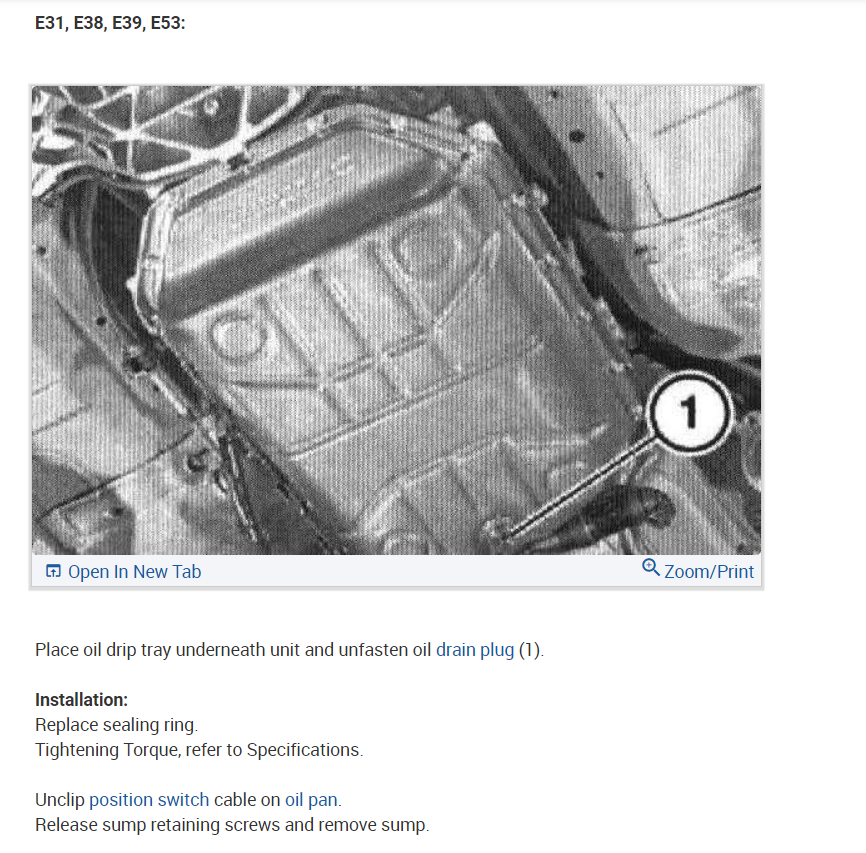

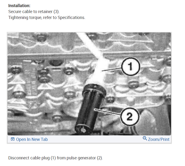

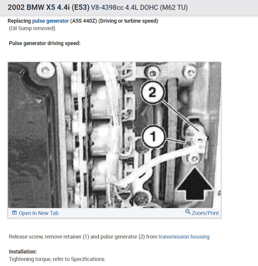

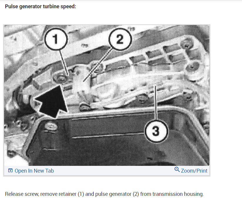

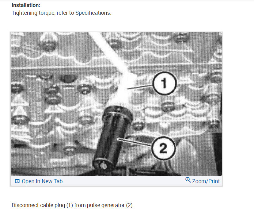

This happens when the turbine speed sensor goes out. here is how to replace the sensor in the diagrams below. Check out the diagrams (below). Let us know what happens and please upload pictures or videos of the problem.

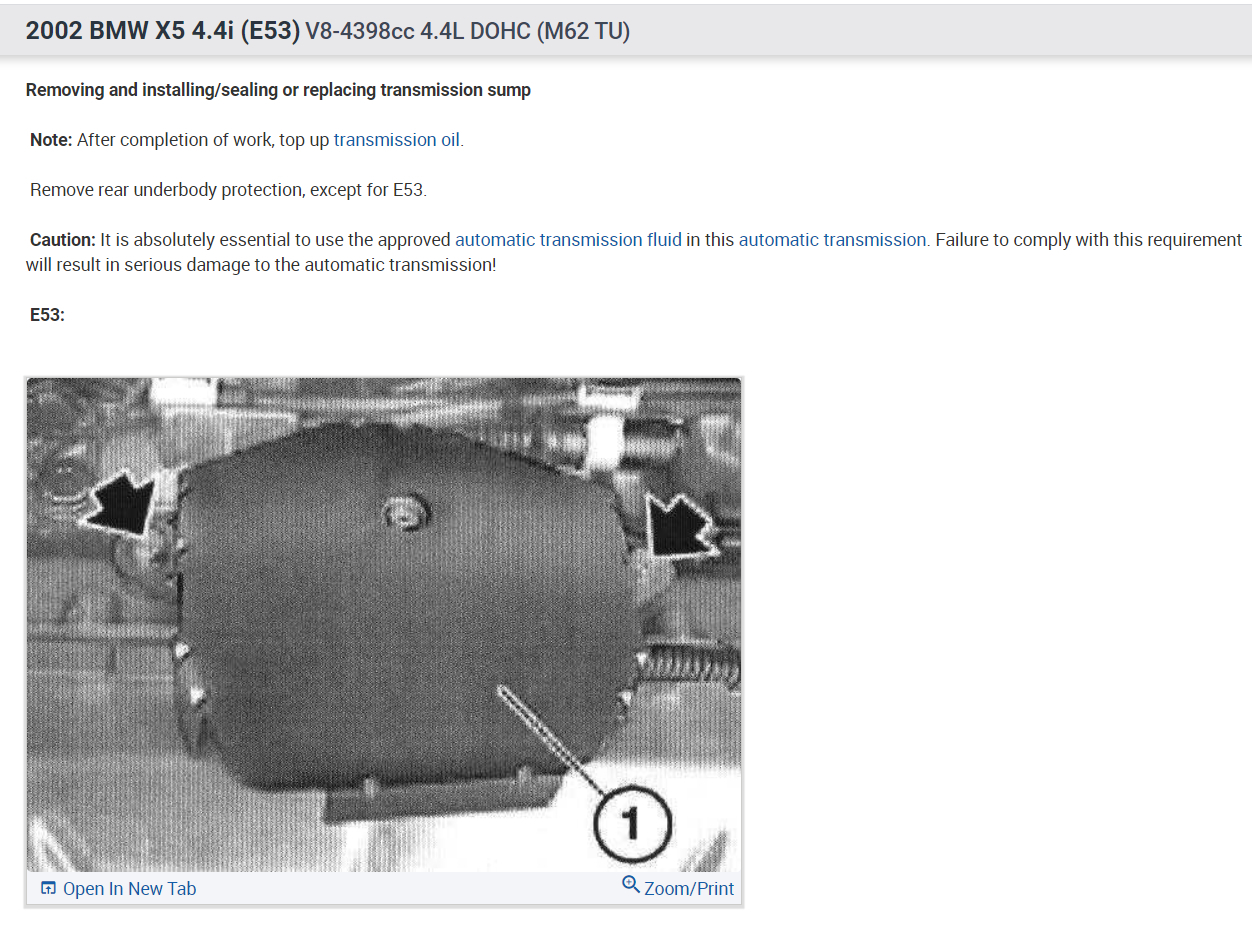

Do i have to open the cover and empty the transmission fluid to get to it, or its just fitted on the outside of the gear box?
Apr 2, 2021 at 9:45 AM

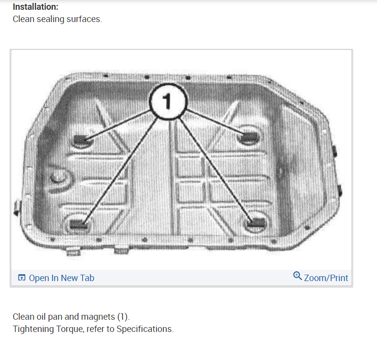

Yes, you need to remove the transmission pan. here are instructions to help you get the job done. Check out the diagrams (below). Please let us know what happens.

Hi Ken, i got the transmission cover removed. I can see two turbine sensors at both ends opposite to each other. How can i test the sensors to know which is malfunctioning? Can i also interchange them?
Apr 5, 2021 at 4:00 PM
ANDRIN ATEM
  • 393 POSTS
Hi Ken. I got both sensors out and i did a resistance test with a voltage meter. On one i got 3.50 oms and the second i got 3.33 oms. I also did live data on output speed i realize the sensor with the 3.33 omes does not transmit as that of 3.50, while i hook the sensors with my ignition key open i had another mechanic using a screwdriver to touch the metal part on the sensors.
Apr 6, 2021 at 6:35 AM
sounds good let me know what happens once you have it back together.

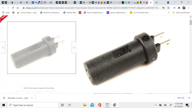

Hi Ken, please this is the part which i took out from the gearbox based on the images you sent. i hope this is what the turbine output speed sensor looks like?
Apr 12, 2021 at 12:32 AM
That's it. let me know how it goes.
