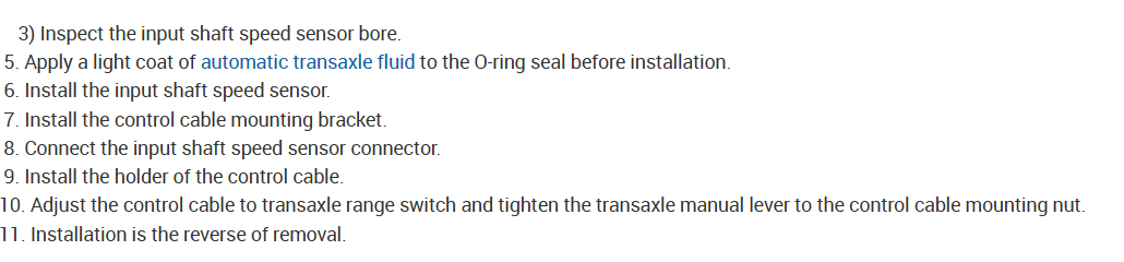

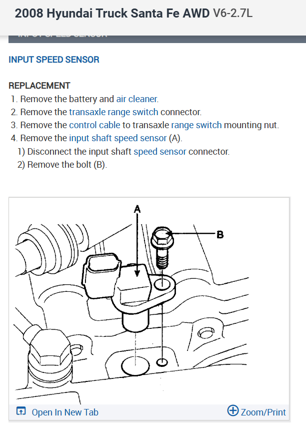

Does the engine seem to have good power? Because a clogged catalytic converter will cause this issue, and I have seen a weak input shaft speed sensor cause this problem as well. Here is the location of the sensor in case a code is stored for it. Check out the images (below). Please let us know what happens.
