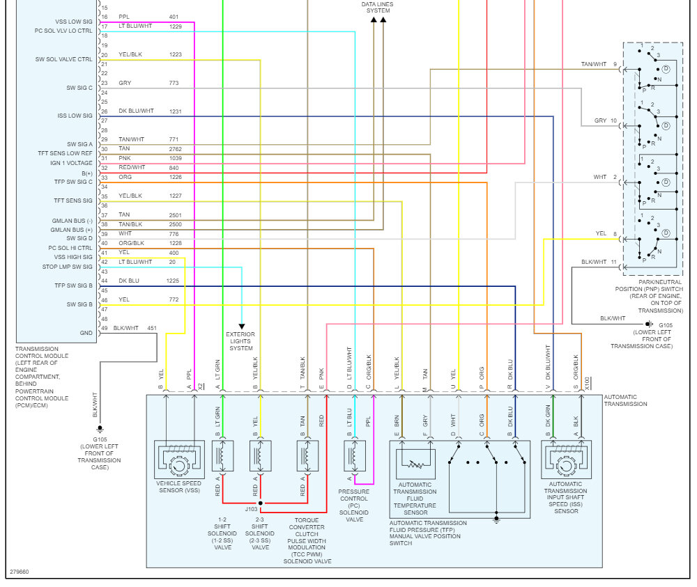

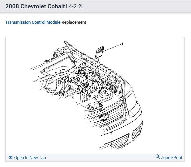

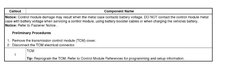

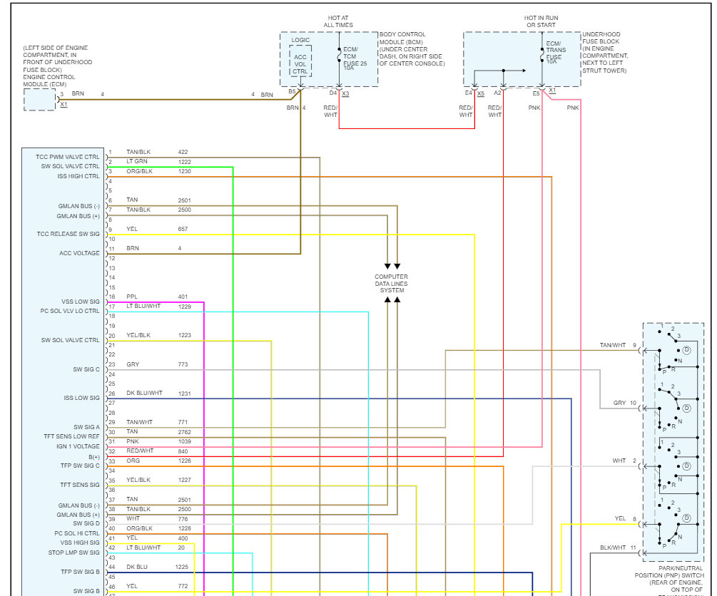

This sounds like the TCM needs to be replaced or the grounds are bad, you can get a preprogrammed unit by searching Google or Ebay. Here is how the job is done. Here is a guide to help you test the grounds and the TCM wiring diagrams below so you can see which wires to test:
