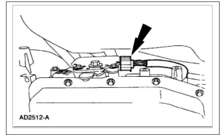

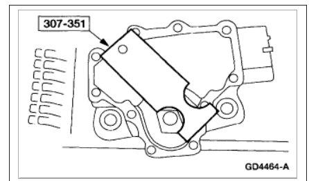

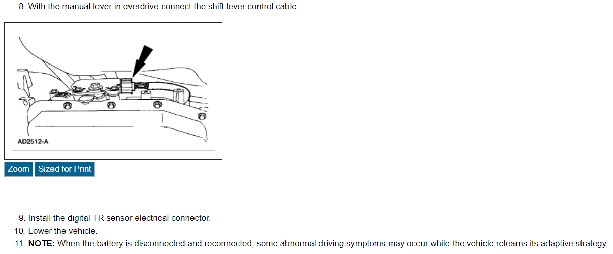

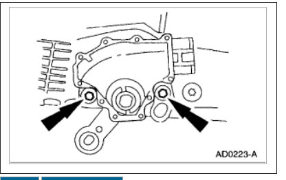

Can I ask if the reverse lights work? If not it sounds like the transmission range sensor has gone out. Here is the location so you can change it out.

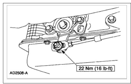

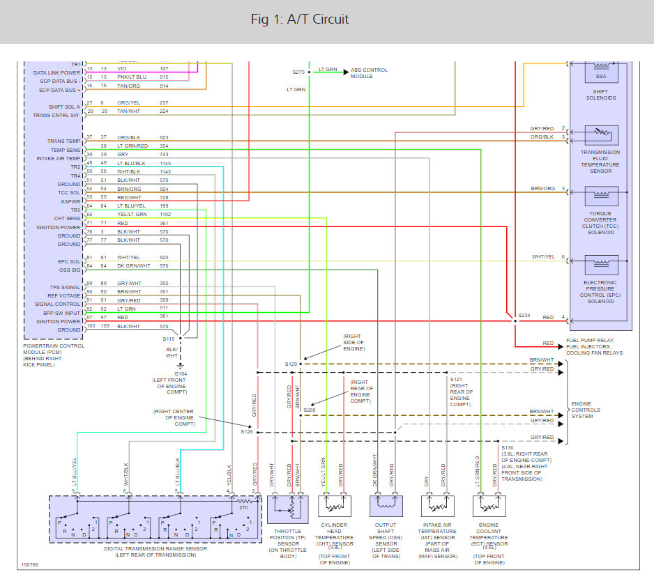

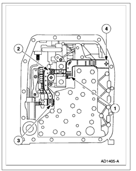

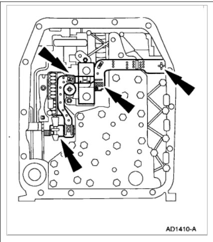

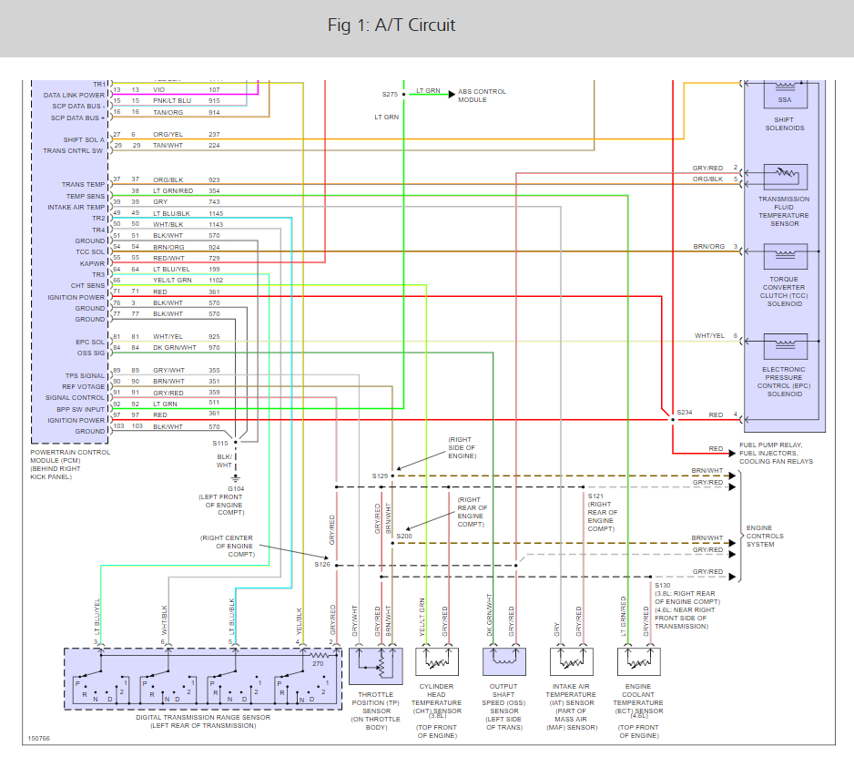

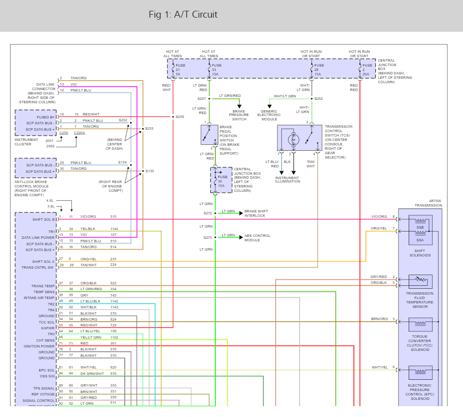

Okay, the next place I would look is the shift solenoid to test the signal from the PCM you will need to tap into the wire using a test light. Here is the transmission wiring guide on how to use a test light and the solenoid location:
and
