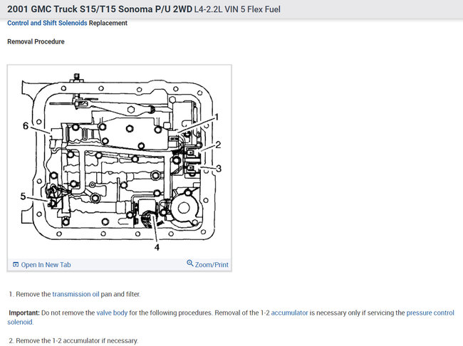

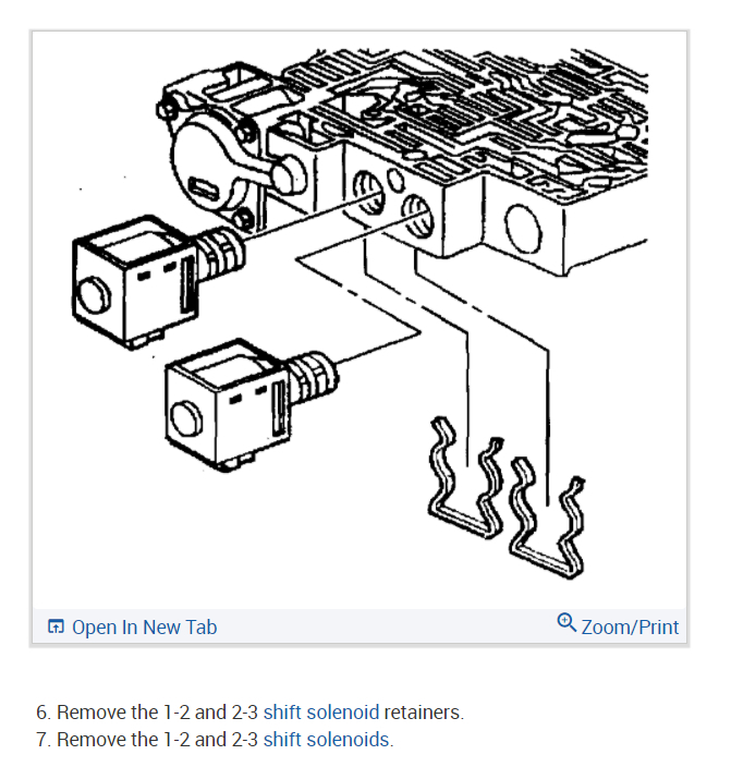

hi, i have a problem with my transmission not shifting out of first gear. i changed the speed sensor and all four solenoids. i changed out the transmission fluid too, but still not shifting. so with that all being said what could cause the problem?

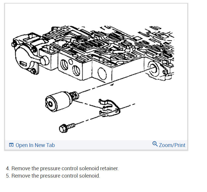

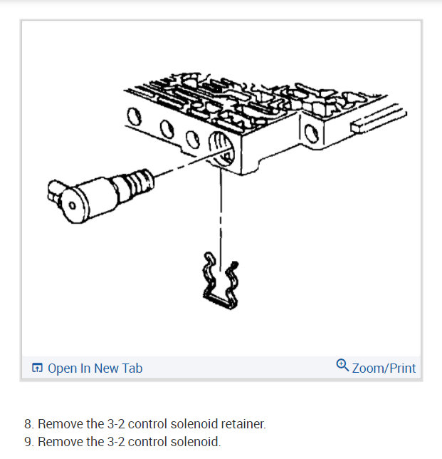

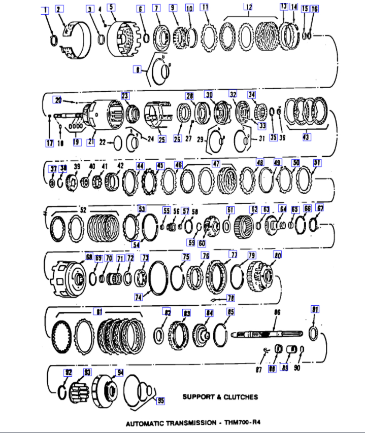

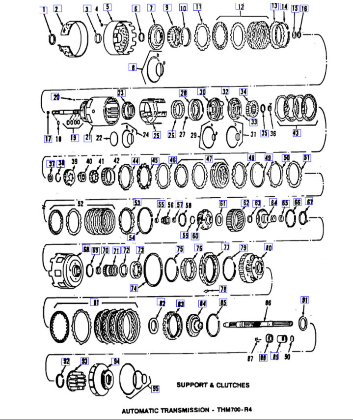

I just rebuilt my transmission put in a new third and fourth clutch pack. replaced the third fourth piston seal and all the seals checked the sunshell it was fine but replaced it anyway. put it all back together shifts into third but I have to let go of the gas to get it to shift and seems it is losing pressure and slips back out. I don't know what is going on. any help would be appreciated!

Do you have any check engine lights on? if so this guide can help us. also when you did the repair did you get the seals in correctly for the servo and drums? Check out the diagrams below to help reinstall the seals.
and
https://www.2carpros.com/articles/automatic-transmission-problems
Dec 28, 2020 at 10:10 AM (Merged)

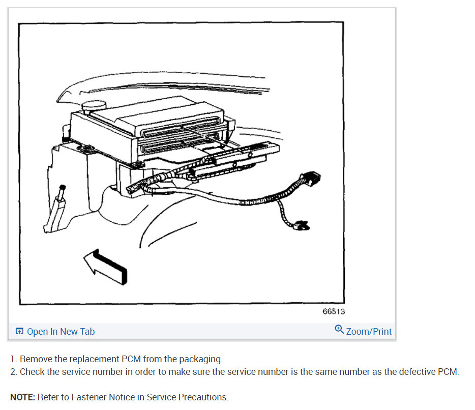

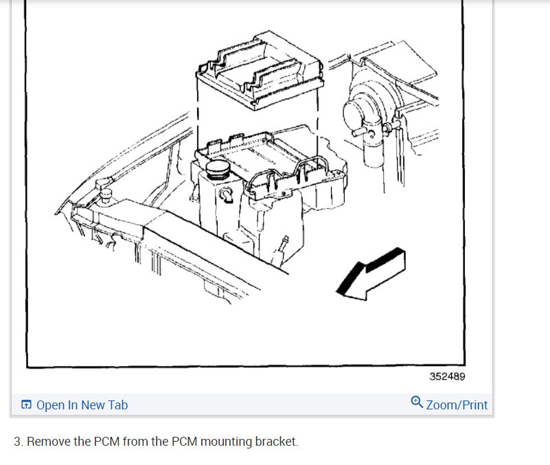

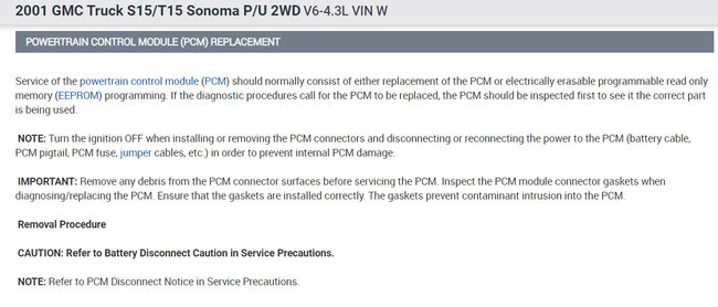

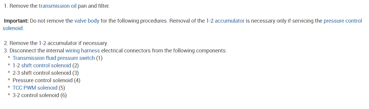

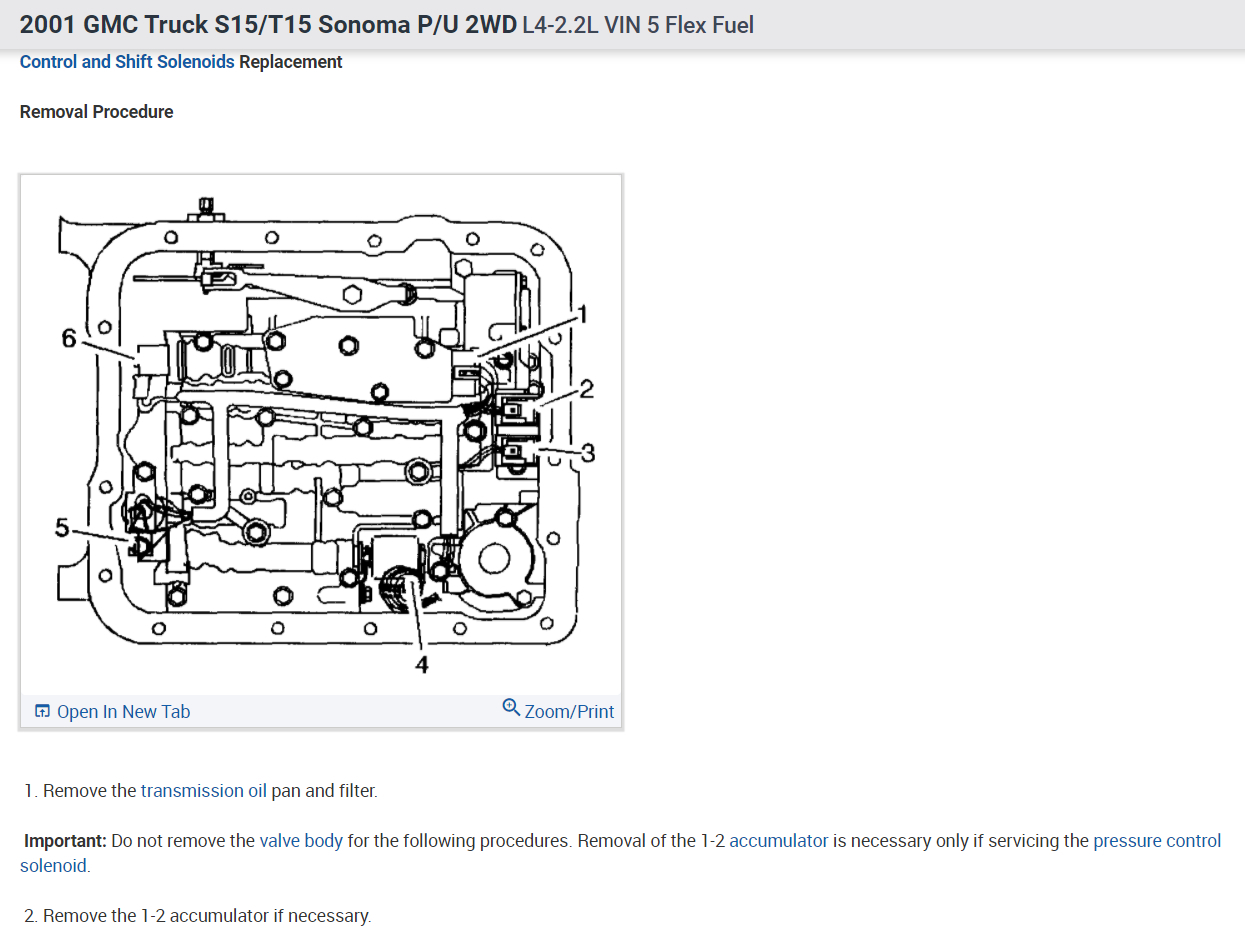

Okay, all three codes are related to wiring harness issues as they all are saying the PCM is seeing high voltage on the returns from the solenoids. The most likely issue here is a short in the harness. the harness in the pan is common. it is submerged in fluid and over the years it gets into the wiring and shorts out.
Since you replaced all the solenoids, the only thing left is the wiring harness.
You will need to drop the pan again and check the harness closely for any breaks or melted wires.

Yeah, I got it all in correctly. I followed a step by step video and bought all the right tools. I took my time. I'm replacing the speed sensor now. the only other thing I can think of is the 2-3 shift solenoid, I don't know.

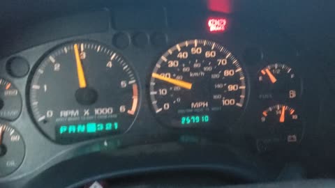

Hard to tell, but that's what it's doing. it will go into the gear but have to let off the gas then it wants to downshift again . but once its in gear and i'm going 40 it will usually stay in 3rd but won't go into 4th. Don't mind the brake light that's my next project, lol.
Thanks for the video. yep, it is not shifting. can I ask did it do this before you did the repair? if so I would try a replacement PCM because if it were a connection problem you would would have a code that pertained to it. Here are the instructions. Check out the diagrams (below). Please let us know what happens.

It was kind of but when I rebuilt the transmission the third and fourth clutches were toast and the seals were bad. I will check into the PCM. though is there a way to just reset it and see if that works? I don't have a ton of money to just throw at this truck and see what happens, lol.

I would go back through the transmission then it sounds like you might have folded a lip seal or forgot an o ring. Let us know what happens and please upload pictures or videos of the problem.
