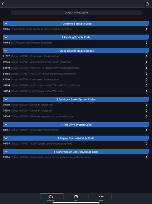

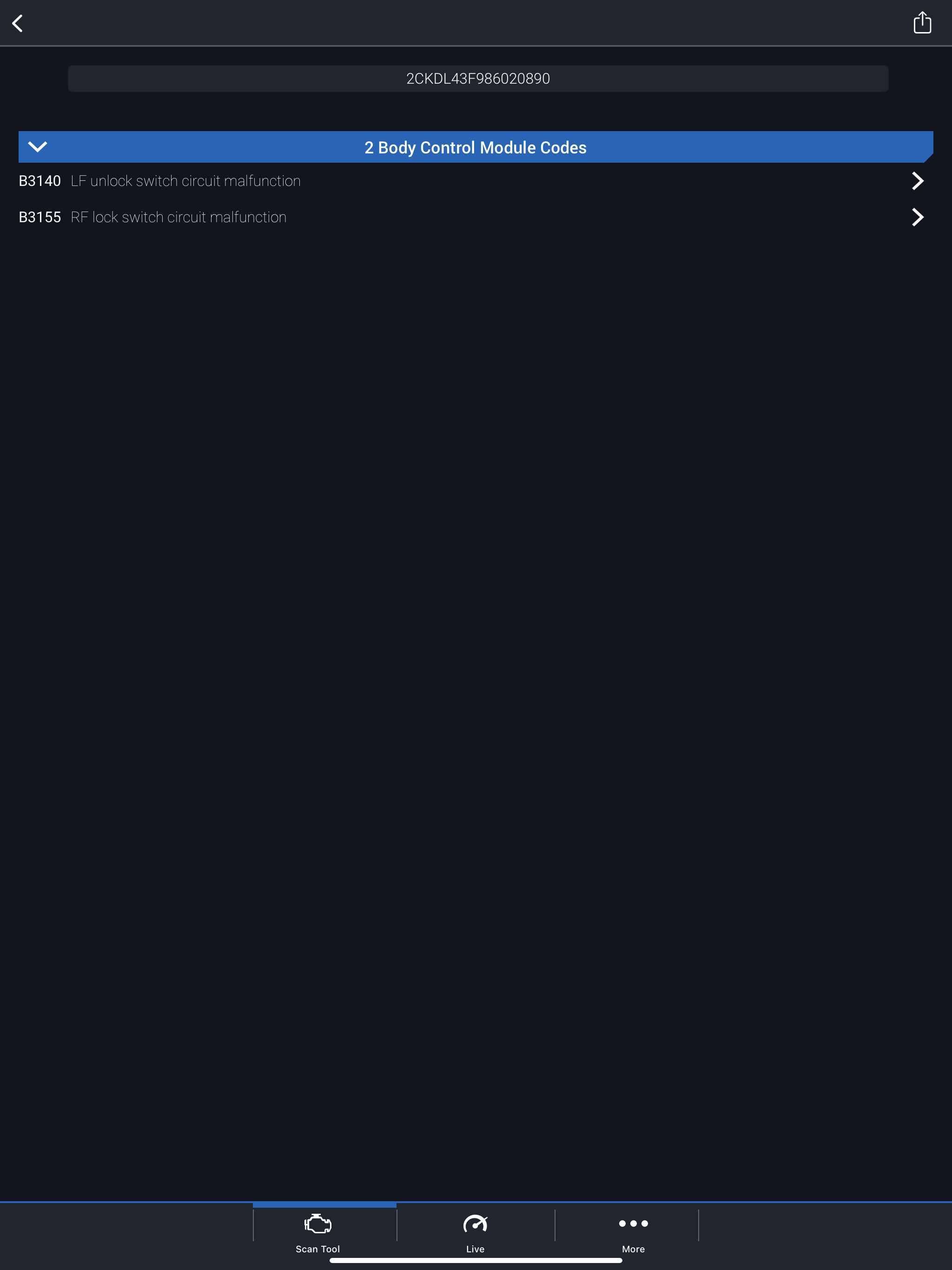

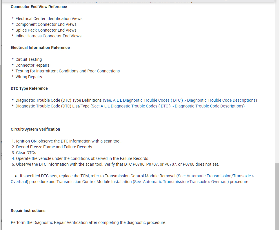

I have the car listed above (base). The car seems fine overall except the transmission does not engage. The gear shift moves fine, but the car does not go in either forward or reverse. I ran a new scan on the ODB and it gives me two codes for door locks. No transmission error codes at all.Engine is strong. Before clearing the prior codes I ran an OBD scan, which reported a lot more. I cleared the original scan as the car had been sitting for a couple of years.
