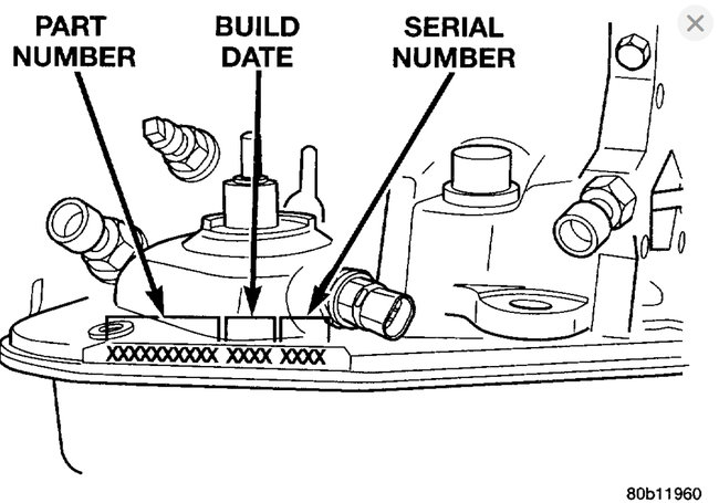

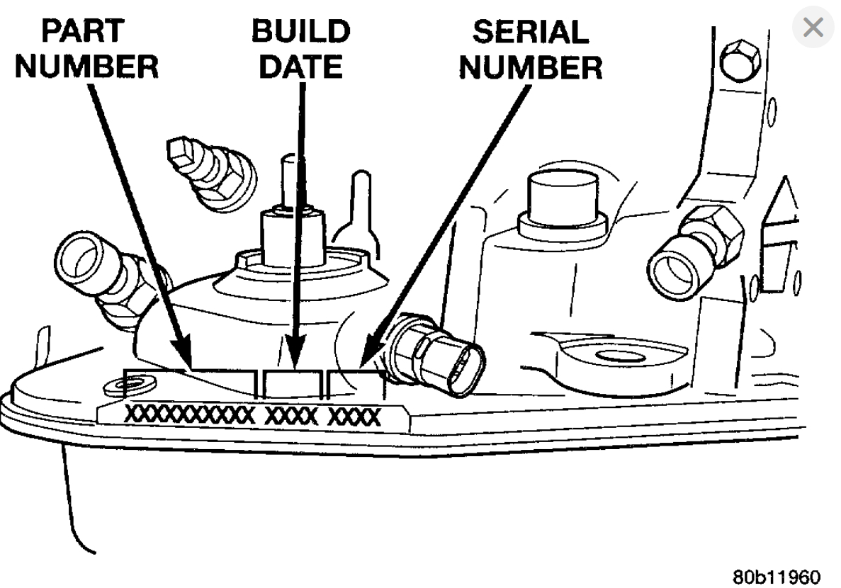

Transmission identification numbers are stamped on the left side of the case just above the oil pan gasket surface.
