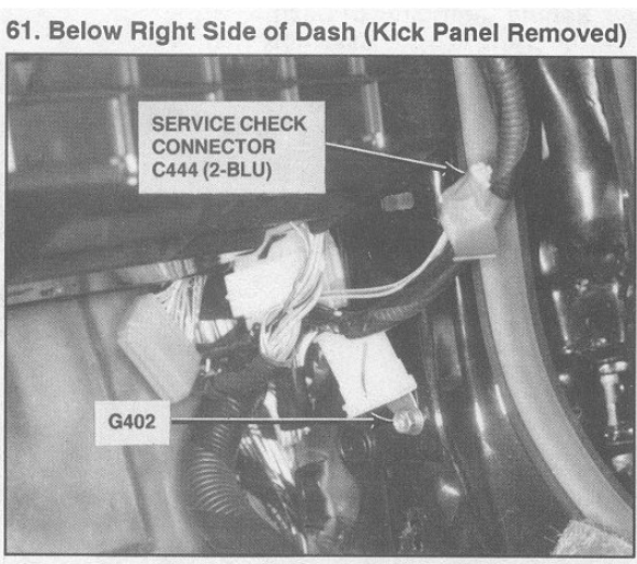

It definitely sounds like there will be a transmission code stored in you cars computer with this type of condition. The data link connector is located behind the right side foot well kick panel. Here is a tutorial for checking obd1 codes for your car to view:
https://www.2carpros.com/articles/honda-car-1990-1995-obd1-code-retrieval-procedure-and-definition-table
I've attached a picture below of the data link connector for your car. After performing this get back to us with the code information and we'll go from there to diagnose the issue. Hope this helps and thanks for using 2CarPros.
