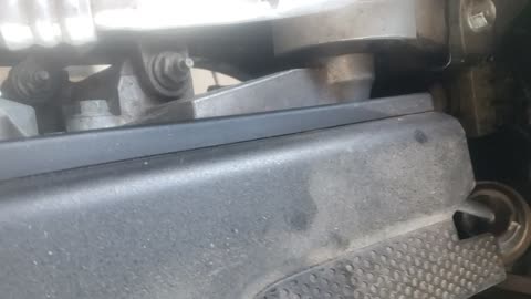

I changed my transmission mount and afterwards i started it to see how it did and coolant was streaming out from underneath it. so, i got under it and can't see where its coming from exactly but it's somewhere by the transmission as for the shifting its doing this just fine in all gears however it's not accelerating passed maybe 10 MPH and revving from 1 to 2 the reason the 2 are combined is because they both became issues while trying to fix the loss of acceleration and RPM issues.

Okay. I understand a little better. They may be related in the fact that they happened at the same time but that doesn't mean that they are being caused by the same thing.
So that means we should attack the coolant leak and solve that and then we can get into the transmission issue.
So, take a look at the guide I attached here again, and we need to pressure test the system which will cause the leak to start dripping.
At which point we can start to pinpoint it by looking for the source of it with the engine off and not hot.
https://www.2carpros.com/articles/radiator-pressure-test
Let me know what you find with this and then we can go from there. Thanks

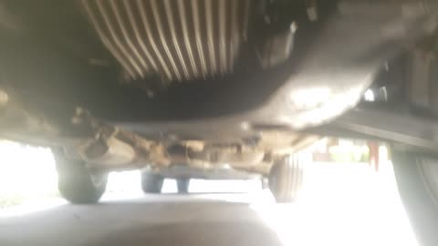

It is not possible to see where it is exactly coming from unless i remove the transmission pan meaning redraining all my fluid because its coming from inside of that area, and mind it was not leaking any coolant at all ever before i placed the jack underneath the transmission pan to replace the mount. which is why I'm saying i had to of pinched or pierced a hole in the transmission cooler line on the inside. I've already returned the $200.00 test kit to Orielly's because i saw it coming from the same area as it was when it was started the first time after changing the mount. so, what and how exactly do i take a picture if i can't see inside of the pan?

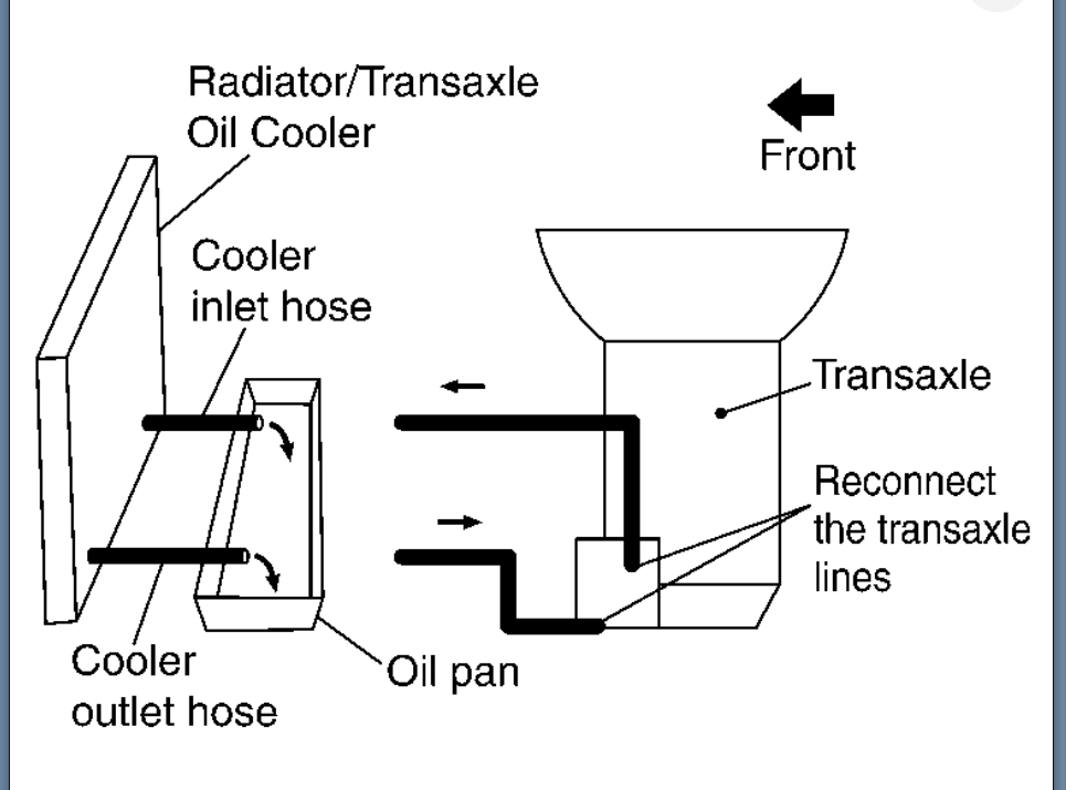

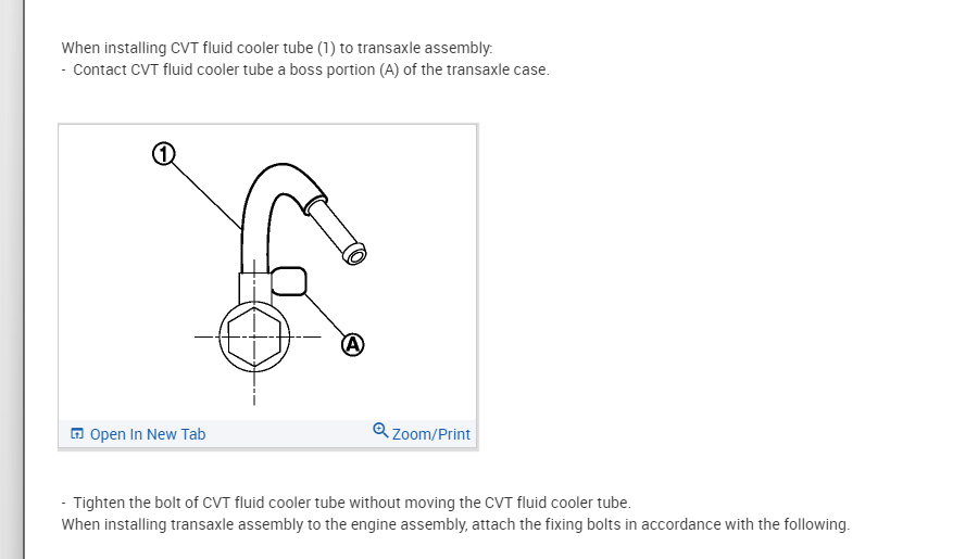

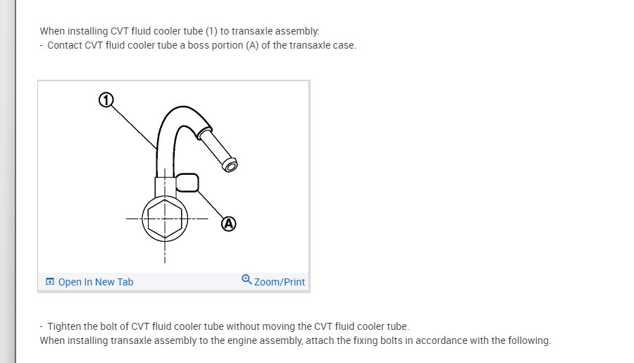

Okay. Is it leaking transmission fluid or is it leaking coolant? You said earlier that it was leaking coolant which is why I am confused why you are wanting info on the transmission oil cooler and saying that you pinched an oil cooler line. The oil cooler is part of the radiator in the front of the engine bay. I attached a diagram showing this.
So, if you pinched a transmission oil cooler line it would be leaking transmission oil.
So, if we have a coolant leak that is why we needed to pressure test it to locate where the leak is coming from.
Unfortunately, I just don't know where this coolant leak is coming from based on this info.

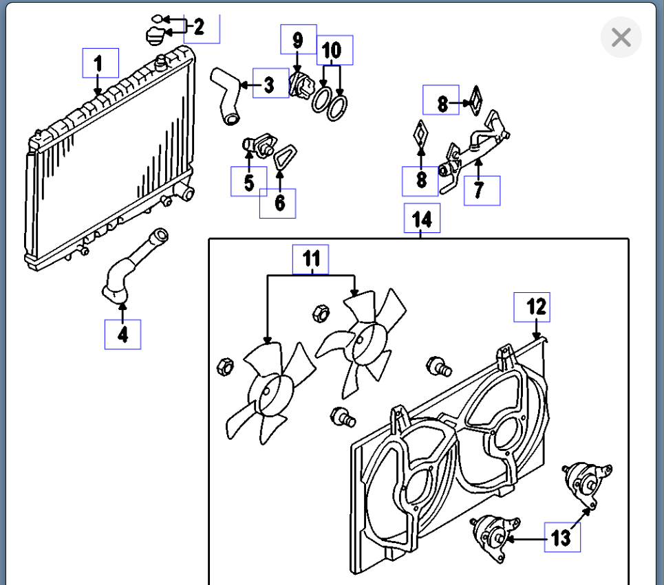

Also, the manual does not have repair procedures on just the cooler lines, or I would provide those as you are asking. Basically, the only thing is what I attached below which is not extremely helpful.
Thanks

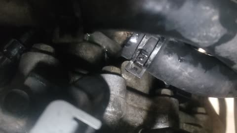

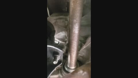

I understand you can't tell me where its leaking from and i got under it and with my hand followed it up as far as my hand could reach which isn't far as i have t-rex arms, lol but as i went upwards i noticed that where the CV axle goes into the tranny from the passenger side just at the entry had what looks to be fluid coming out of the entry is there a seal that may of came off there just curious anyways so i went a bit further up from that point on the back end of the transmission kind of and i don't see any coolant lines in the area. i will get under it and make a video and try to get a better view of it i did however read online about there being a coolant hose that supposedly runs under the manifold to the back of the air intake that can leak and make it seem as though its coming from the transmission area but isn't. it just puzzles me as to what i could of pinched that hi when i jacked it up to do the mount because it wasn't leaking any coolant at all before i changed it. so, i guess until i send the video if you have any thoughts or suggestions so far I'm open to them otherwise I will wait and see after the video, but i did do the pressure test and i couldn't see the leak location ether ttys.

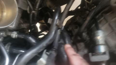

Okay. so, I'm put here on the truck and i took off the air intake and air filter box and found a puddle of antifreeze under it and on top of the transmission kind of that has hoses that connect to the throttle body in the video i included. I will try to talk loud and explain in the second video does this hose looks to be bulging to you or that they may be bad. however, i think that i may of hd the hoses that connect to the throttle body hooked up wrong do i switched them and will put it back together and lyk what i discovered but let me know on the hoses and video 2 on need to replace or not please.
Apr 23, 2022 at 10:21 AM
I don't see any abnormal bulging but the way to tell if a cooling line is failed is to squeeze it. If it is hard and does not feel like pliable rubber hoses, then it is dry rooted and will eventually fail.
As for the leak, you do have cooling lines running to the throttle body so if that is as high up as you are finding coolant leaking then this would be the place to inspect. I would put it back together and run the engine with the air intake off and just inspect all these lines when it is dripping.
