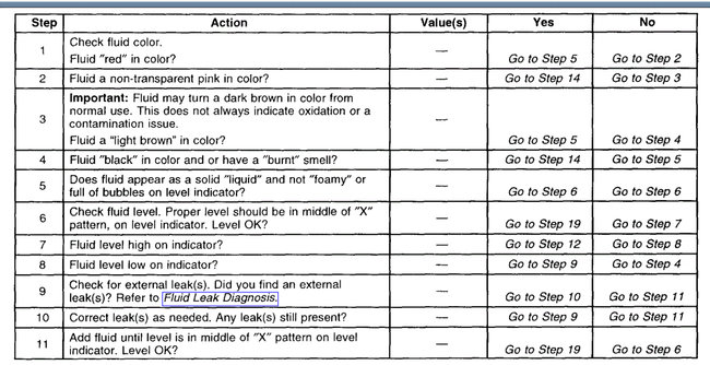

Did you check the level after you added the two quarts? If you haven't, start with that. When checking, the engine should be at operating temp, the engine running in park, and on a level surface. Take a look at pic 1 below. It explains things to look for.

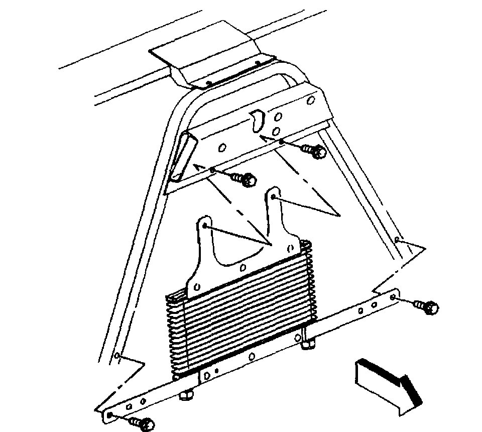

Removal Procedure

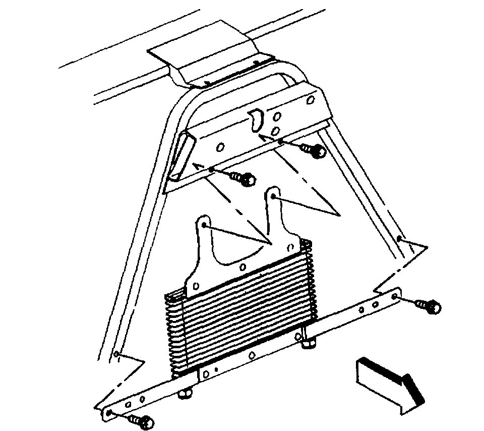

pic 2
1. Remove the two bolts securing the auxiliary oil cooler bracket to the radiator support.
2. Remove the auxiliary oil cooler from the radiator support.
Installation Procedure
Notice: Refer to Fastener Notice in Cations and Notices

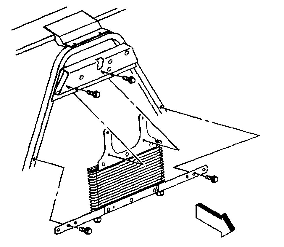

pic 3
1. Install the two bolts securing the oil cooler to the radiator support.
Tighten the bolts to 12 Nm (9 ft. lbs.).
2. Ensure the guide pin bolt is positioned into the support hole.

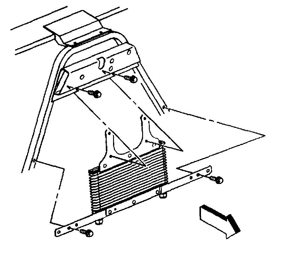

TRANSMISSION OIL COOLER REPLACEMENT
Removal Procedure

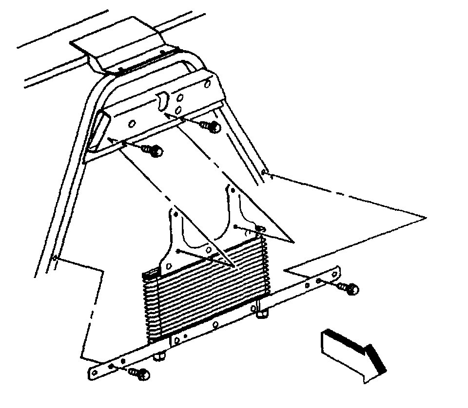

pic 4
1. Refer to grille assembly. Refer to Grille Replacement (Chevy) or Grille Replacement (GMC) in Body and Frame.
2. Remove the two nuts securing the two cooler lines to the oil cooler.
3. For vehicles not equipped with the 4.3L- engine, remove the four bolts securing the auxiliary oil cooler to the radiator support.

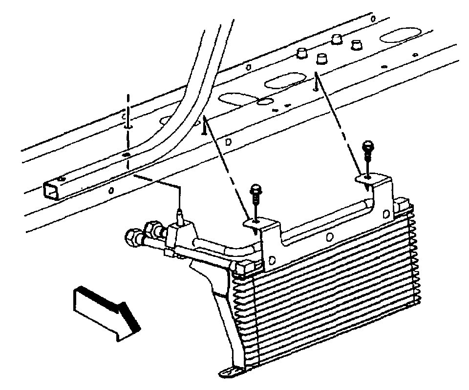

pic 5
4. For vehicles equipped with the 4.3LL engine, remove the four bolts securing the auxiliary oil cooler to the radiator support.

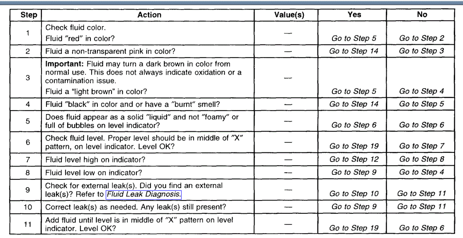

pic 6
1. For vehicles not equipped with the 4.3L engine, install the four bolts securing the oil cooler to the radiator support.
Tighten the bolts to 10 Nm (89 inch lbs.).
