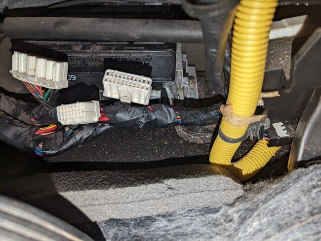

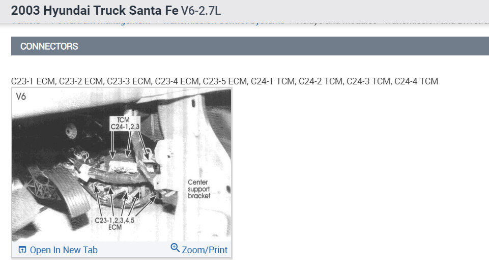

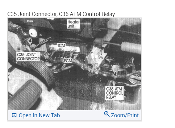

Sure, it looks like the TCM/PCM is by the throttle pedal here is the location in the images below. Please let us know if you need anything else to get the problem fixed. I would check the U joint is the driveshaft, transmission and engine mounts as well.

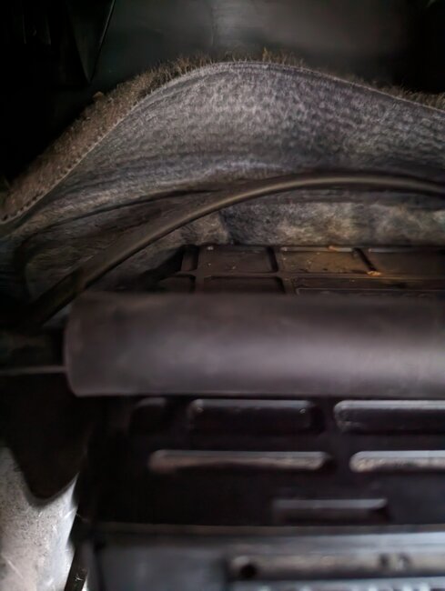

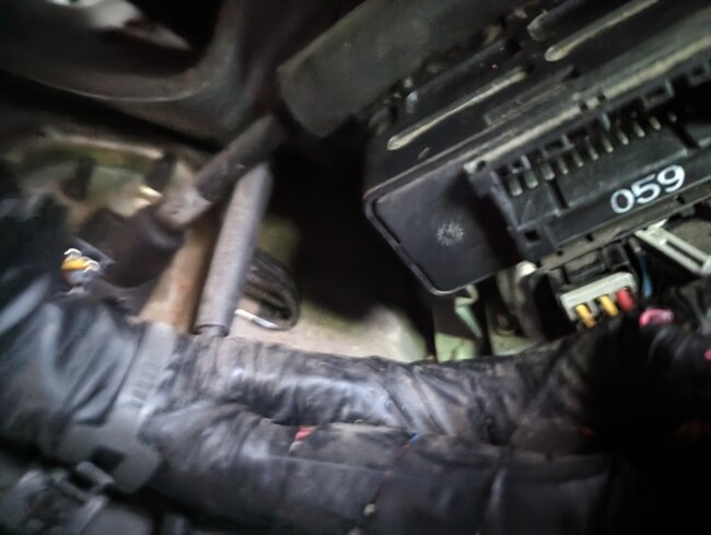

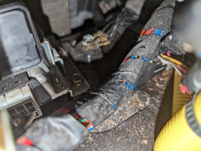

Here are photos of the transmission unit and bracket with the bolt on the right bracket. It looks like the unit has to slide up vertically but there is an insulated cable above the unit and it is secured tight in the bracket.
May 14, 2023 at 8:19 PM
Yep, it looks like it is close good job so far, it looks like there are 10mm bolts holding the bracket down, but can you slide the unit toward the gas pedal, there might be hold down clips? Let me know.

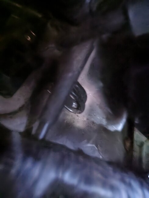

Hi again. Got the two bolts on the right side but can only lift the unit off the bracket on the right side. Can't see any bolts on the left side. The black insulated hose is tight on that side. Also, tried to pull it straight out towards the accelerator pedal but it has to be lifted off the right back remaining bolt. Only the nut came off. Could you send me a pic of any clips that may be holding it in on the left side? I really appreciate your assistance.
May 20, 2023 at 7:30 PM
Hi Miriam,
The images above all they show, can you access the TCM from the other side of the dash to see what's going on? Please upload images of what you see so I can help.

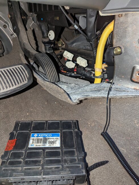

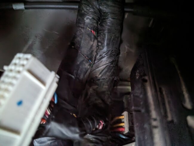

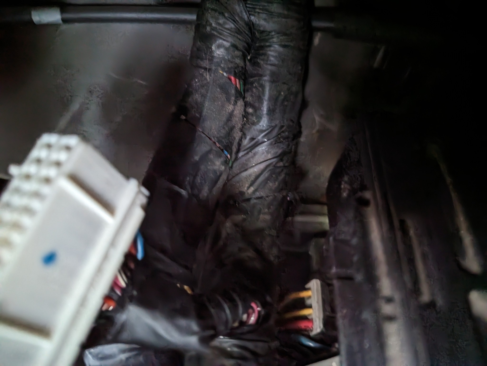

Sorry, don't know if these will help. The unit seems to be dislodged, but couldn't lift the left side up enough to move it out, towards the accelerator pedal. I felt around the left side, and it felt like there is a bolt in the front. Could that be holding the unit to the left. bracket?
May 21, 2023 at 2:28 PM
Yep, that looks like the PCM needs to come out first which is the box on the top of the TCM. Can you see how to remove it? There should be a clip or hold down bolt.

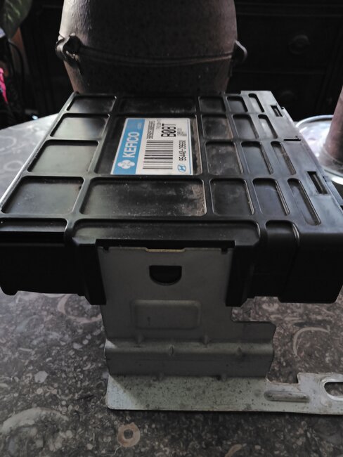

I finally got the nut off the front left bracket of the TCU. Couldn't get it out of the driver's side so removed the panel off the passenger side. Then I pushed the unit towards the pass. side and was able to jiggle it out from that side. Hurrah! Now, how do I get it off the brackets?

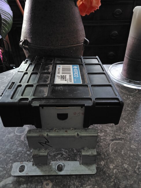

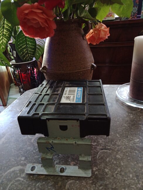

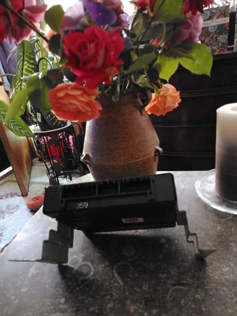

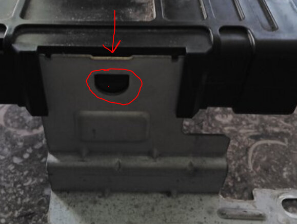

Sent three pics. I can't slide them out, even using a large screwdriver. Do I need to try to find brackets for the replacement unit?
May 27, 2023 at 4:55 PM
I noticed it has been a couple of days since we made contact with you. Have you been able to make any progress?
As far as the brackets, take a thin straight screwdriver and slide it down into where I have an arrow pointing to depress the locking tab I circled. That should release the bracket.
See pic below.
May 29, 2023 at 9:09 PM
