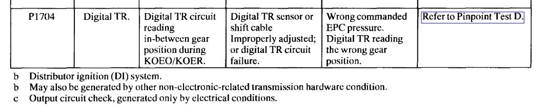

My vehicle was running fine, other than sometimes I had to put it in neutral to start it. Then all at once it shut off as soon as I put it in gear. It will run fine in park and will go in reverse, but that's it. I connected a scan tool as was given a few code: P0705, 0743, C1185, and P1704. I cleared them and only got P1704 after. I've already taken the transmission apart, so I'm unable to get it moved. Is it the transmission control solenoid/pack or could it be something else?
Feb 24, 2020 at 4:30 PM
Good evening,
It will tough to diagnose this with the transmission out and apart. All the testing is done with it in the car and hooked up to a scan tool.
1704 is the transmission range sensor. Nothing to do with your issue.

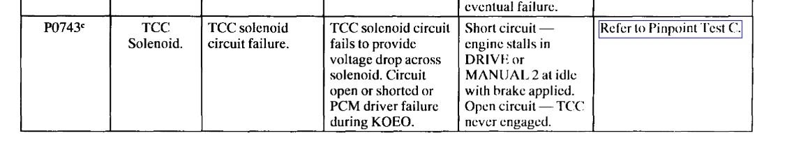

Hey Roy,
I think I was wrong about the last code in my original question. I believe it was the 0743. This is the part they say it is and is the part I took out.
Thank you for your time and help.
Robin
Feb 24, 2020 at 6:30 PM
Okay, this could be the issue but needs to be verified. It could also be the internal wiring harness.
I would still replace the torque converter.

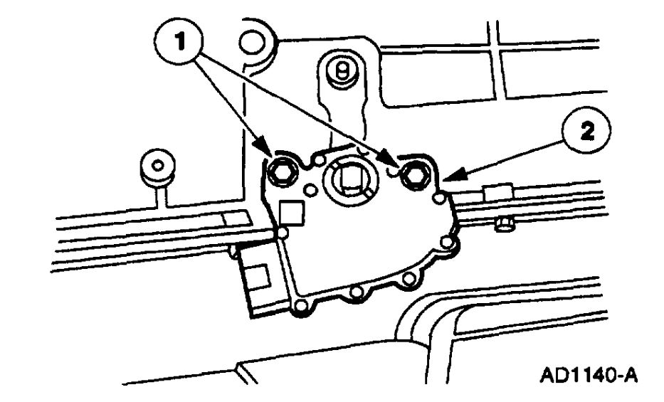

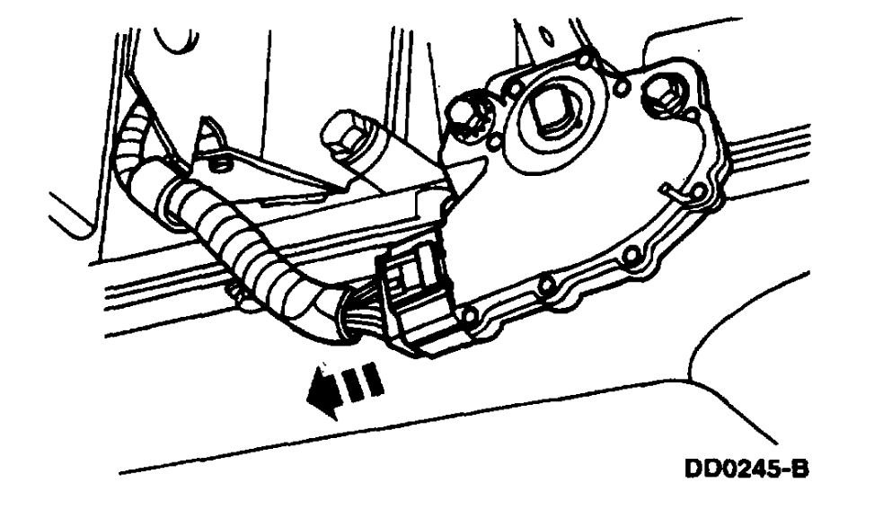

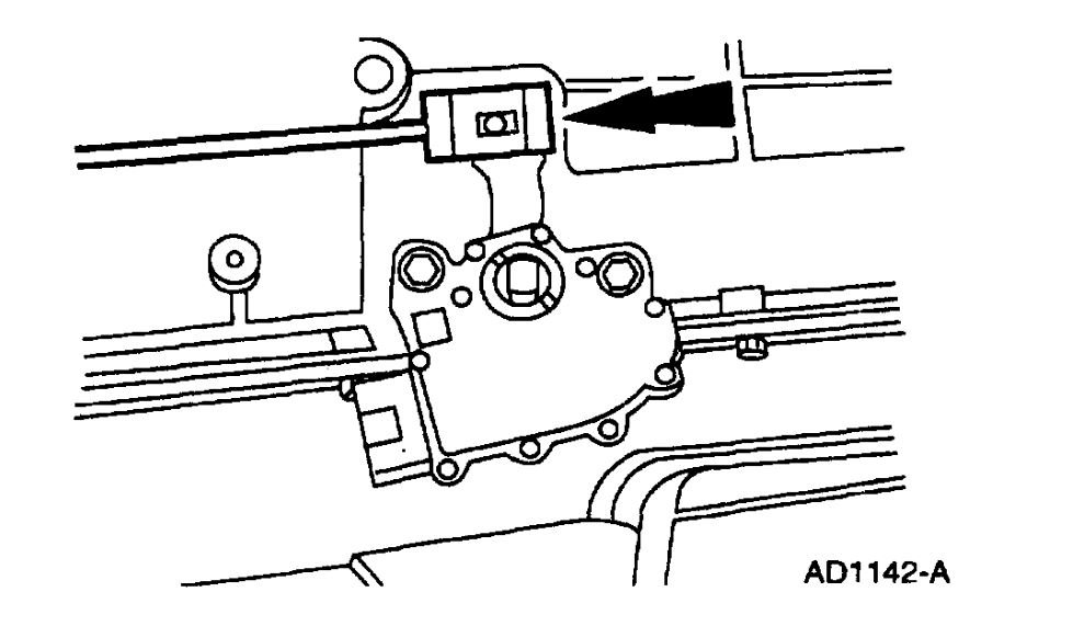

Where is that part located?
Feb 24, 2020 at 6:48 PM
On the side of the transmission by the shift cable.
Pictures attached.

RBUCK08
  • 12 POSTS
I was told this part was replaced a couple years ago. What could make it go out? I hauled some railroad ties about 6 months before it went out and have always wondered if that messed with something.
Robin
Feb 24, 2020 at 7:07 PM
That was 2 years ago and this is now. It wears out. Replace it since the transmission is out.

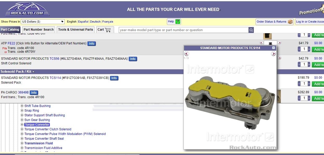

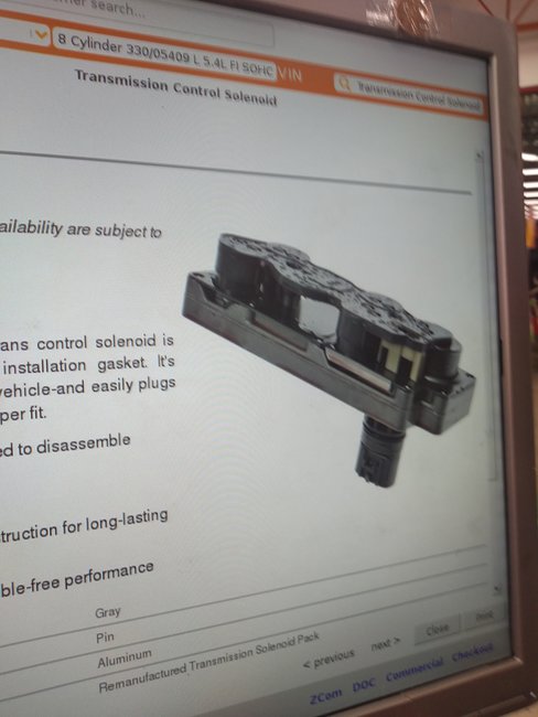

I hadn't responded, I fell asleep, my apologies. I was questioning the part due to it costing $300.00 to replace (plus the estimate 8 quarts of transmission fluid). I was hoping for something cheaper. I've been looking on rockauto.com for the part. I just don't think I'm finding the right one.
Robin
Feb 25, 2020 at 8:55 AM
What part? The solenoid pack or the park/neutral switch?
Feb 25, 2020 at 10:30 AM
RBUCK08
  • 12 POSTS
The solenoid pack.
Robin
Feb 25, 2020 at 10:31 AM
I attached the solenoid pack. But remember, you still need a torque converter.

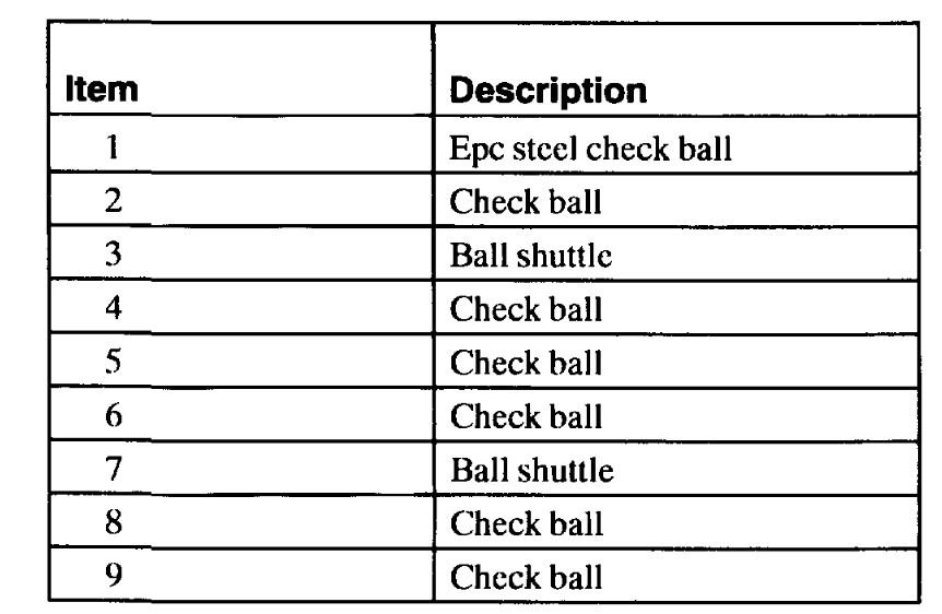

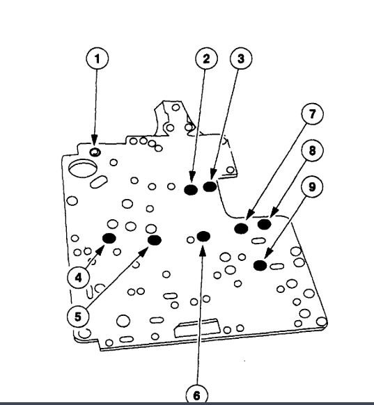

I finally have the new solenoid pack. I was going to install it today, then came across another problem. When removing the old one, I took off the value body causing 4 little balls to fall out. I cannot find anything, anywhere, that says where those go. Can you help?
Thanks in advance,
Robin
May 1, 2020 at 10:01 AM
Okay, I attached a diagram for you with all the check ball locations.
May 1, 2020 at 10:14 AM

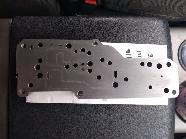

That's bigger than what I have. I've attached a photo of mine.
Robin
May 1, 2020 at 10:25 AM
What transmission do you have?
Is it the 4R100, C6 or the E4OD?
The standard id the 4R.
May 1, 2020 at 10:28 AM
RBUCK08
  • 12 POSTS
I have the 4R100.
I just double checked and that is the diagram for the valve body for the 4R100.
May 1, 2020 at 10:33 AM
RBUCK08
  • 12 POSTS
I may have a different one. Mine is smaller and only has 4 balls. I was told a 5th ball may still be in the transmission. This is the only thing holding me back from getting my truck back on the road and I desperately need it.
Robin
May 1, 2020 at 10:44 AM
That was the only diagram for the transmission in our information system.
I would go on line and go ATSG. That is a company that makes manuals for all transmissions and has great break downs for everything. They also have a tech line for you to call with any questions.
I attached the link for you for the 4R100 manual.
https://www.atsg.us/atsg/catalog/product/view/id/51/s/4r100/category/7/
May 2, 2020 at 4:43 AM
