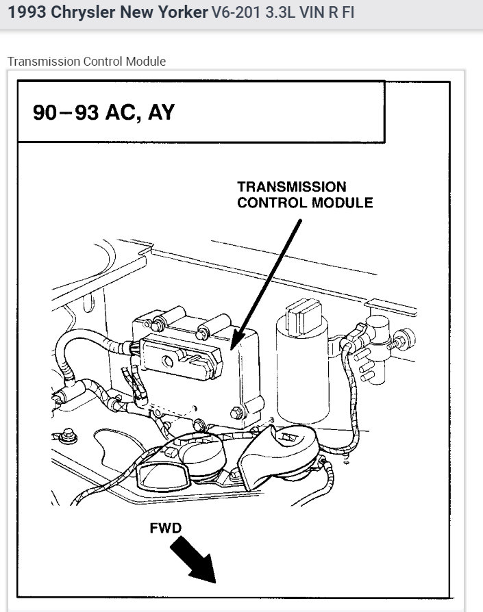

Where is it located?
Aug 27, 2018 at 2:54 PM
CARADIODOC
  • 34,306 POSTS
It is on the right inner fender its right up on top, with three rectangular plugs. It is just a few inches forward of the right hood hinge.
What kind of problem are you trying to solve?
Check out the diagrams (Below). Cheers

About to order the TCM. Is there a picture or diagram or link you could show me the location of the TCM on our car?
Sep 1, 2018 at 9:47 AM
Yes, on the first post (above) in the diagrams below click to enlarge it.
Sep 1, 2018 at 11:01 AM
CARADIODOC
  • 34,306 POSTS
I finally figured out the problem. If you look at that diagram way up at the beginning, it is wrong. It is a mirror image of the correct module location. It shows the receiver/drier for the AC system right in front of the module, but that is on the passenger side, just like where I said the module lives. It is right in front of the passenger side hood hinge, bolted to the inner fender.
Sep 1, 2018 at 10:49 PM
