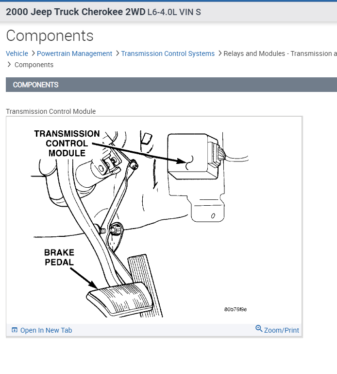

Transmission computer location needed.
Feb 7, 2022 at 6:53 AM
SQM
  • 6,383 POSTS

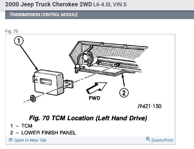

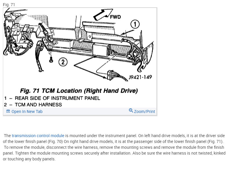

The transmission control module (TCM), is located under the driver side dash, just right of the accelerator pedal.
