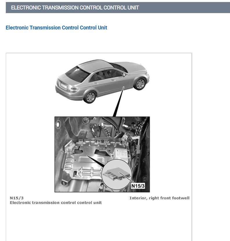

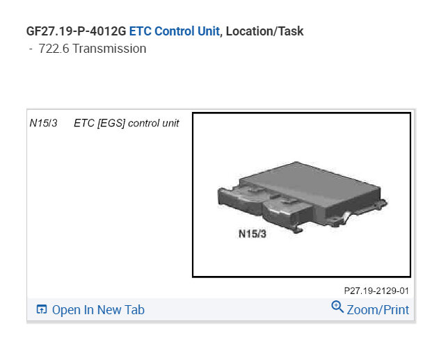

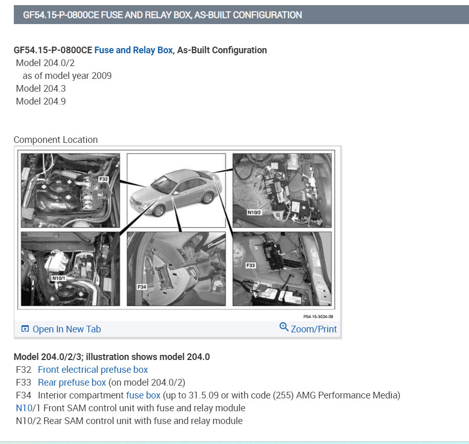

I would check the fuse with the key on here is a guide and fuse location in the images below, and if okay I would dry everything out and then replace the TCM which I have included the location and instructions in the images below as well. Please let me know what happens.

It is in the images in the first post. Under the passengers side carpet.

First image does not show any modules on passenger side or by footwell.
Feb 20, 2023 at 4:27 AM
BHAMDOC1973
  • 2,008 POSTS
I looked there and there is nothing, its empty, usually a class has ton of modules there. Saw a bit of oil in the connector to the transmission, cleaned it and will see if it makes any difference, 4 wires going in. That is all i found, nothing on side of transmission as well.
