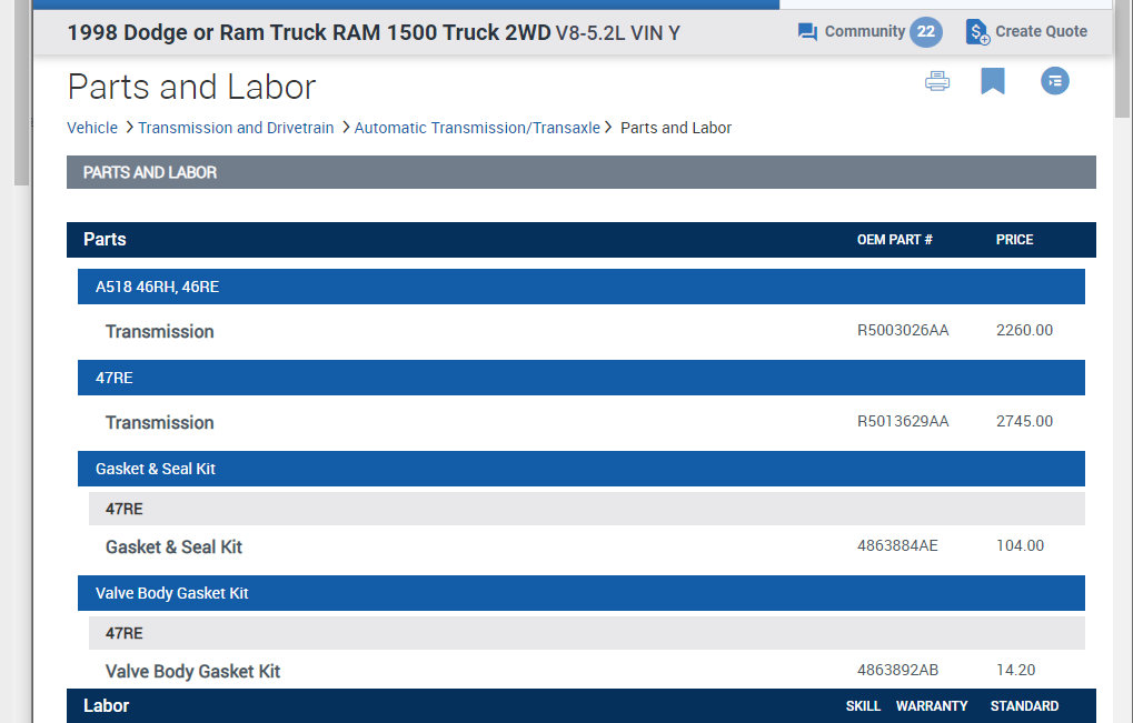

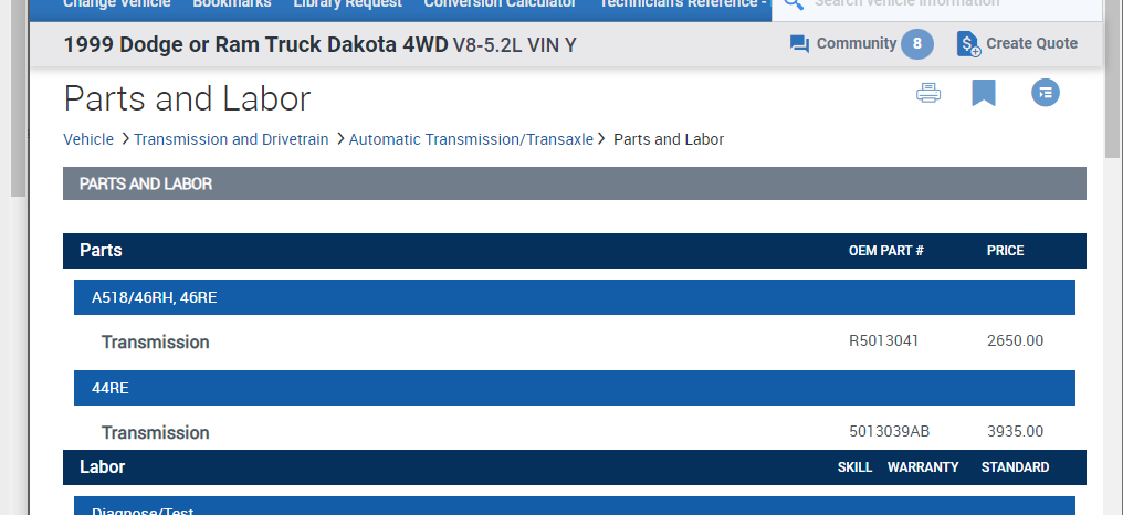

Transmission and transfer case in the vehicle listed above SLT is finished. I have a 1998 Ram 1500 V8 Magnum 2 wheel drive, 3 speed automatic transmission, 5.2 liter engine, that I keep for parts. Has 140,000 miles on it. The Dakota SLT also has a 3 speed automatic transmission. I have no need for the 4wd anymore so it will be 2wd. Will the transmissions and transfer case interchange?

Please see below for the differences in the transmissions. Basically you have a 46 in the Dakota and a 47 in the Ram. You could have the exact same unit so we need to check the VINs and make sure that is the case.
If this is possible, you are going to have to think about a custom cut driveshaft because neither will fit most likely.
