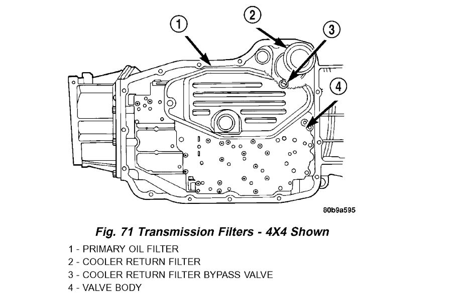

I attached a picture for you of the pan configuration. This is what the vehicle calls for.

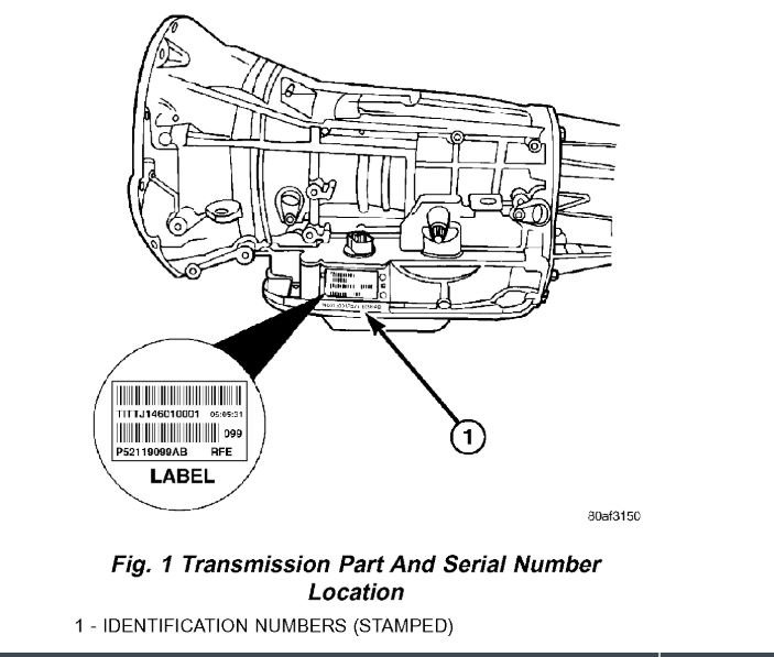

TRANSMISSION IDENTIFICATION - 45RFE
Transmission identification numbers are stamped on the left side of the case just above the oil pan sealing surface (Fig. 1).
Refer to this information when ordering replacement parts. A label is attached to the transmission case above the stamped numbers.
The label gives additional information, which may also be necessary for identification purposes.

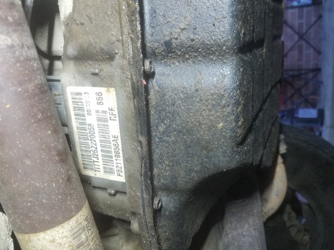

So how can I tell whether the transmission in the vehicle has the shallow pan or not? I'm finding two different filter kits, one for a shallow pan and not. Maybe some of the numbers on the side of the transmission for reference?
Jul 26, 2020 at 4:36 PM
That is the deep pan. The shallow pan is about half as deep.
