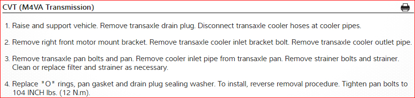

I have the car listed about with a Vetch. I need to change the fluid in the transmission. The only information I can find is that you only must drain and fill. My question is, is there a filter that I need to change also?
