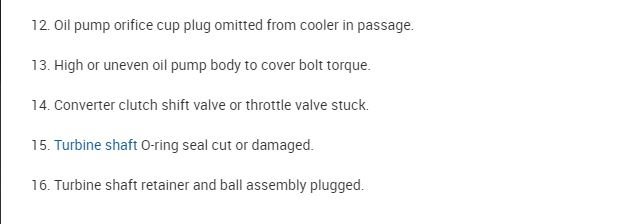

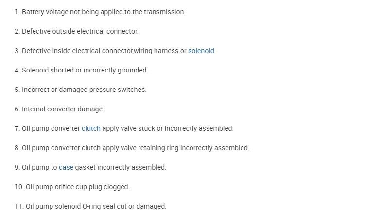

This could be the torque converter itself. There are clutches inside that do wear out.
Are there any codes stored?
I attached a possible issue failure chart below that needs to be checked.
