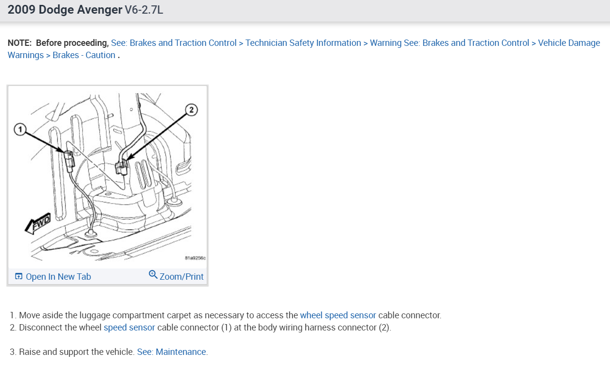

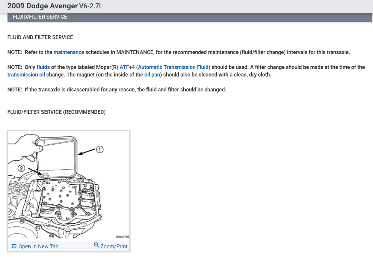

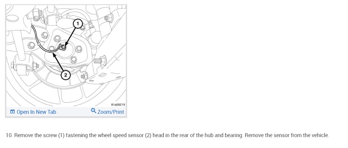

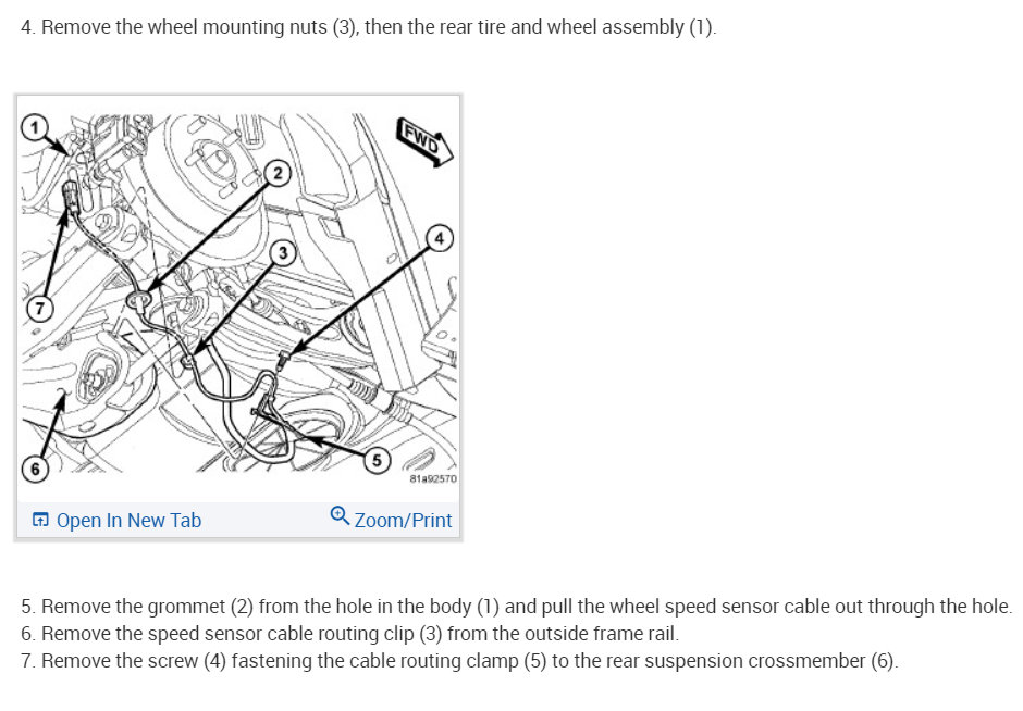

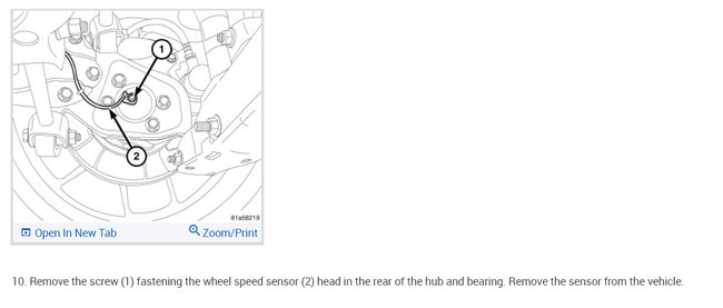

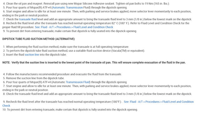

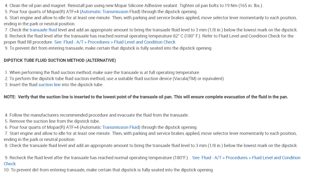

Replaced transmission it whines when accelerating up and down and takes high rpm's to shift. had it scanned and all that came up was rear wheel speed sensor. can that affect transmission?
