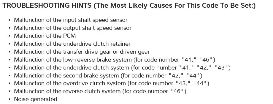

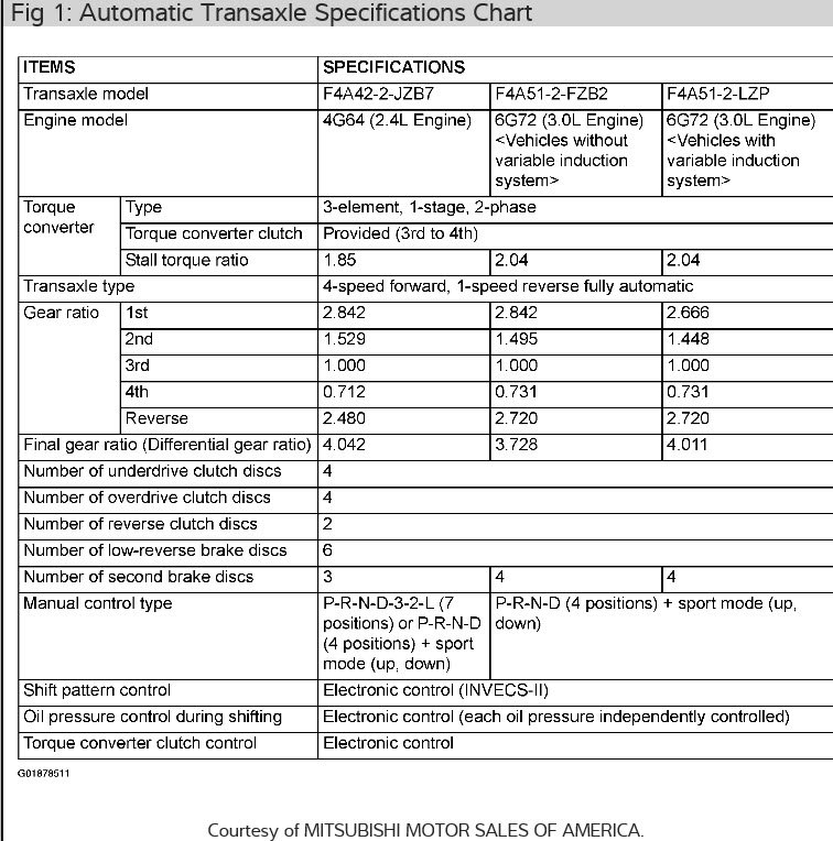

Okay guys, so I have the right transmission now the LPZ. I put it in and got it all hooked up and back together and it does the same thing as my original. But this one throws a code p0734, which is Incorrect fourth gear ratio. I am at a point where I am tired of pulling transmissions. So now I just want to rebuild it and be done with it. My issue is their are three different rebuild kits and I do not know one which one to get. I have no metal in the fluid and it is not discolored. Can anyone help with how in depth this rebuild will be? what all my kit should consist of? I need to know which one I need to order. Thanks guys.
