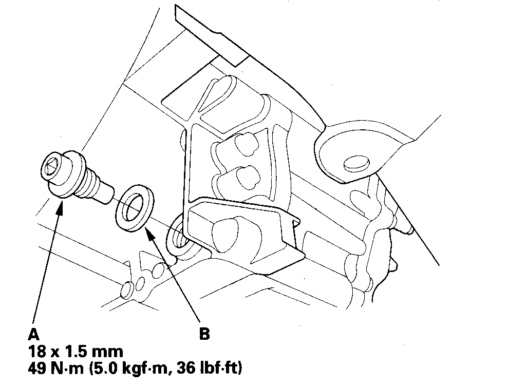

1. Make sure you have the anti-theft code for the radio, then write down the customer's audio presets.
2. Remove the splash shield.
pic 1
3. Remove the drain plug (A), and drain the automatic transmission fluid (ATF). Then reinstall the drain plug with a new sealing washer (B).

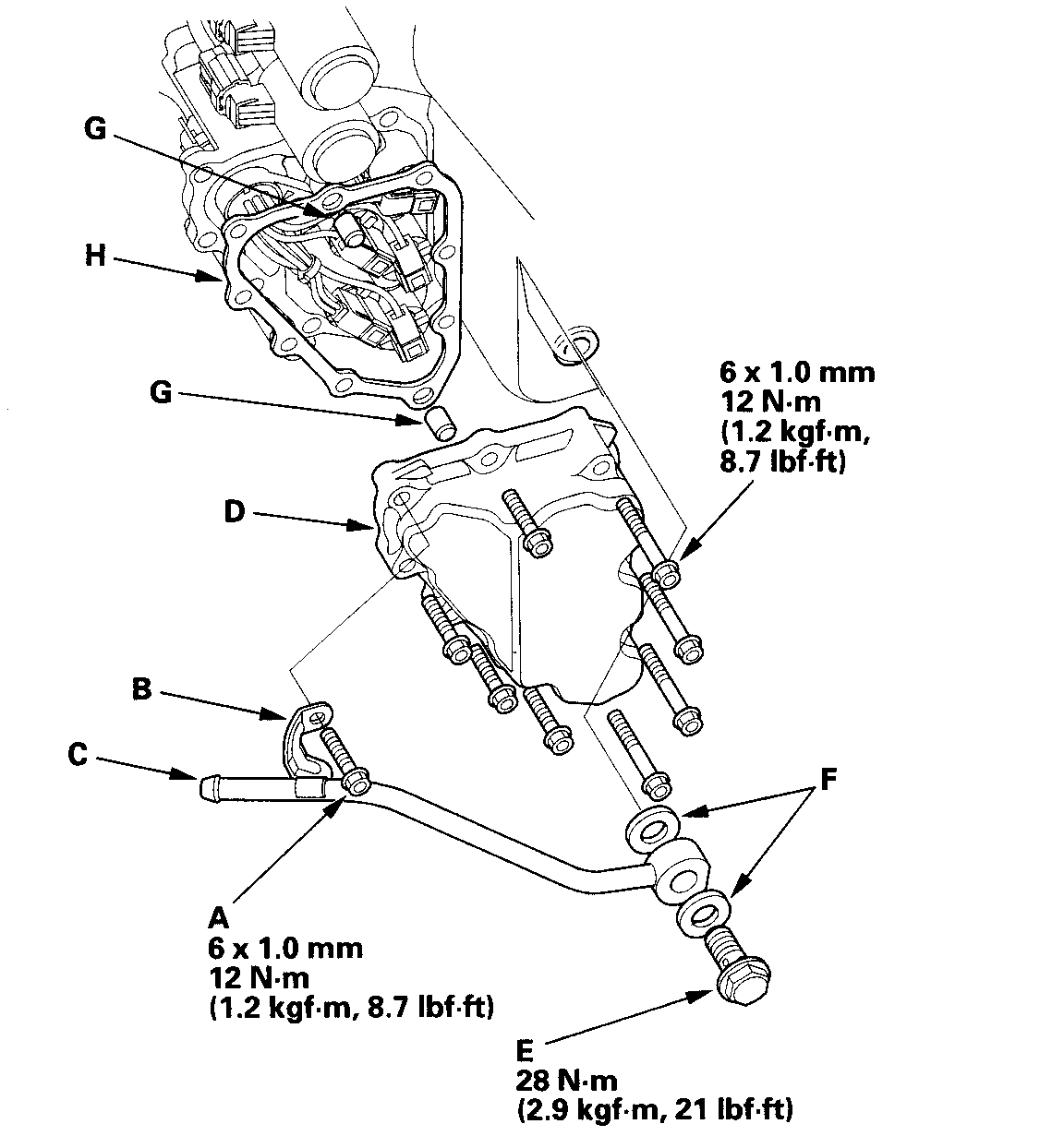

8. Disconnect the shift solenoid harness connector.
pic 2
9. Remove the bolt (A) securing the bracket (B) of the ATF cooler inlet line (C) on the shift solenoid valve cover (D), and remove the line bolt (E) and sealing washers (F).
10. Remove the shift solenoid valve cover, dowel pins (G), and gasket (H).

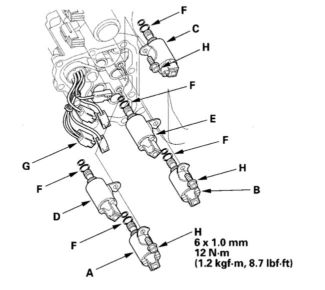

11. Disconnect the shift solenoid valve connectors, remove the solenoid mounting bolts, then hold the solenoid valve body and remove the shift valves. Do not hold the connector to remove the shift solenoid valve.
12. Install the new O-rings (two O-rings per solenoid valve) (F) on the reused solenoid valve.
NOTE: A new solenoid valve comes with new O-rings. If you install a new solenoid valve, use the 0rings provided on it.
13. Install the shift solenoid valves C, D, and E. While holding the shift solenoid valve body, be sure to install the solenoid valves until their mounting brackets contact the servo body.
14. Install the shift solenoid valves A and B. While holding the shift solenoid valve body, be sure to install the solenoid valves until their mounting brackets contact the bracket of the installed solenoid. Install the solenoid mounting bolts (H) and tighten them.
NOTE: Do not install the solenoid valves A and B before installing the shift solenoid valves D and E. If solenoid valves A and B are installed before solenoid valves D and E, it may damage the hydraulic control system.
15. Connect the shift solenoid valve D connector (G) with the ATF temperature sensor.
16. Connect the solenoid valve A connector (BLU wire), solenoid valve B connector (ORN wire), solenoid valve C connector (GRN wire), and solenoid valve E connector (RED wire).
