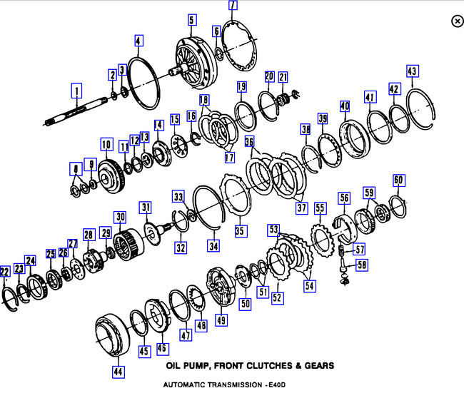

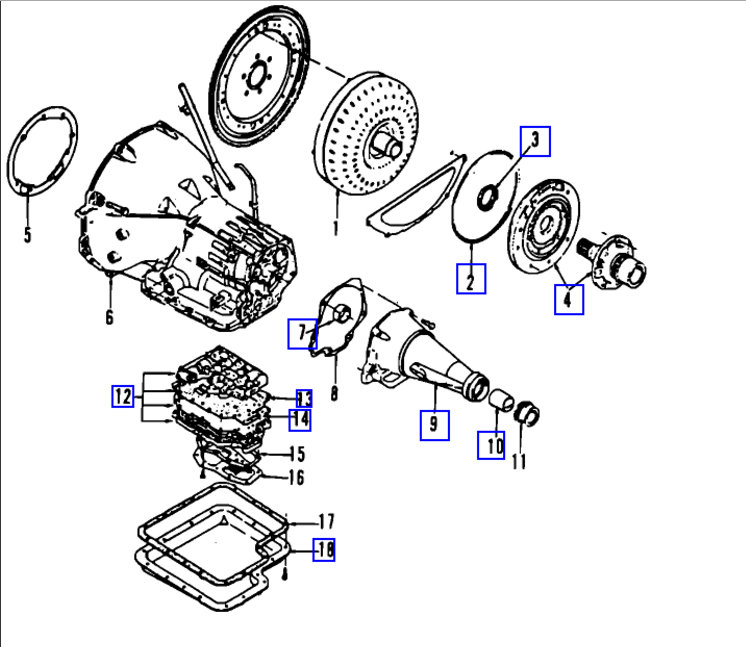

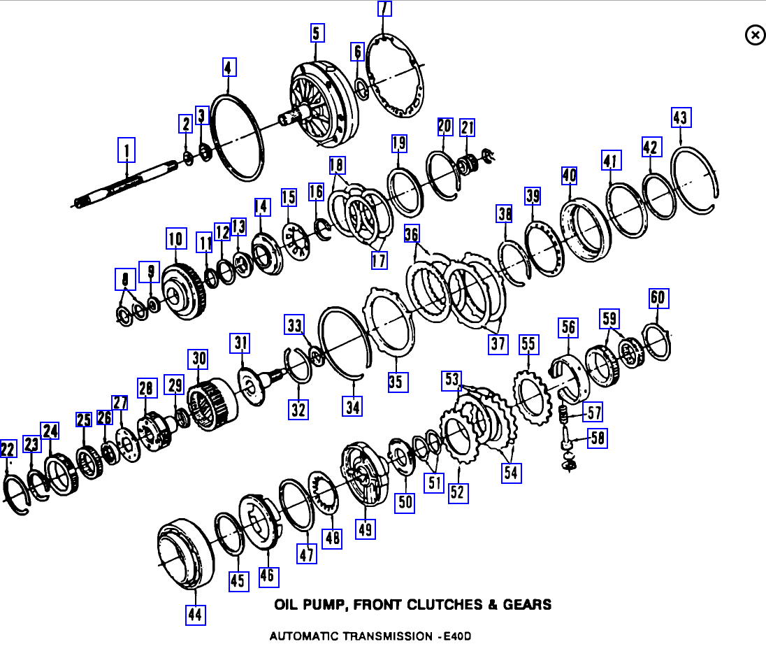

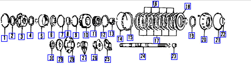

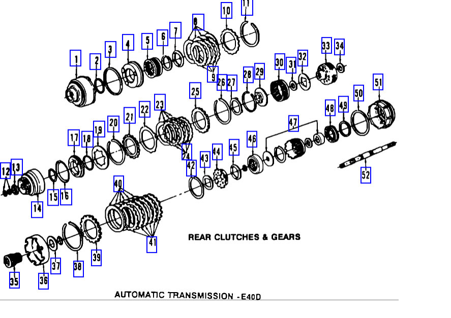

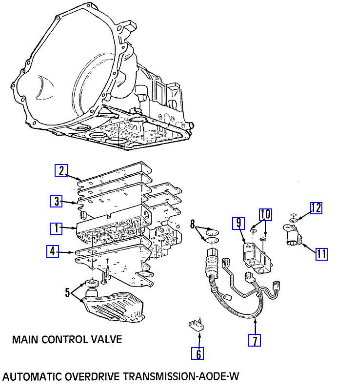

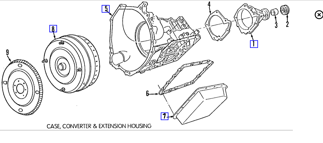

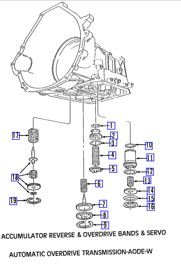

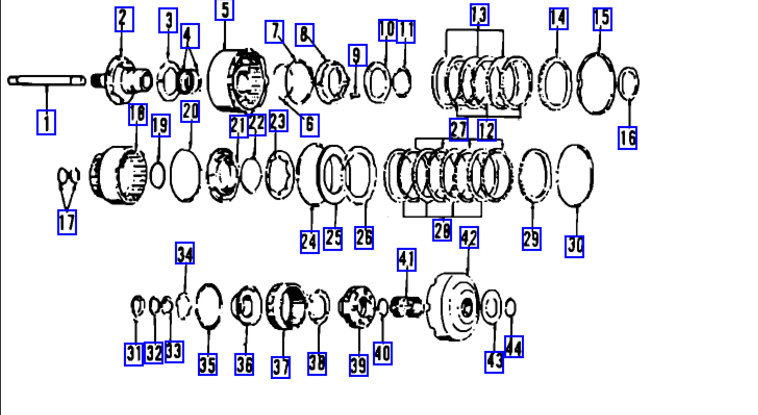

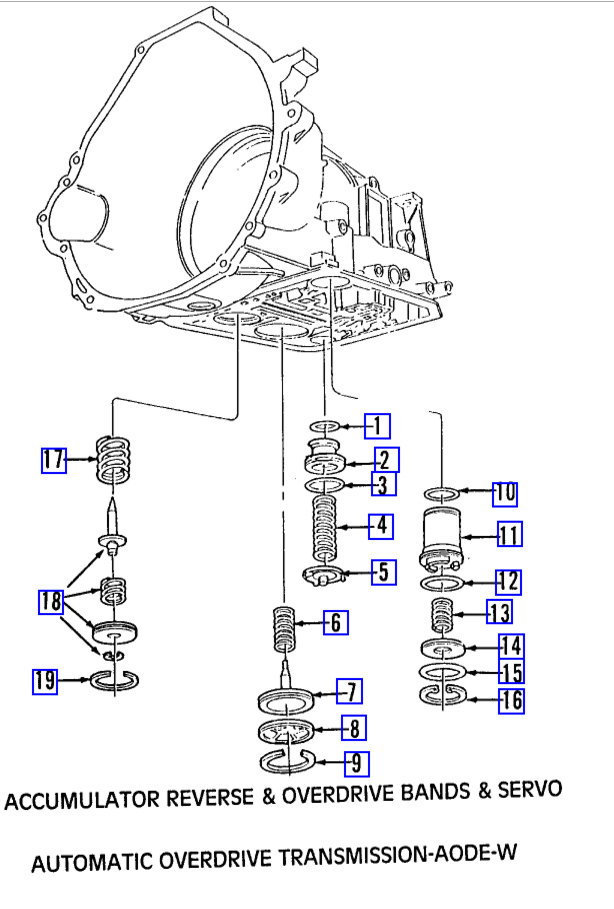

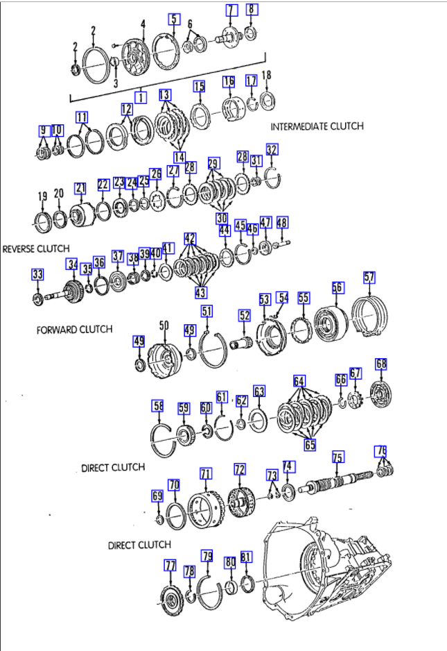

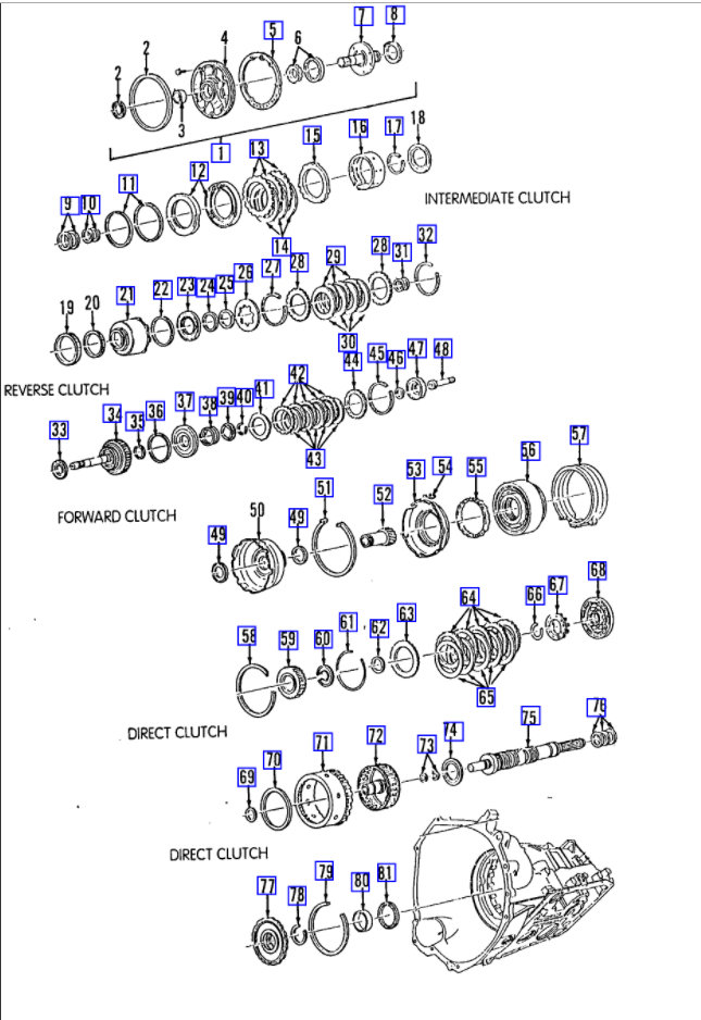

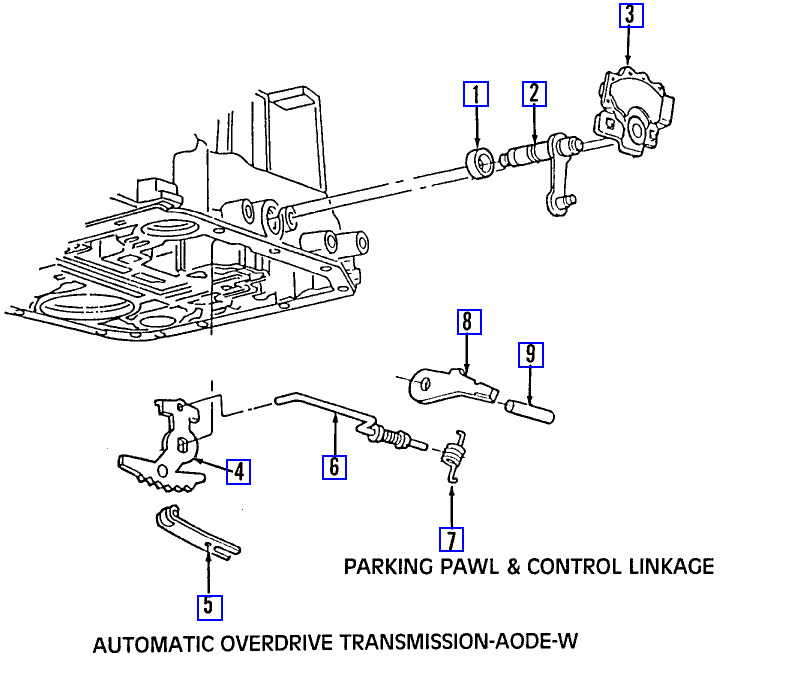

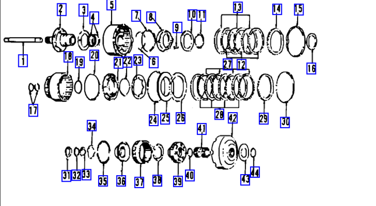

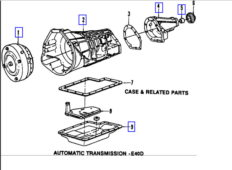

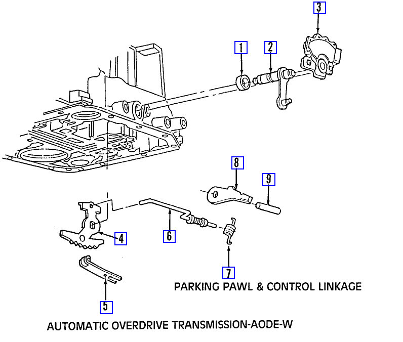

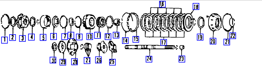

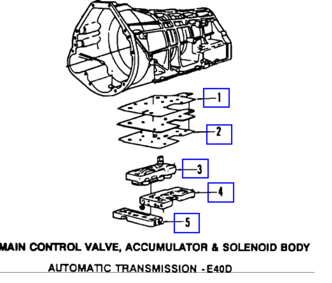

Here are the full set of diagrams to help you fix the problem:
Please let us know what happens so it will help others.
