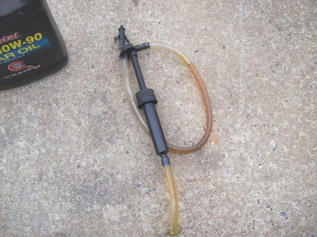

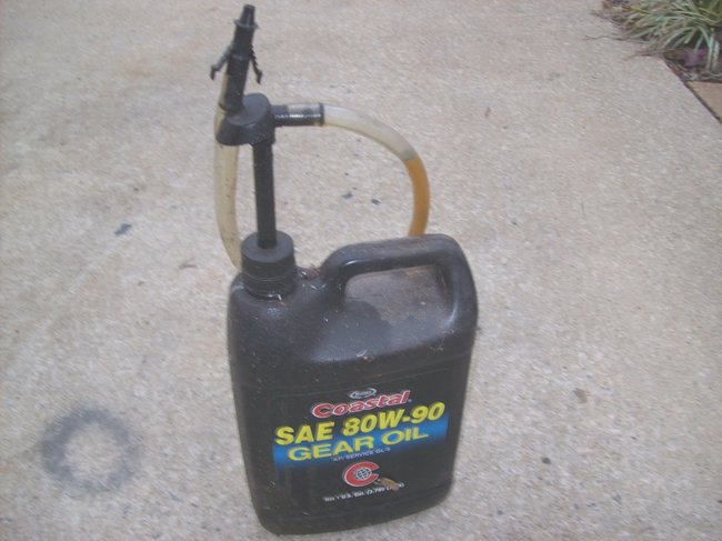

You can get a cheap pump at the auto parts store for about $5.00 to make this easy. I use it on my Jeeps. Pictures below.
