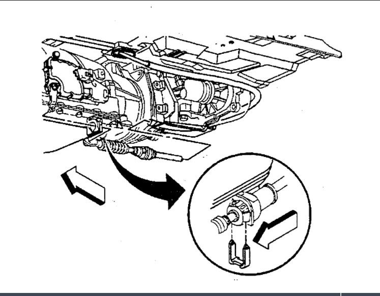

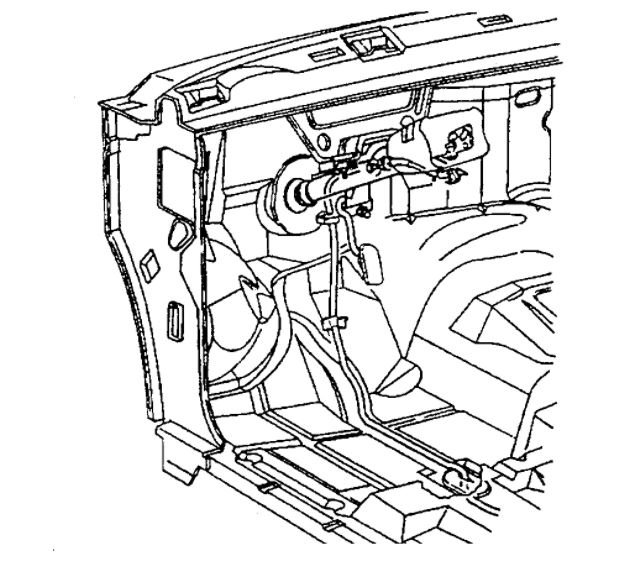

Does the gear shift feel loose? From your description, it sounds like the shift cable has failed.
I attached the procedure for you below with some pictures.
Have someone look under the truck and see if the linkage moves when you try to shift gears. I think the cable is not working.

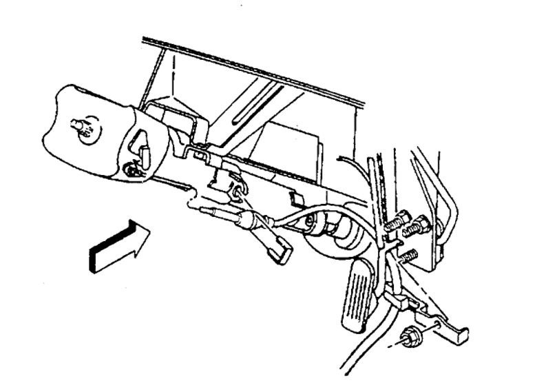

7. Remove the retainer securing the shift cable to the steering column.
Important: The removal of the shift cable from the floor shift control is similar to the removal of the shift cable from the column shift control.
8. Remove the shift cable end from the steering column shift bracket.
9. Remove the nut securing the shift cable and the clip to the pedal bracket.

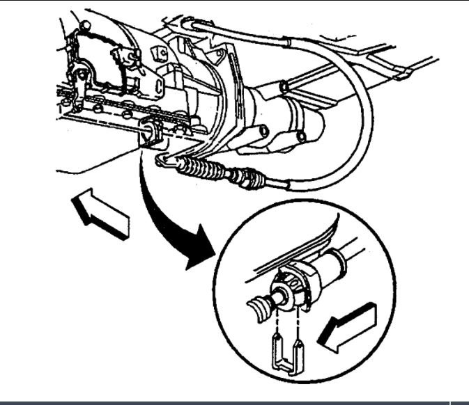

12. Remove the retainer securing the shift cable to the transmission bracket.
13. Squeeze the retainers while pulling the cable towards the rear of the vehicle.
14. Remove the shift cable end from the transmission control lever.
15. Remove the shift cable from the vehicle.

2. Install the retainer securing the shift cable to the transmission bracket.
4. Install the shift cable end to the transmission control lever.
5. Route the shift cable through the floor panel.

8. Install the retainer securing the shift cable to the steering column.
9. Install the shift cable end to the steering column shift bracket.
10. Install the nut securing the shift cable and the clip to the pedal bracket.
